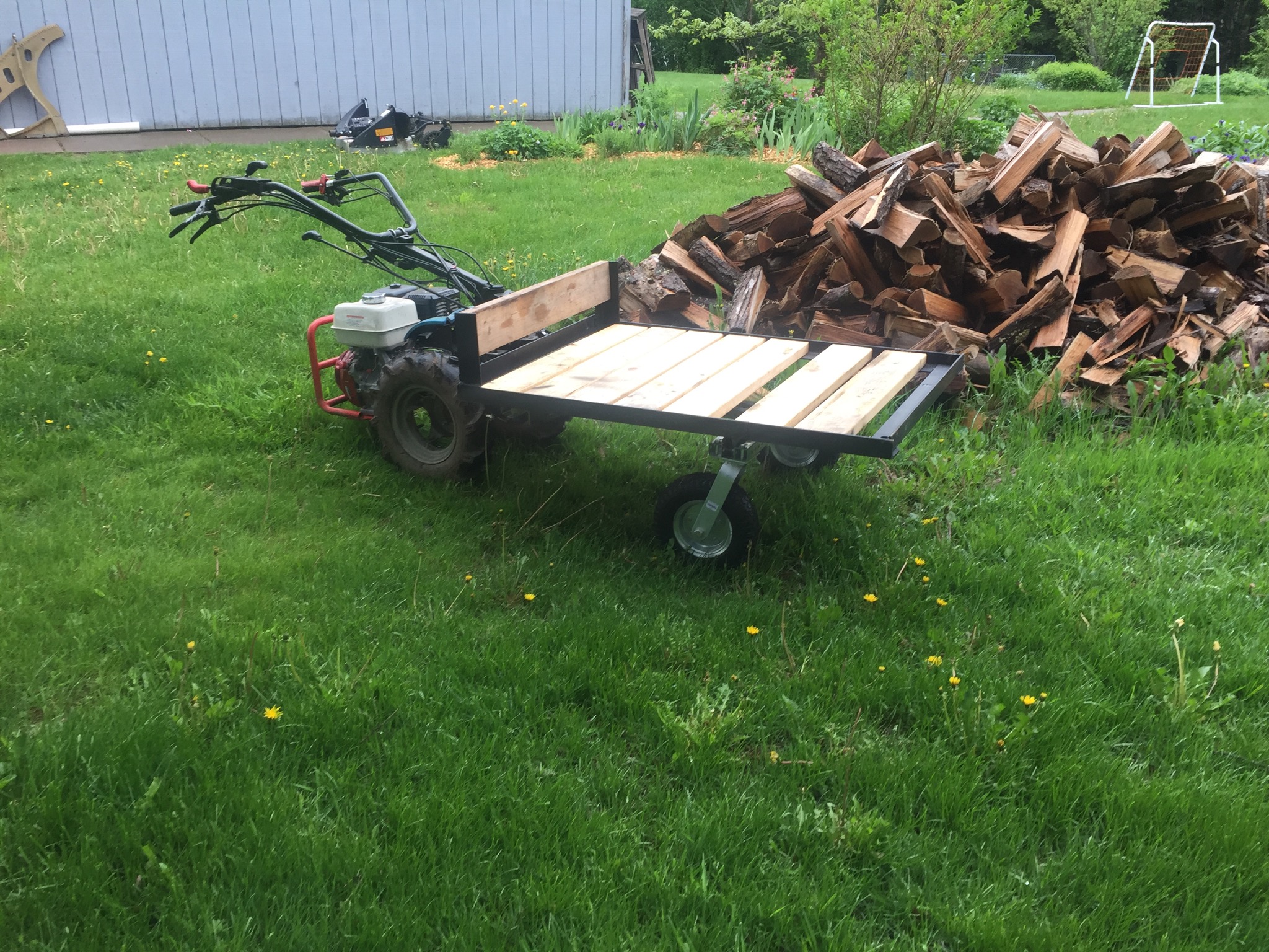

After much thought and scrounging I built my powe barrow/hauler.
With credit to Old Mech, cmyoung and one or two others, mine is alive.
It was easier to purchase an adapter from Earthtools, I tried to machine one from some sch 80 pipe, but ran into an issue with my lathe. Sch 40 was too thin, so a chunk of sch 80 is need for future reference.
So far it works great, I know it has more capacity than the bcs can handle,but I wanted my wife to be able to move two hay bales at once.
Does anyone know what is the max weight cap of the bcs is,don't want to crack my housing?

Very cool, something else for me to copy:laughing: Looks very good for carrying wood and hay bales, I need it for the wood.. My barrow works great for mulch, dirt, rocks. I don't know what the weight limit is, don't think I've come close, even with full loads of rock or gravel. When you look at it, the main weight is probably on the barrow wheels, not the BCS. Only time I would worry about breaking something is traversing a slope and rolling the rig, and even then, after the rollover and everything was "unloaded", just push it back upright and went on. Probably couldn't do that with a regular tractor :rolleyes:

Looks good. Where'd you get the front casters?
   / DIY Power Barrow #10
Two questions. Is it a dump? What are the bed dimensions? And again, I really doubt it has more capacity than the BCS can handle.
   / DIY Power Barrow
#11
The Casters are a pair of 12" No Flat pneumatics from Northern Tool they were on clearance for about $15/EA 450 Lb capacity each.
The bed is 48"x 37" ( I had some 36" 2x6 drops to use for the floor). The frame is made from 2x3-1/2 x 5/16 angle, (overkill but its what i had)
The bed kind of dumps, but not really, it pivots on a section of 1-1/4" pipe that is at the frames 1/3 point. I'll try to get pictures latter today.

Don't know about the weight, but why do you have your tires on backward?
   / DIY Power Barrow #17
Don't know about kmaher, but mine are backwards about half the time cause I don't rotate tires every time I change implements.
   / DIY Power Barrow #18
I only use front mounted implements, and my tires are mounted the same way. That's so I have more traction in reverse, for backing up hills that I mow to the edge of a drop off.
