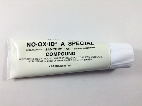

Yes a quality crimp is best thing for repair, just be sure to seal end of crimp to cable insulation with a oxidization preventing compound.... Over the years I have made hundreds of crimps with circumferential dies and all were requires to have oxidation preventing grease and no bare conductors showing between end of terminal and cable... In industry I retired formally all conductors from about 12ga to 750,000CM were crimped....And crimper and dies were regular tested with "go/no gauges" to ensure the quality was there...
