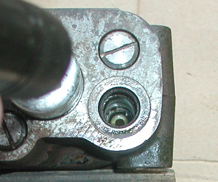

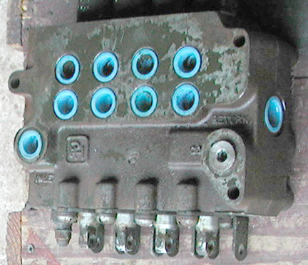

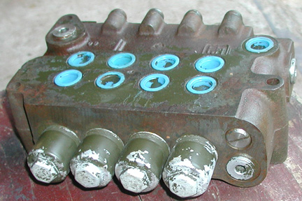

I want to install this 4 spool valve in my tractor. According to the tag, it is a Parker, mod VDP II 000036, P/N 484 536. I tried to get info online, emailed the company for specs, but no response.
This valve, by the obvious OD faded paint is military but it is in excellent condition and actually, looks like it is never been used. I had it on a shelf for 30 years.
I am sure is going to work, but what I like to know, does it look like it has a PB?
There are two ports for inlet and two ports for outlet and one exe plug in the back, which I have no idea what it is.
Can anybody shed some light?

I hate to ask this but what do you exactly mean by OUT ports? Do you mean the pressure ports that send fluid to the cylinders, or the return port. In any case, all the ports look basically the same. There are two inlets and two returns. Why, I don't know. I guess for convenience and they all have hex SAE plugs.
The only one that I question is the one showing below. It is right in line opposite to the relief valve. Looking inside, I don't see how this sleeve is going to provide a PB function. Maybe I don't understand it.

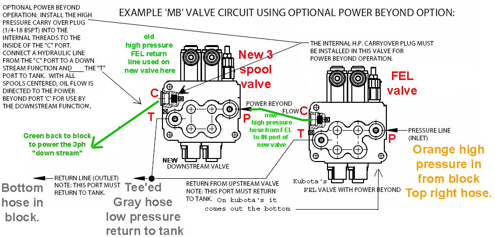

They are all out ports except the IN port/
The main OUT port connects to tank.
The work ports are both IN and OUT ports at different times.
The PB port , if you have one is the port that carries the fluid to another valve.
A PB port is modified to make it a PB port.
The pics are for illustration only.

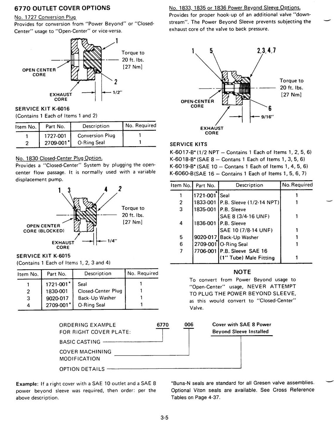

This page for Gresen hyd should explain the differences for the different outlets.
OUT port, used for standard open center hyd valve. Low pressure.
PB port used to pass potential high pressure fluid downstream to another valve.
Closed center plug blocks the flow of fluid from the pump and the pump goes idle until fluid is called for.
