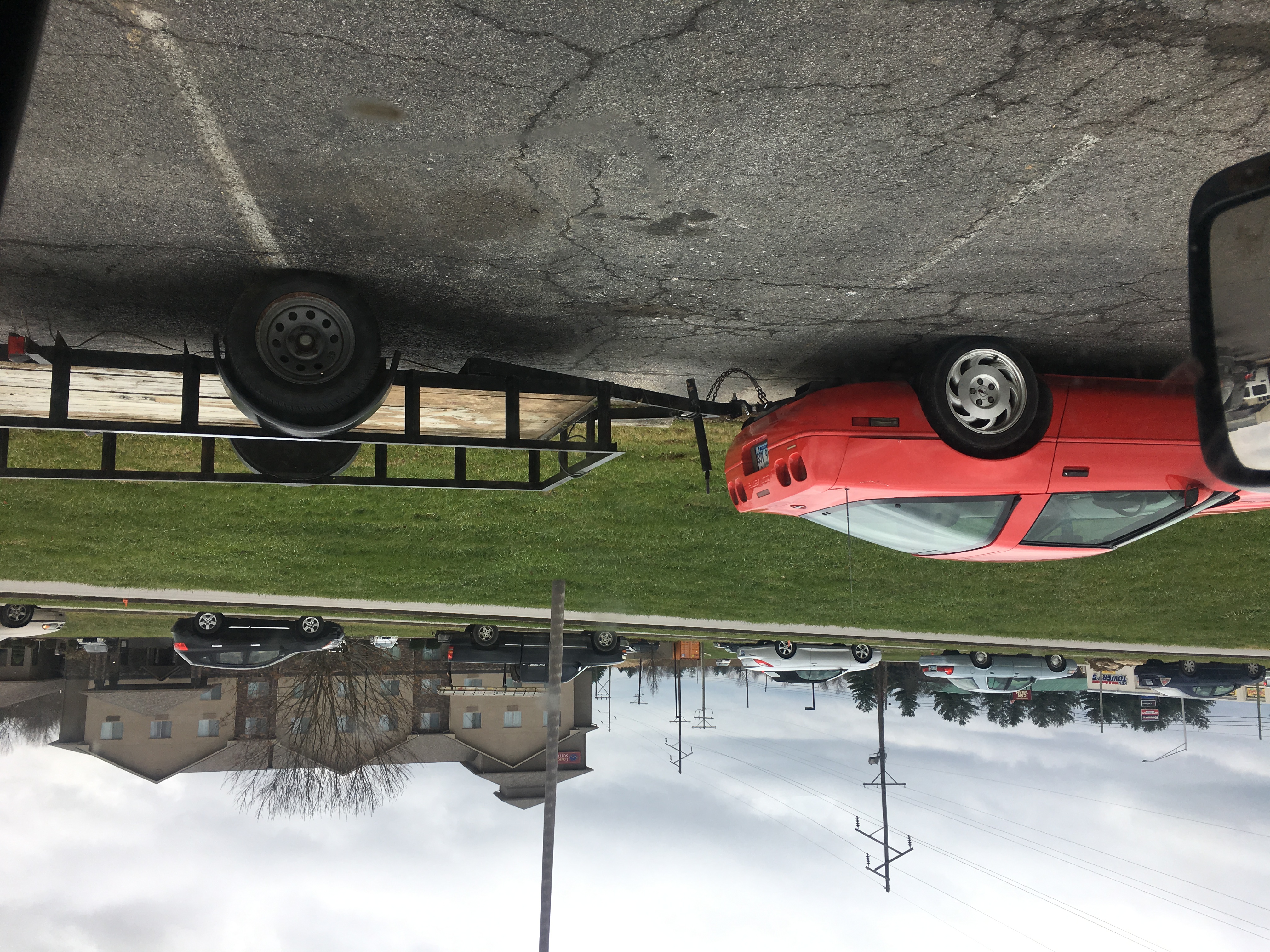

So my driveway is about 3/4 mile long. I hate that it is gravel, albeit well maintained and in great shape. But my poor Camaro... I can hear the ticking of gravel no matter how slow I go due to the drag radial tires. I am considering a new Corvette but I have to do something about this driveway before that bad boy comes home.
Chip and seal? Paving? What do you think I would be looking at for cost? Thoughts?
I would say new driveway first,corvette second.I feel your pain.
