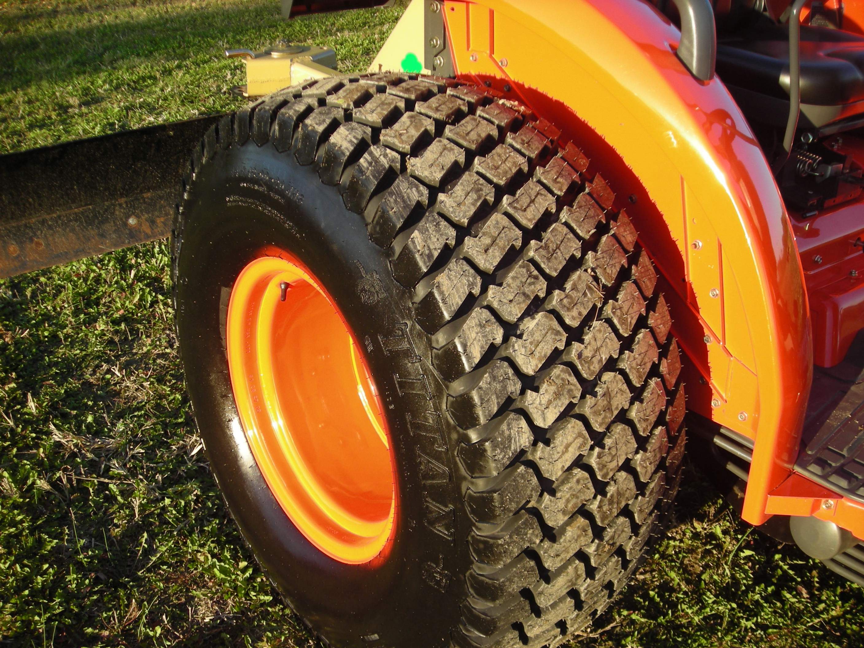

turf tires will get you stuck if its the lest bit wet an muddy
There are several different types of turfs. My turfs look more aggressive than most mud tires on 4WD trucks, and are better in mud than one would think. Here I am pulling an 8000# super stock diesel pulling tractor down a muddy mess. Now in this picture, do I wish I had R1's, yes, but my turfs got the job done. Would I cut my grass with R1's, no. They are great on turf, great in snow, good on dirt, and ok in mud unless it is really sloppy. Philip.
