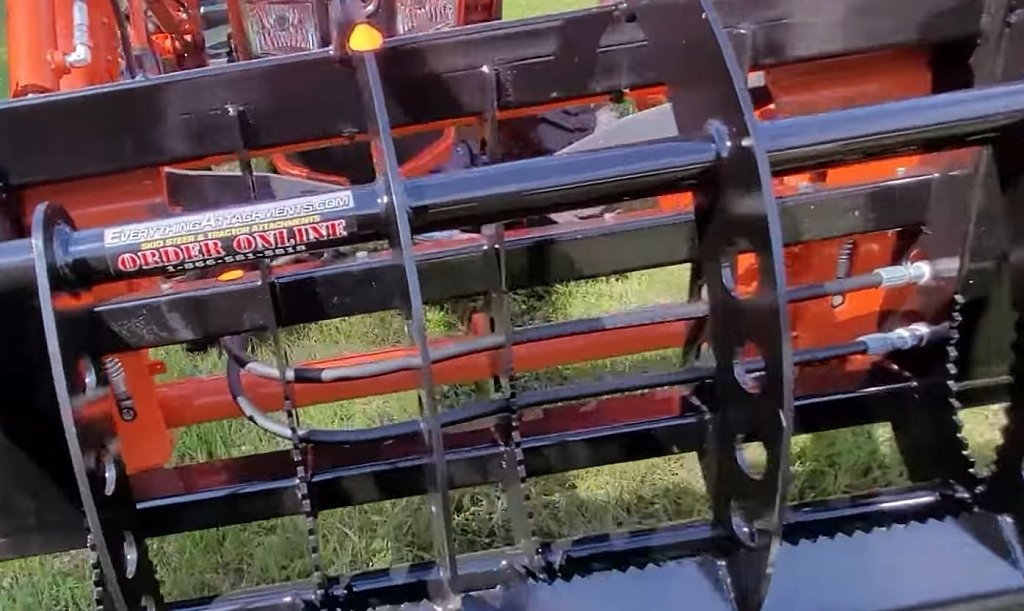

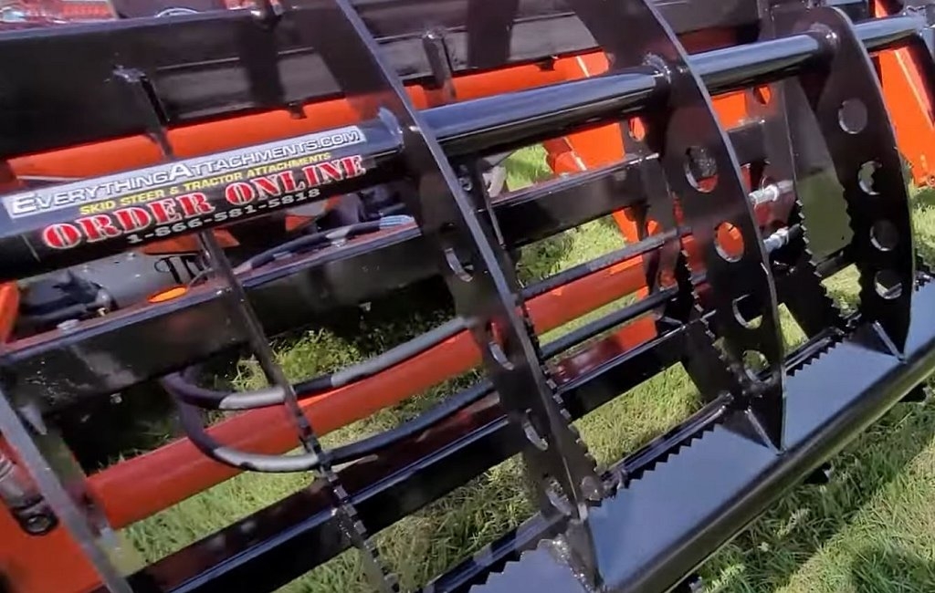

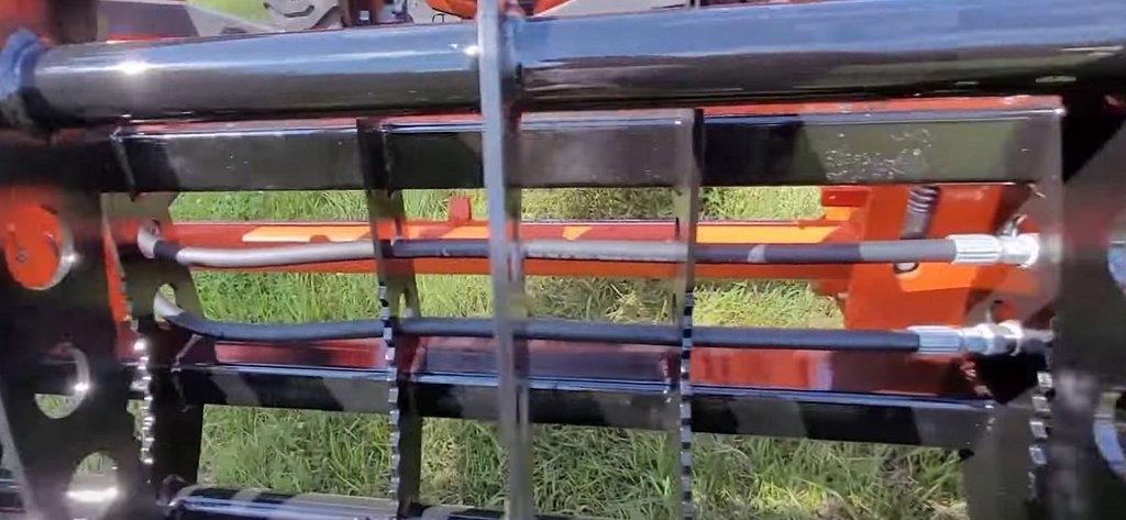

So I have been looking for a grapple for the TYM T474 I just ordered, not sure what type, brand, size, etc, I wanted. Just watching YouTube videos to see what would catch my eye. Well one did catch my eye. The EA Everything Attachments WICKED 55 Root Rake Grapple. The videos I watched showed it as being pretty capable and I was thinking that one was IT. But I just happened to catch a newer video of this product, that was posted just 12 days ago on July 28, 2023 talking about improvements. So of course I felt that would be worth watching to see what those improvements might be that I would likely get on the product I would receive.
Well, I watched it twice. Then again. Something was nagging me. Finally I saw what it was. Right around the 3:30 time mark, I saw that the hydraulic hoses on the bottom tines of the grapple were simply routed through those laser cut holes in the tines and the connection points to the driver's side just out in the open. Maybe I am not seeing this correctly, but it seems to me those hoses and those connection points are exposed to damage by material being grasped by that grapple. All it would take is a stub branch on a log of anything sharp in debris being picked up to puncture, slice, or rip those hoses. Or just shear them in two when caught between debris and the edges of those cut holes. Or perhaps even just knock off the fittings at the exposed ends of those hoses. I took some screen captures of what I am referring to that I will provide below.
I sent a message to Everything Attachments asking about this for clarification, but have not received a response. So I figured I would come here hoping that someone will straighten me out in that perhaps this is a non issue and I am just looking at it wrong. Yeah, I am a kind of Murphy's Law kind of guy, expecting that whatever CAN go wrong, WILL go wrong.

So, as per my original post in this thread, the way those hydraulic lines are threaded through the holes in the lower tines of the grapple are not a potential issue?
It's certainly a potential, but I've never seen any complaints or posts relating to the setup resulting in hose damage. Really though, all these grapples offer the potential to damage the 3rd function hose. I'd imagine over length of ownership that it's inevitable the hose will take damage.
I may be incorrect in my assumptions, and that would be a pleasant surprise.
   / EA Everything Attachments WICKED 55 Root Rake Grapple #10
I have an earlier model 55” wicked grapple and my hoses are not routed that way at all. I definitely can see why you are concerned with this new version. Travis from EA replies often on this forum. Maybe he will see this. @EverythingAttachments

Yeah, that is what concerns me. Past history of this product doesn't matter much. It is this "new and improved" version that I am referring to. Now if I could get an older version, then no problem.

I bought a MTL attachments grapple. Works fine. MTL doesn't route their hoses through holes in the tines like you're asking about. Sticks can go anywhere.
