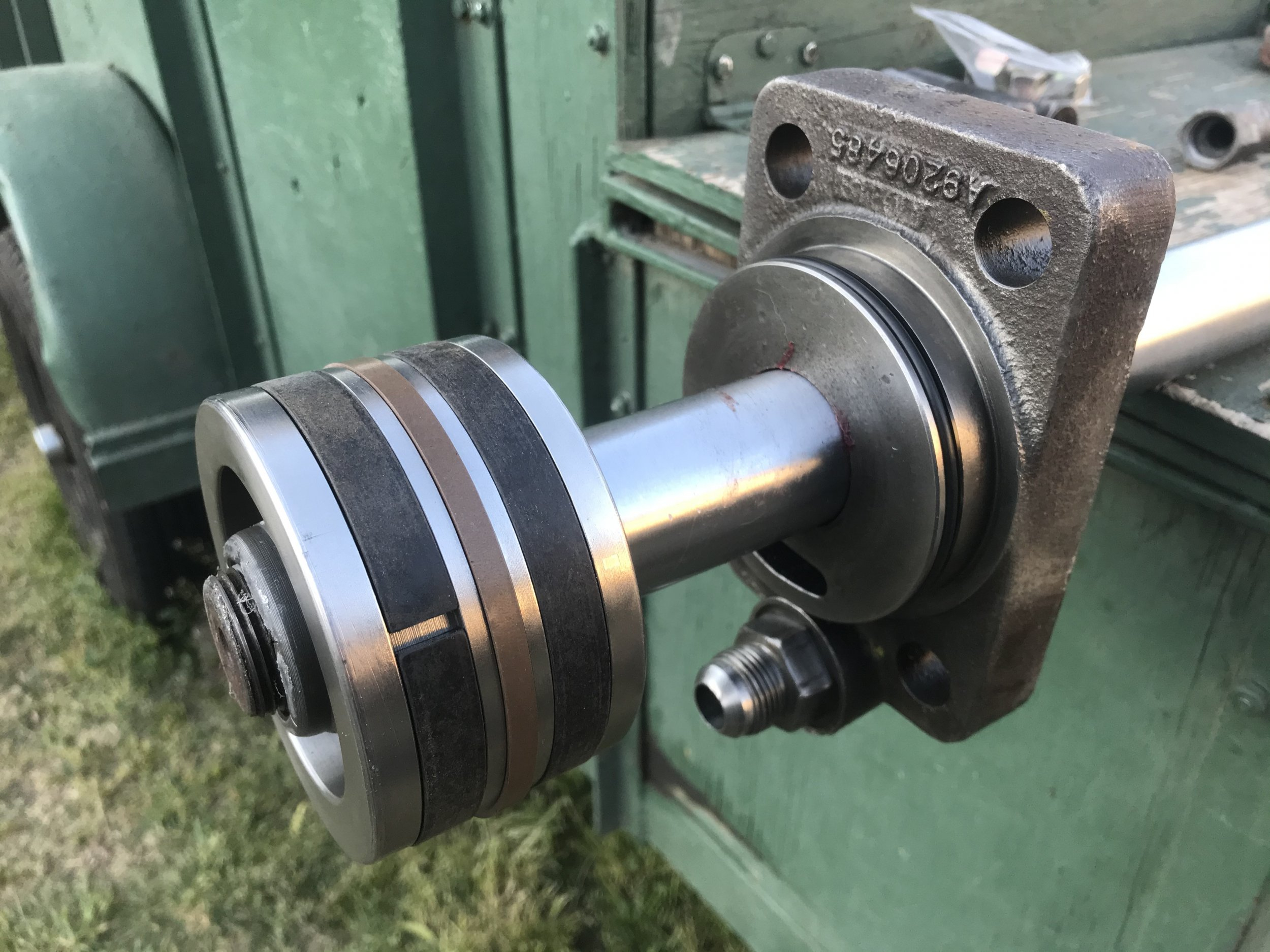

#551

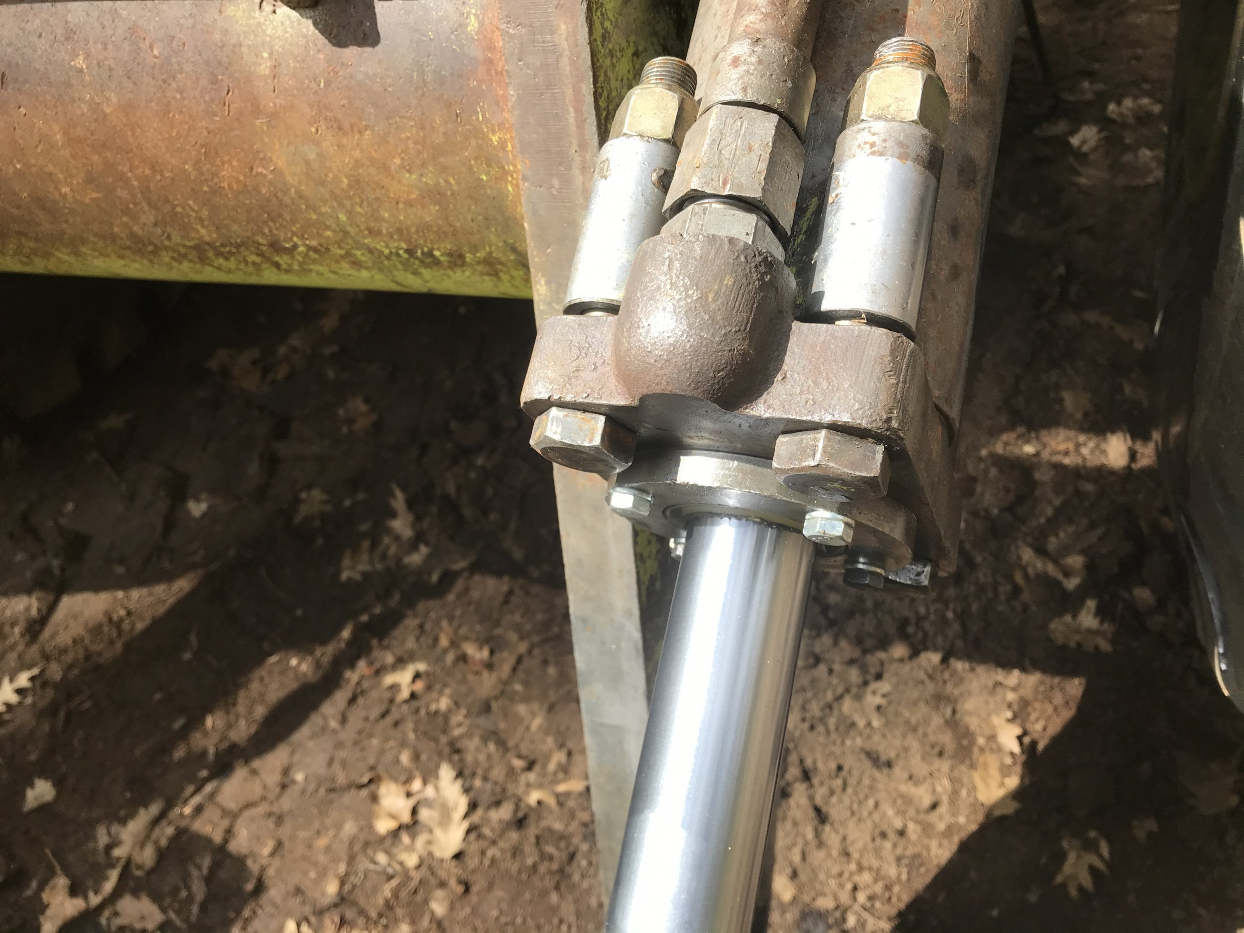

I was thinking backup rings are radiused on one side, flat on the other. Mine look flat on both sides. I did some research and found they could be either way.
   / Ed's 77 Terex 72-41 Wheel Loader

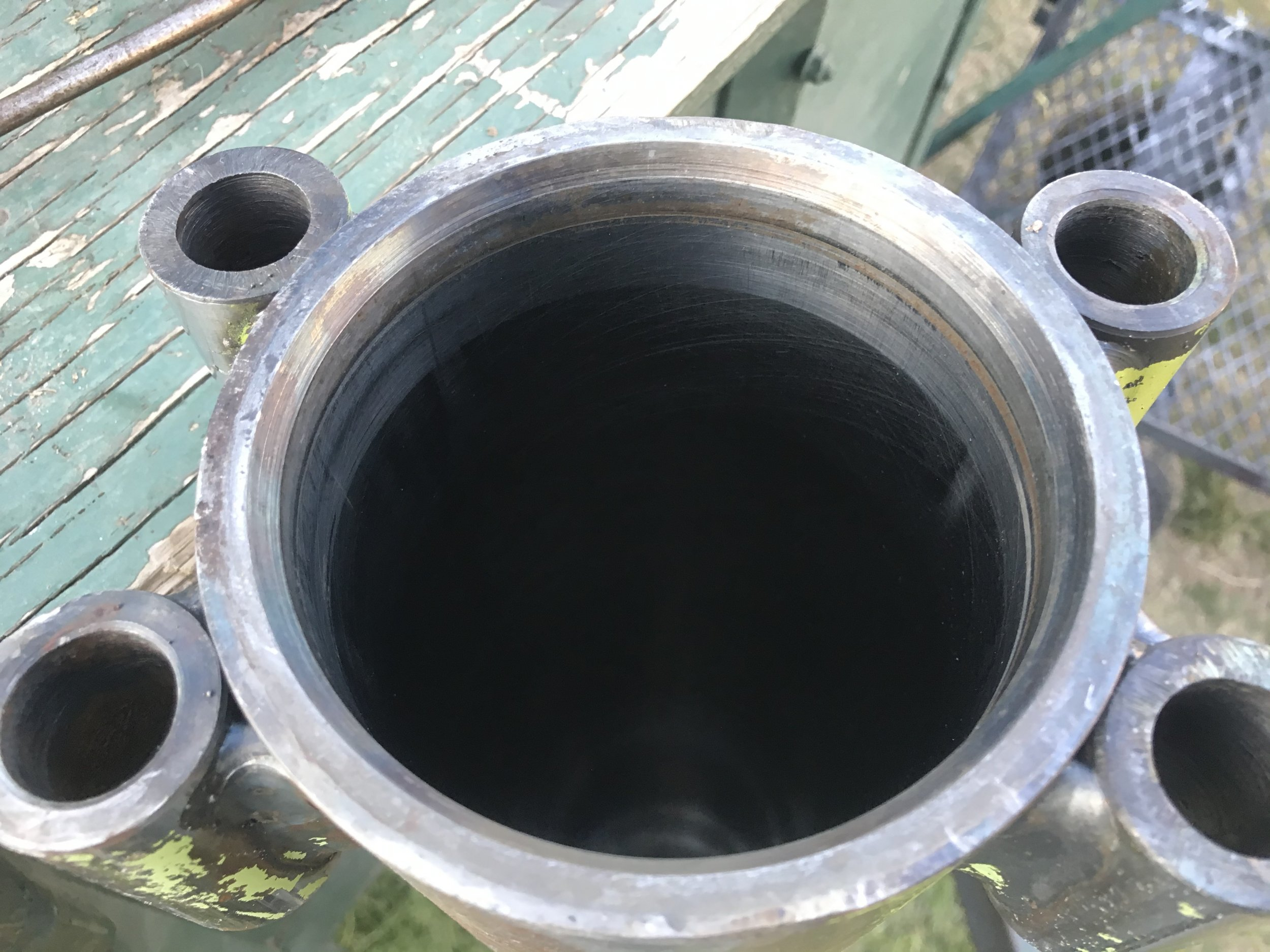

#552
My back had been out of wack, that’s why there’s been no progress. I felt up to trying it today, it wouldn’t go together. The piston seal kept hanging up, I’m hoping this’ll compress it back to the size it’s supposed to be. I have aluminum from a beverage can between seal and hose clamp, so the seal won’t be damaged.
#553
The cleaned up parts ready to go back together.

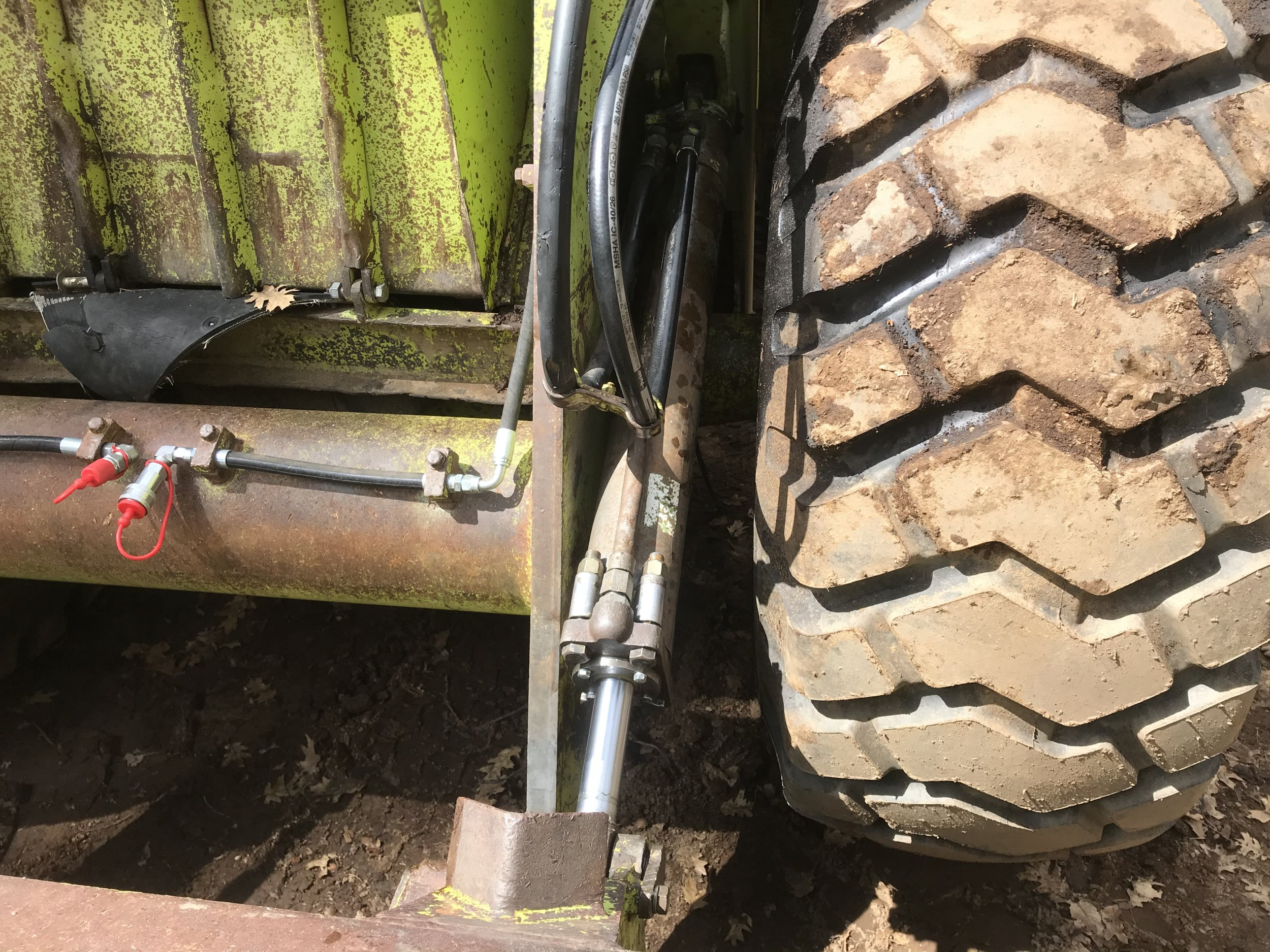

#554
Cylinder is back on and not leaking, I couldn’t use it though. I didn’t bring enough hydraulic fluid, the steer tank is too low. I’ll put it to use next time.

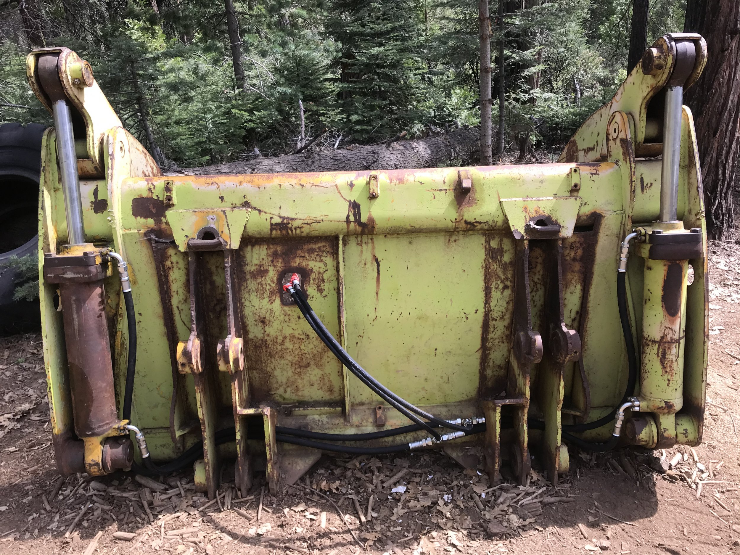

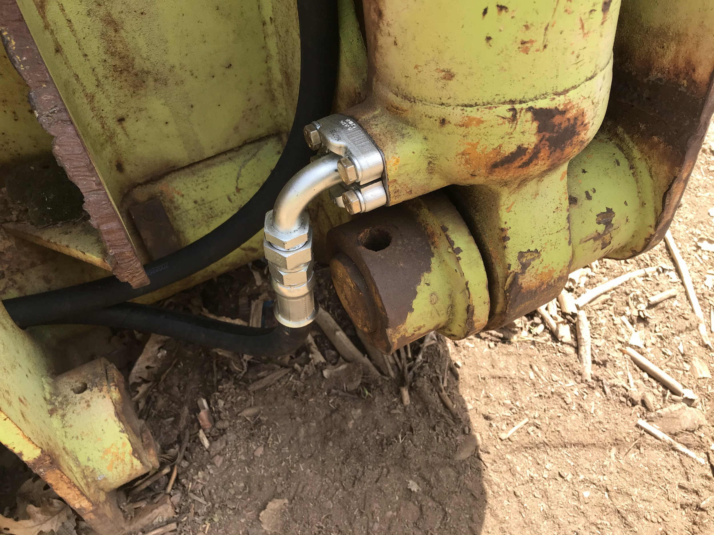

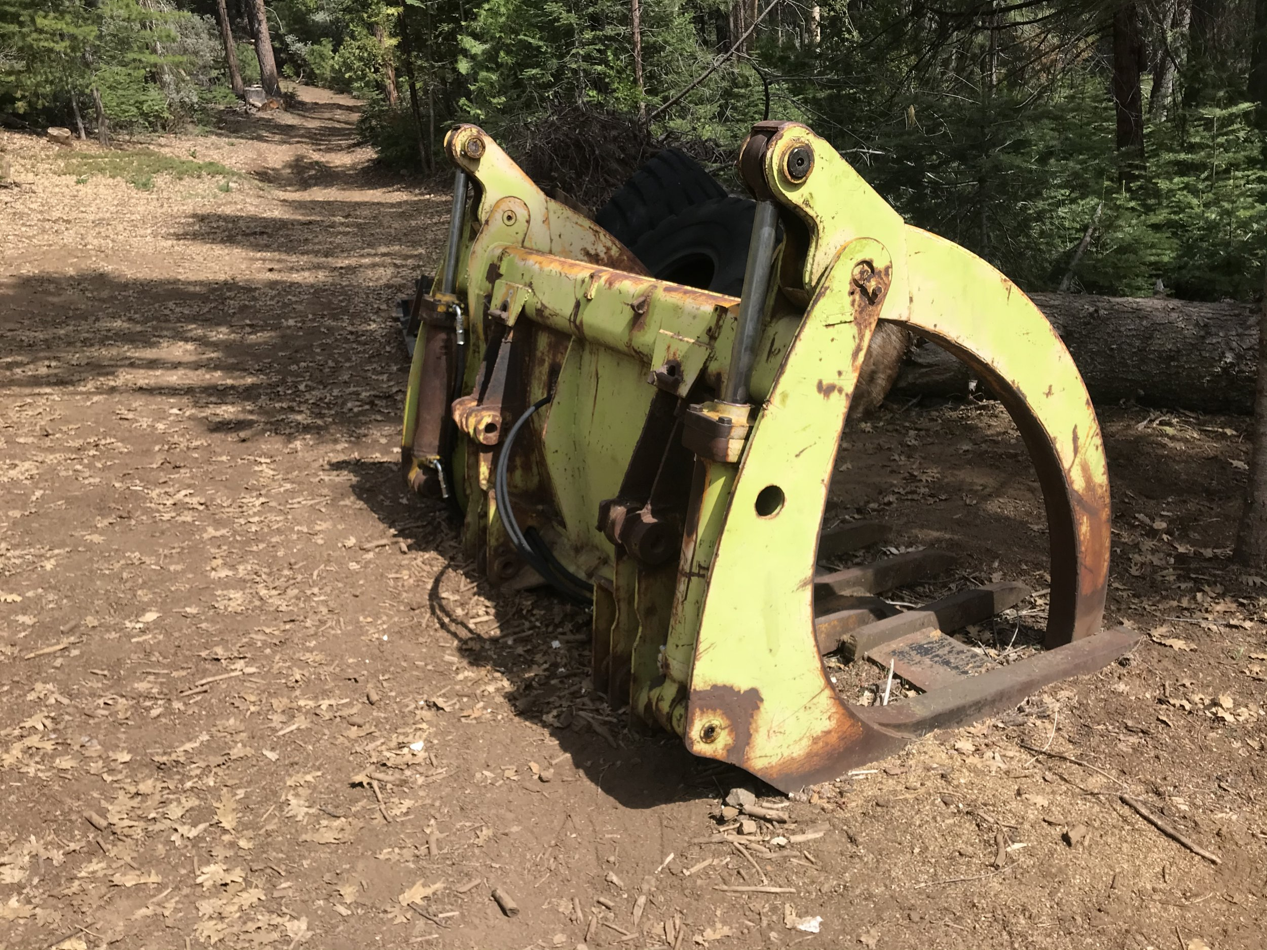

#555
Well, this is about ready to use. We put the one cylinder back together up there, and installed the other one. Then we put on the hoses. Still need to grease the pins, and look at clamping the hoses in place. I remember there being clamps, I’ll look at pictures.
