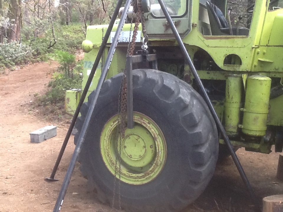

I couldn't take the truck, so no air for impact. But still put it together to see if it'll work, looks like it will.

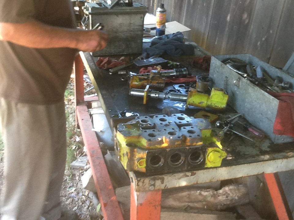

I brought the bucket hydraulic spool valve home to reseal, I have the o rings for it already. I'm waiting seals for steer cylinder and steer manifold assembly/unloader. Some were on back order for a week, so I had them wait until they all show up to ship. The cylinder parts are in stock, but I wouldn't have gained much by having them sent right away.

He did not have me order the seals because he thought they would be o rings, and I ordered all the o rings. So now I need to get six seals and a gasket. He did what he could for now, I was his assistant. There were some obvious leaks, seals and o rings both.
The seals we need are A1054X3, I am only finding it online by national stock number. I will try local tomorrow, if not I will order from Terex.

The spool valve seals were not available locally or online, nonstandard type and size. They arrived from Terex yesterday. The unloading valve seal kit wasn’t in the box a few days earlier. I had to ask what happened, no longer available. But the parts were available individually, and supposed to have been ordered a couple days ago. No confirmation yet.

Both of the hydraulic units (spool valve & steering unloading valve assembly) are resealed and back together now. Probably will be September when I can get back up and install them.
