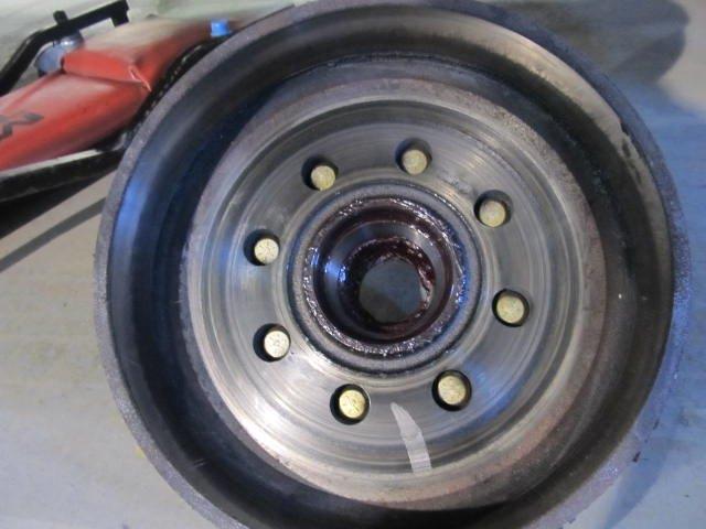

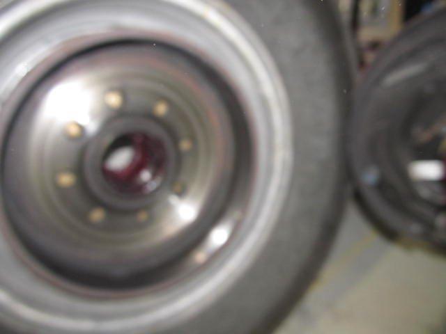

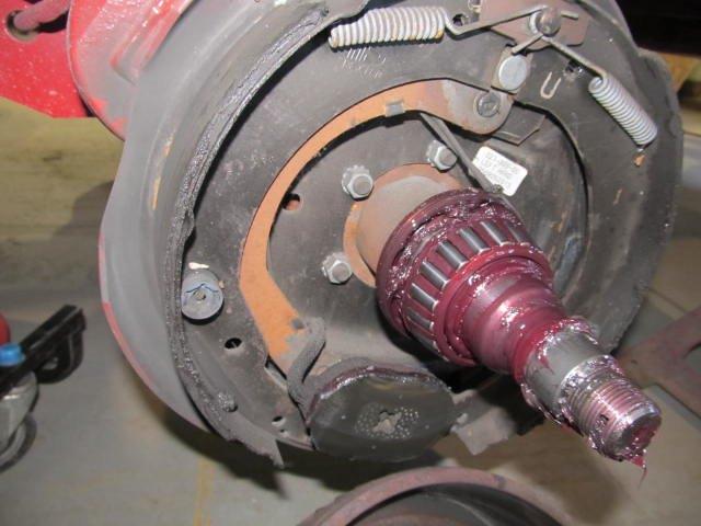

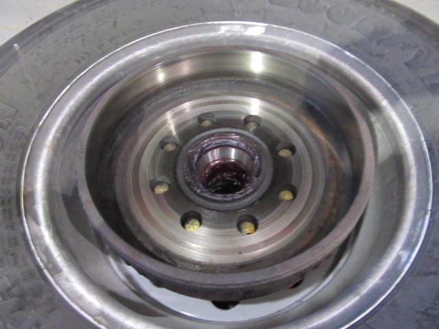

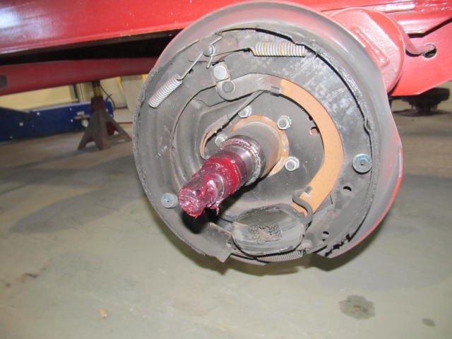

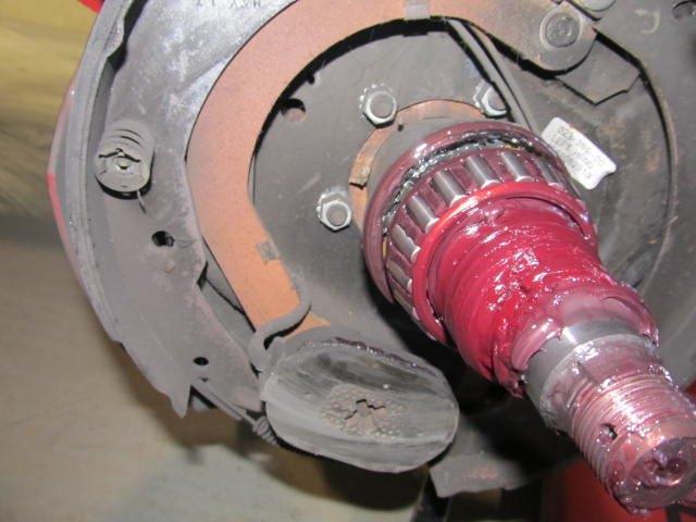

It's a seal issue for sure. Make them replace with quality double lip seals with springs in them.
Chris
   / Electric brakes issues Info need #32
My guess, over greased. Once the grease heats up it'll expand. Since there's only two ways for it to go and one, pushing the dust cap off the front, isn't likely it'll leak by the seal. It's only a guess of course but seeing grease around the threads makes me think it was the cause. It's why bearing buddies have a vent hole. It's to prevent seal failures when the user fills them with grease.
   / Electric brakes issues Info need #33
It looks like you have the grease fitting on the axle tube , thats part of the problem people pump too much grease in to them blowing out the seals . The guy I bught my travel trailer did the same thing . When he sold it to me he said he greased the bearings before every trip . I looked at him and said that the brakes were shot then , I bought the trailer .We had a bet If I was right he would split half the cost . I was right , he kept up his part .
