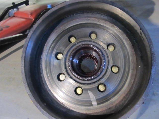

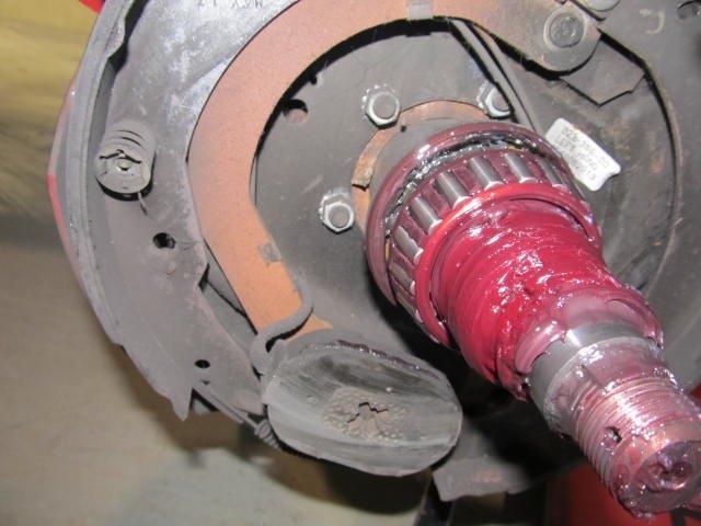

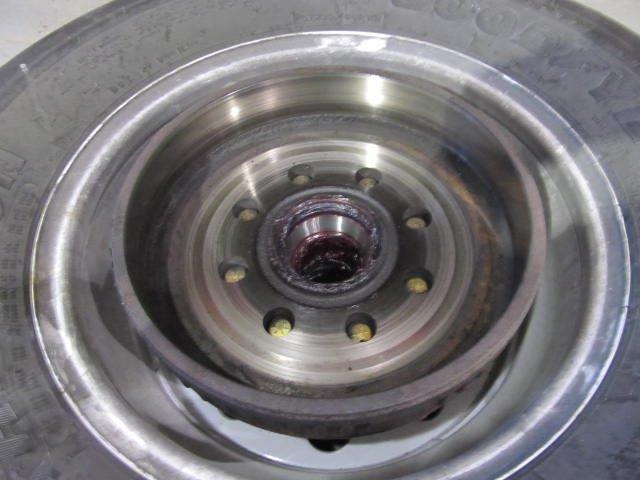

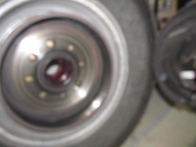

Finally had the trailer breaks checked out. All four are shot and covered in grease. Good news they are getting replaced under warranty. Bad new why did this happen, and will it happen again.View attachment 414092View attachment 414092View attachment 414092View attachment 414093View attachment 414094View attachment 414095View attachment 414096View attachment 414097
Did the spindle caps have grease zerks? You may have stated that, but I didn't pick up on it in reading. Also, do the first four pictures show the left side of the trailer? I know you're done with this trailer, but I am still trying to find a reason for your trailer's problem.
   / Electric brakes issues Info need #71
Assuming that the axle was mounted properly (pivot to the front) they are:
Left (note the inner grease seal inboard of the inner wheel bearing):
Right:

That is why I asked which side is pictured. As Diamondpilot stated earlier, if the brakes are installed wrong, left to right and right to left, they won't work well. If those pictures show the left side, they are correct. If they show the right side, they are not. I know this might seem like beating a dead horse, but there has to be reason for no braking power.

I just spotted something. The activation magnet shows no wear and there is no shinny spot on the inboard face of the drum in Attachment 414092 the magnet in the next attachment, shows wear, but it is not even.
Remember it is the drag on the magnets that puts pressure on the shoes. MY guess they are not getting adequate current to work regardless of what the controller is saying. Just my 02
