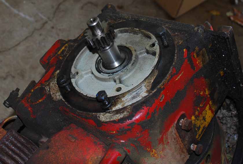

The side grinder Has a slitter or speedy cut blade.
The blade is about 1/32 thick grinding cut off type blade.
Will cut anything Hardened Steel ,Stainless steel.
Just don't get anything in the way you don't want cut.
I didn't get my gears yet.
He was having a problem with the dead end broach.
So he had to order a new one.
Nice photos - they show what you are talking about. Glad to see you wearing all that safety gear - this sets a good example for all others who may see this post. No project is ever worth getting hurt over. Show us a photo of a finished gear when you get them back.

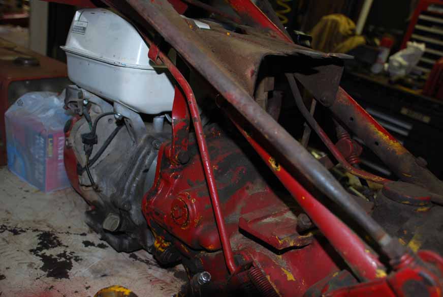

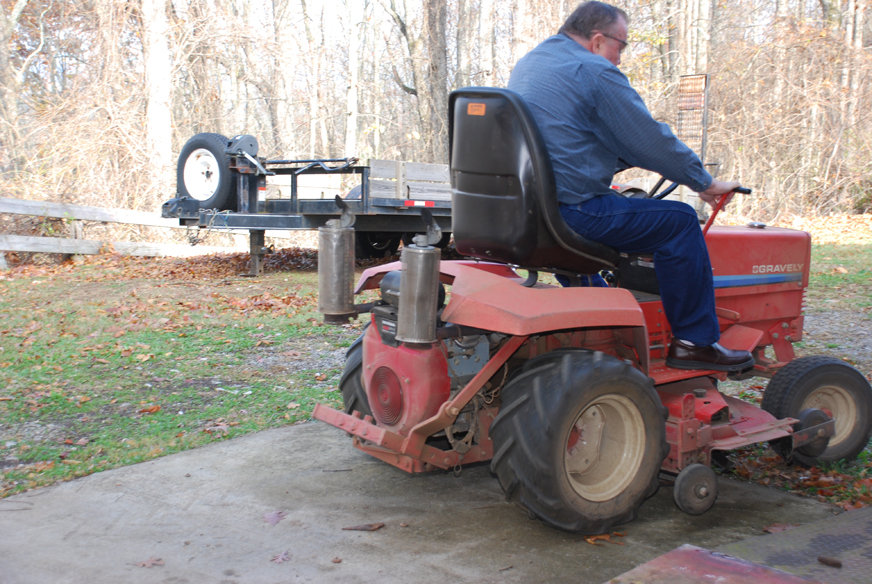

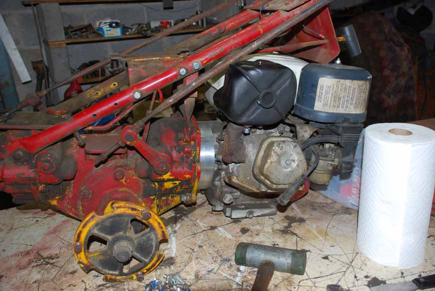

Hi One
Well the C10 is done as for as the conversion to Honda 11 hp
Set the gov at 2700 rpm.
Runs out Good
We didn't clean it up and or paint this one.
He is going to run it a while to see how it checks over a time. :thumbsup:
Thanks Bruce g

   / Engine ideas #287
Nice job, Bruce. By the way, exactly how do you set the governed speed on the Honda or clones? I'm going to have to do this next Spring on mine.
I'd like to wish you and all the contributors to this long running thread a happy Thanksgiving!
   / Engine ideas #288
Happy Thanksgiving One
You need a way reading your Rpm.
There is a screw stop on the throttle lever you pull it wide open
Screw the screw in until you can only run at you rpm you want .
I set this C10 at 2700.
I use a Briggs Whisker They used to sell.
I don't know if they still sell them or not?

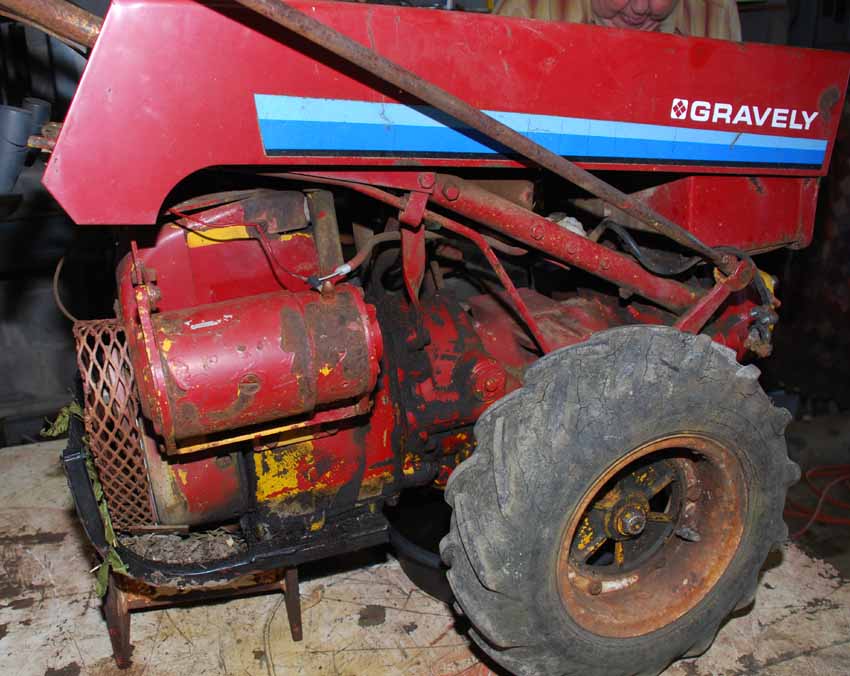

Here is a picture of the C10 with new adapter :thumbsup:
we didn't clean it up.

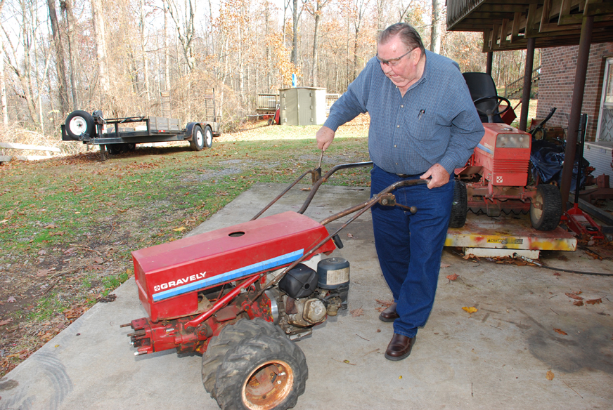

Also here is a pic of my Tractor
from 8123 to 8243 Honda powered

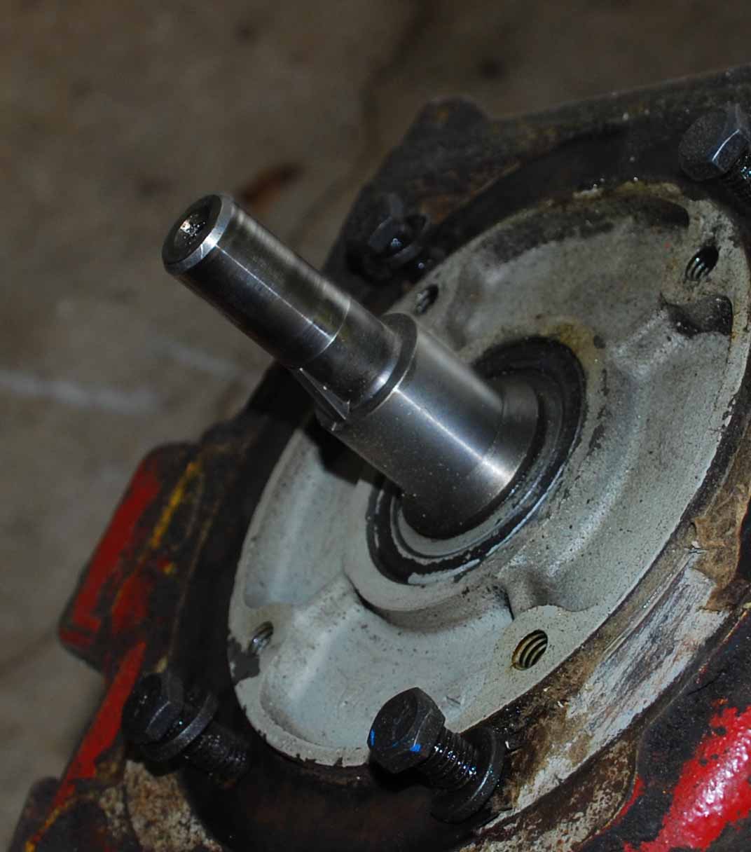

Well got the sun gears today for L ,C8 C10 models
They look good. :thumbsup:
They are high I will have to sell the gear for 150. and the top hat 20.
I had planed to sell them both for 150. but he went up 25.
I have to have a thick adapter plate yet for the L and C8.
The C10 are a different depth into the trans.
The C10 spacer is 1.590 thick I have to use a 2 inch thick material.
The L and C8 are 2.130 so I can't make from a 2 inch thick piece?????
still trying to see what can come up with.
The C10A ,500, 5000 and later are 1.115 Thick
I make those from 1.500 material
The Briggs and all the 3.00 long cranks are 3/4 in shorter.
The Honda And the Clones are 3 3/4 long
I hope this info helps
when you decide to re power.
Thanks Bruce g

Hey Bruce - can an L or C8 spacer be made from two pieces - 1" & 1.5" (or 1.25") with latter machined down to 1.13. Total space would then be 2.13". I'm not a machinist so this is just a thought.
