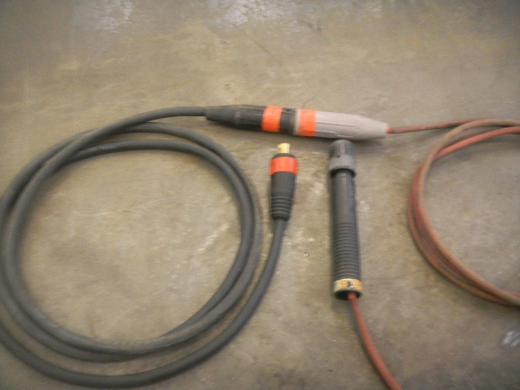

What are the welding cable connectors on the PowerArc 200ST ? The product info says standard Dinse 35 connectors. If Dinse 35's exist I can't find them. At first I thought it must be a misprint for Dinse 25 but now I am not sure. I want to build a set of extension cables and have them ready when my welder arrives so it would be good to know what connectors I need to order and if they are special where I can get them. Thanks.

This is how I do it. I cut the female end off the Dinse leads that come with the welder. Then use Tweeco welding lead connectors.
Good to know! Thanks

Thank you very much for the help. I was starting to wonder if any one knew for sure what the connectors on the PA 200ST were. I saw those but they are Dinse 50 connectors not Dinse 35 connectors. I guess you are saying they are the same thing. Are you saying that the PA 200ST actually has Dinse 50's ???? Pretty confusing when you don't know anything about connectors and no one else calls them 35's. Thanks again that is very helpful.

The difference is the size of the wire cable it will hold. It is a volume measurement of some sort. I still don't understand it. The pins are roughly 1/2" in diameter.
