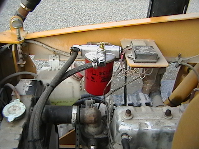

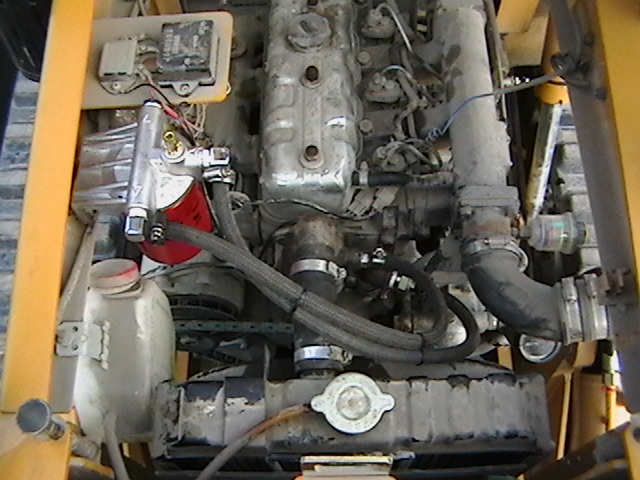

You might consider a coolant filter also. I have one and change it annually. This is meant for late model (post '50's) pressurized high velocity cooling systems. They are standard equipment on most all larger machinery.
Hi Bob,
Very interesting coolant filter.
Not meaning to deviate from the thread, but could post a little more about it, the benefits and what type of filter, please.
Thanks,
Rob-
   / Exaust Smoke, Stalling and Radiator Fluid Leaking #24
Hi Bob,
Thanks,
Rob-
Hi Rob,
Coolant filtration has been around for a long time in the marine industry, but i's only been in the last forty years or so that the benefits have been realized in the medium and heavy trucks, train engines, and in construction machinery as well. I don't want to hijack the thread, so I'll take some pictures tonight and start a new thread tomorrow. Thanks for the intrest. Meanwhile, just Google "coolant filtration".
