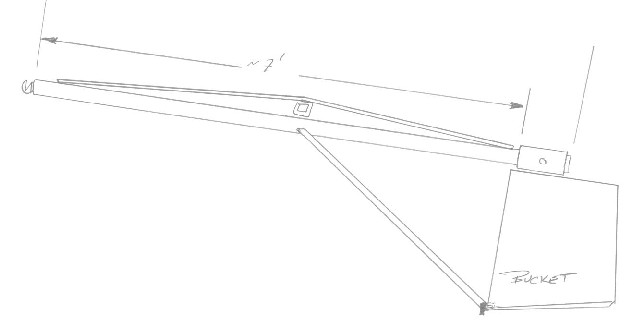

I plan to build a boom this week for a Kioti CK20S HST. I need some estimates from your personal field experience please. What do you think the lift capacity will be, lifting from the outer end?
Relevant specs:
  • The base of the boom will slide into a standard 2" hitch receiver welded to the top of the bucket.
  • Boom will be fab'd from 2"x2"x 1/4" wall square tube mild steel
  • It will measure 7' from the top forward edge of the bucket to the boom's tip.
  • I will stretch a piece of rebar over the top of the boom, in tension, to counter the longitudinal flex
  • I'll weld a chain hook to the boom's outer tip
  • the boom will be supported by 2 struts, in compression, back down to the bottom, outside corners of the bucket.
  • I plan to model it after some of the booms I've seen here. Attached below is a simple sketch. NTS
Again, I'm looking for your best estimate on how much weight I can lift with this.

Best guess, without taking measurments, is about 500lbs.
Your tractor is rated @ 1074lbs @ the pins. Again, just guessing, but the pins are about 3' forward of where the lift cylinder attaches. and the boom is going to be about 7' beyond the pin. So that woud be roughly 3/7th of the lift capacity. 3/7 x 1074 is about 460.
If you actually take some real measurments, we can get a better idea.
And also, a bucket typically has more curl force @ the bucket. But due to the geometry, the farther out the boom you go, the curl power drops off at a quicker rate than the lift capacity. So you may be at the point where you can lift a load, but not curl it.
When we set the trusses for my polebarn (about 150lbs) we used a makeshift 20' boom attached to my tractor. I had no trouble lifting the truss, but the tractor would not curl them.

I think 500 lbs. is very optomistic for 9' plus from the pins.

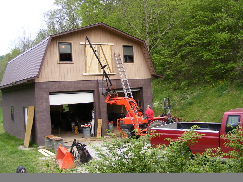

I have a very similar bucket boom, it is very handy, whatever the capacity is it will be well worth it to build. wild guess is 400- 450 for yours.
But why do you need such a long boom to pull a motor?
JB

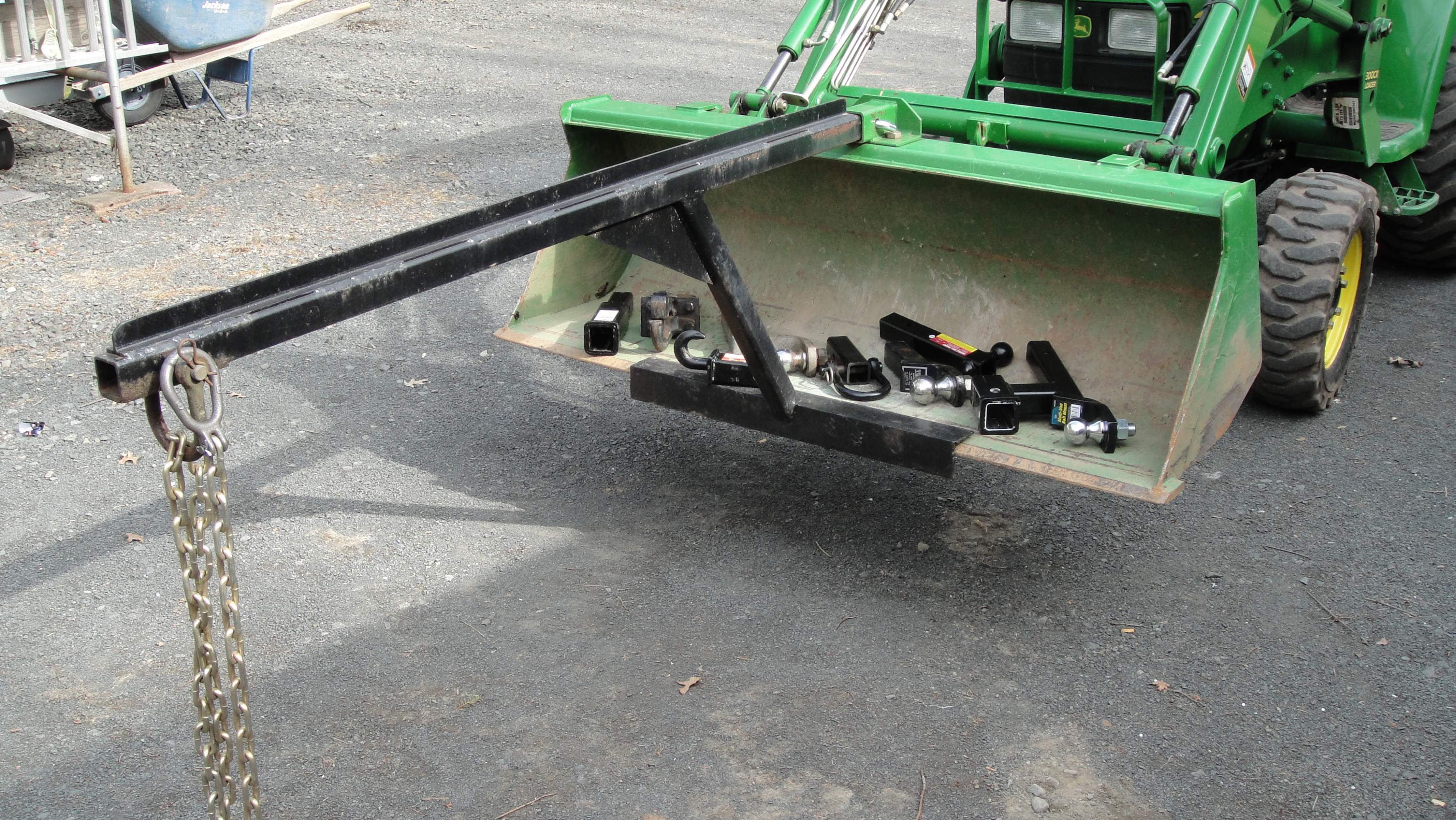

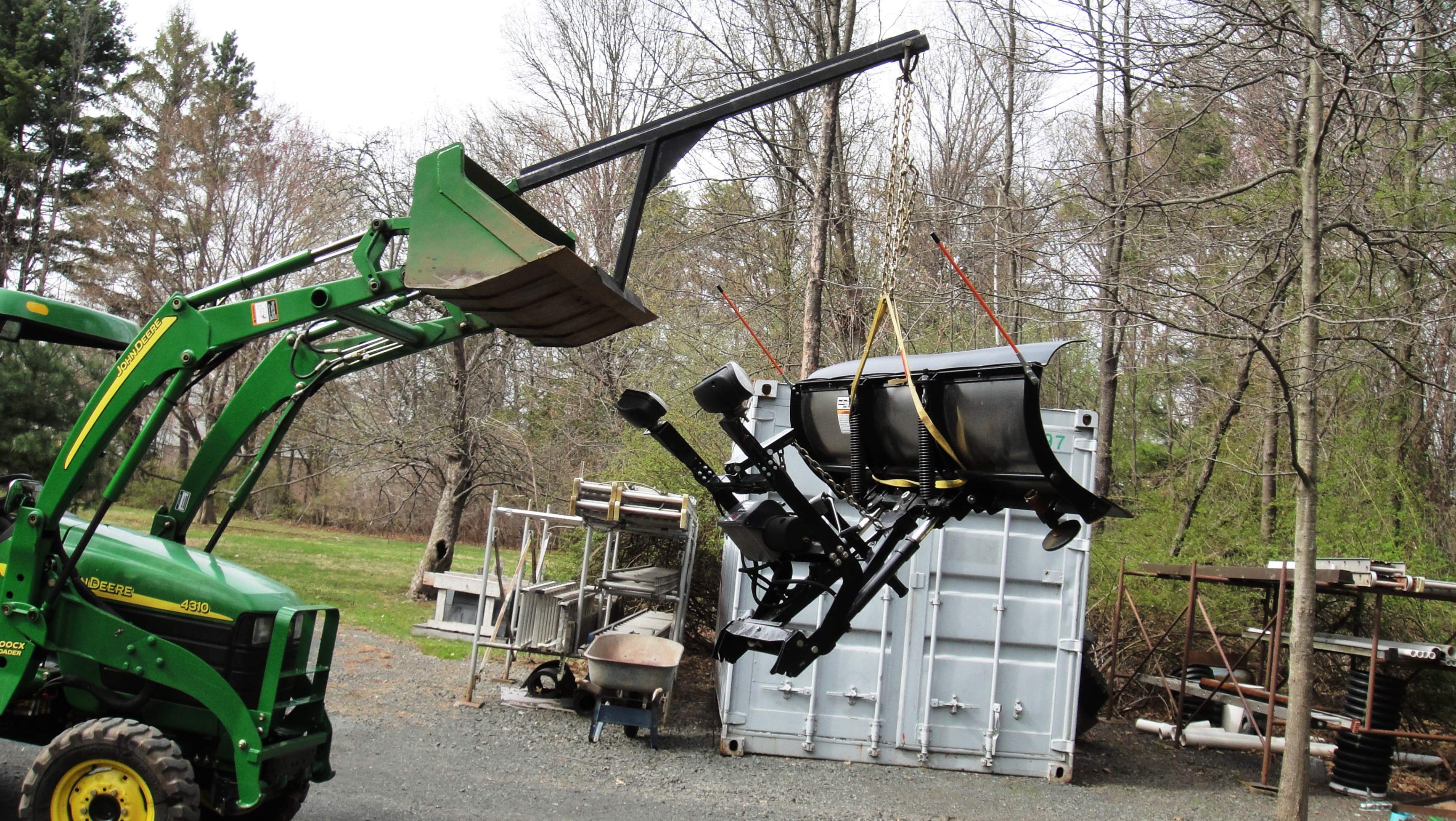

I made an adapter plate with a quick hitch so I use my pig pole on the FEL. It works great and I load tested it to better than 600# on the L4400 Kubota.

That makes it about 322lbs. But either way, It is still just guessing at the measurments. I was kinda hoping the OP would post back with some dimensions so I could sketch it out and figure it to a TEE.
In light of my error, he would have the 460lbs @ about 4' out on the boom. Using my guestimated dimensions:thumbsup:
