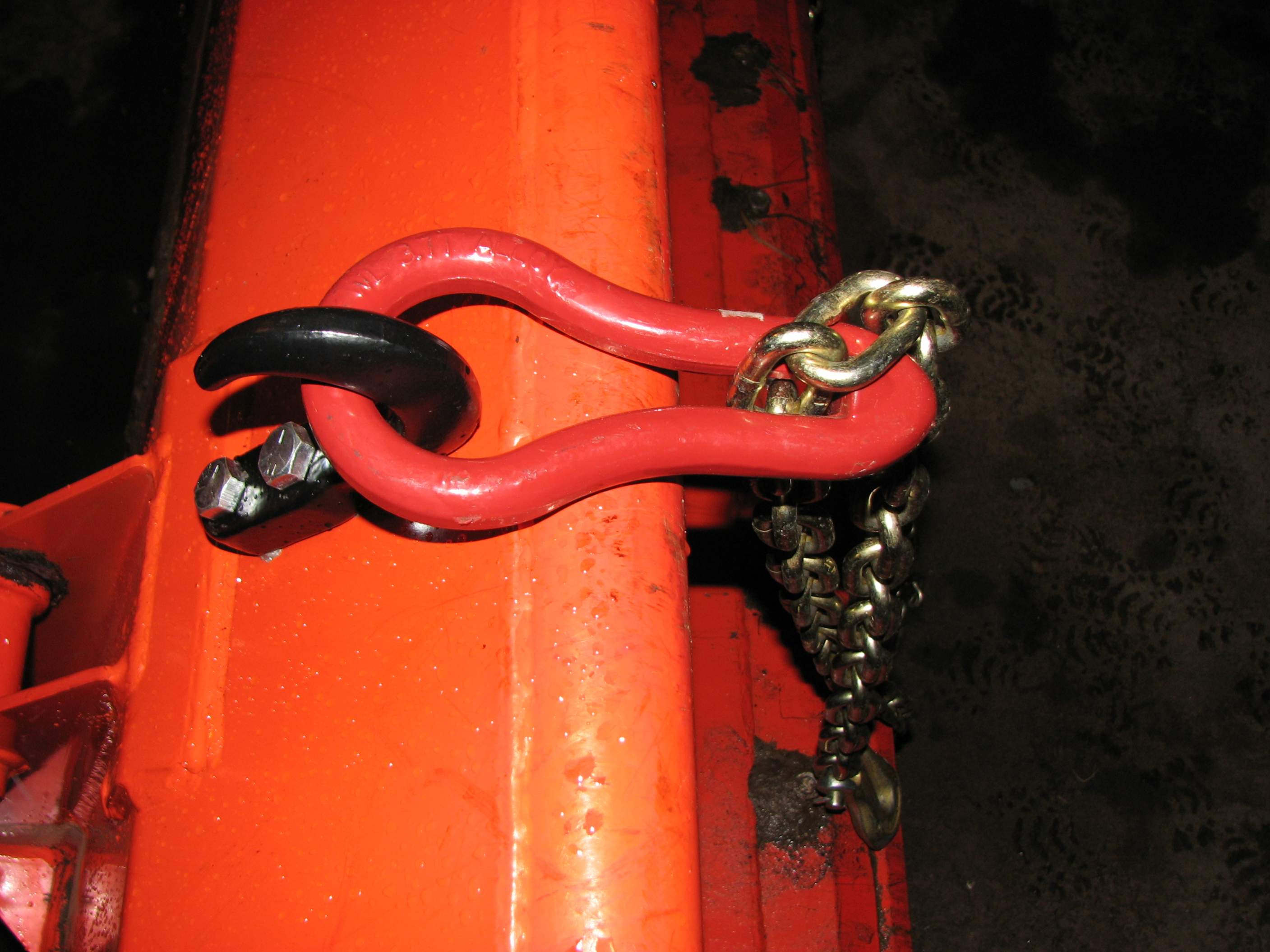

An option for slip hooks for when you wished you'd installed grab hooks:

Jim,
That device looks pretty slick! I have the same tow hooks on my bucket and that loop would come in handy. What is it called and where did you get it? Do you think they would have one at my local TSC?

Not to speak for Baby Grand but I've seen them in AW direct's catalog. I'd like to get one myself.
Grade 70 Grab Link w/ 6,600 lb. WLL - 3/8 in. - Mfg# 44200

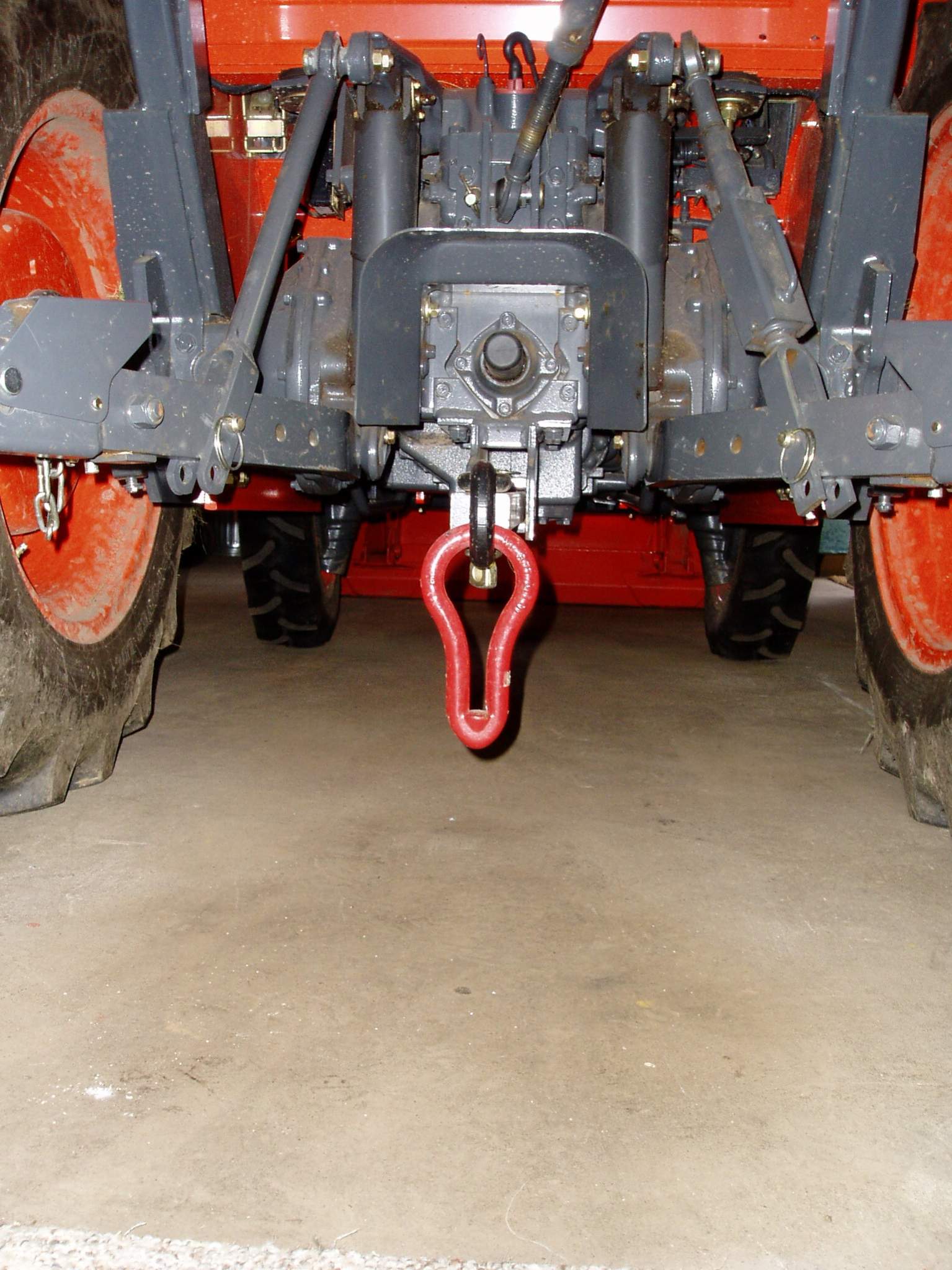

Kubota Tee-
Grab link, Keyhole link, Banjo link?
Whatever you call them, they are very handy, and very easy to lose.
Never seen them at TSC, but you can always ask ...
Here's where I got mine:
Logging Attachments & Accessories - Labonville Inc.
Attached to your drawbar with a clevis you can quickly adjust tow chain length and resecure - almost like having a weld-on on your drawbar. Works really well for skidding with a boom pole & tongs:
Manly, no?
