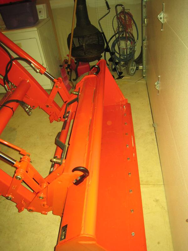

Here are my FEL hooks. They are 10K lb rated tow hooks with 1/2" bolts that I picked up at the local TSC. They are mounted as close as possible to the FEL arms. Depending on the situation, I can either use my tow strap or a set of chains. Works real nice. Got the idea from another TBNer (4shorts) whose work I admire a lot!
Nice job Thomas and even a nicer compliment and I thank you for it. Looks like it came with the machine. :cool:

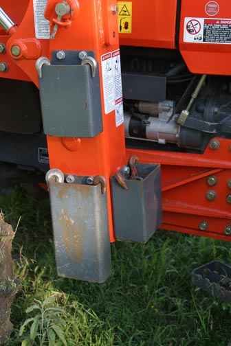

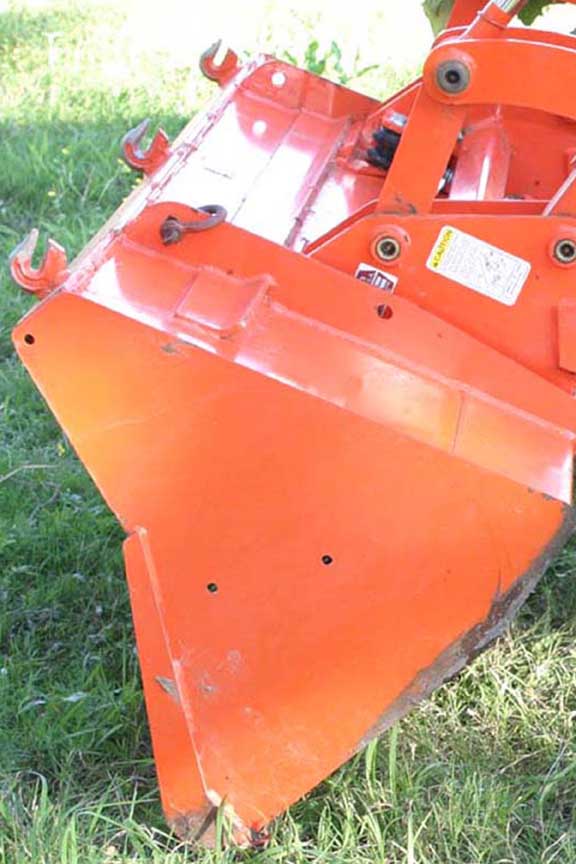

My opinion and experience
1. Consider gravity. The hook opening should face slightly upward so vibrations will not jiggle the chain out, usually just as you are getting onto the tractor.
2. Use three 3/8" grab hooks, one in center, and one each end about 5" from edge. Use a 3" x 3/8" flat bar across the top as reinforcement. Harbor freight 3/8" grab hooks are two for $6.
3. Use 1/4" grade 70 chain, 16' is a good length, 1/4" grab hooks each end. Light, cheap, strong enough, small and easy to store. See the attached chain boxes, made from steel tubing.
4. I think slip type hooks are poor, as you must then use the chain grab hooks, and gravity tries to unhook them. Skip the slip hooks idea. I'll debate this with anyone.
5. Also forget about rope, which is hard and slow to untie.

Here are the pics
