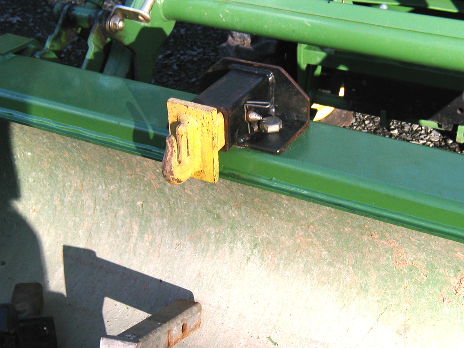

Except those nifty chain storage boxes :) and the rope comment I don't agree with most of this post. In a friendly way, not to be to harsh, I don't think there's a big safety issue but...
Lets start with the position of the hooks, first of all it's been established that outside of the lift cylinders is not the best choice, next is the angle you mounted them, defeating a good portion of the welded attachment area. I don't like it and I don't like 1/4 inch chain either.
The position of hooks on top of any bucket, not just yours, brings up another point I took in consideration when I made my "Bucket Buddy" (should trade mark that :) ) was that with top horizontal mount like most people do, in order to have hook vertical to facilitate grabbing and holding chain, you must roll the bucket forward to almost a full dumping position. which is the weakest point in the "geometry" of the loaders capacity, causing both more stress on the loader and lose of lifting capability.
Sure you can roll the bucket back once the tension is on the chain, but now you're fully engaging the cutting edge and chain. Probably not a big deal but still boogering things up a bit.
With mine, hook is in vertical position with bucket level, though there can still be some contact of chain with edge, having the bucket already rolled back that extra 90 degrees provides more lift from top of bucket instead outward on cutting edge.

You exert forces for which the bucket was never designed, for which the tractor arms were never designed
So what happens when you're digging dirt and there's a root/ rock that's not centered on the bucket?

"I think slip type hooks are poor, as you must then use the chain grab hooks, and gravity tries to unhook them. Skip the slip hooks idea. I'll debate this with anyone." The slip hooks is what I'm willing to debate.
The rest is my opinion and what has worked well for me. I lift heavy things with chain on both outer hooks, so little risk of tipping over sideways or twisting the massive LA1162 frame. For very heavy things I also have two hooks on the loader QA frame, so I remove the bucket to reduce load by the bucket weight and of course use both hooks.
No dents on the grade 70 chain yet.
