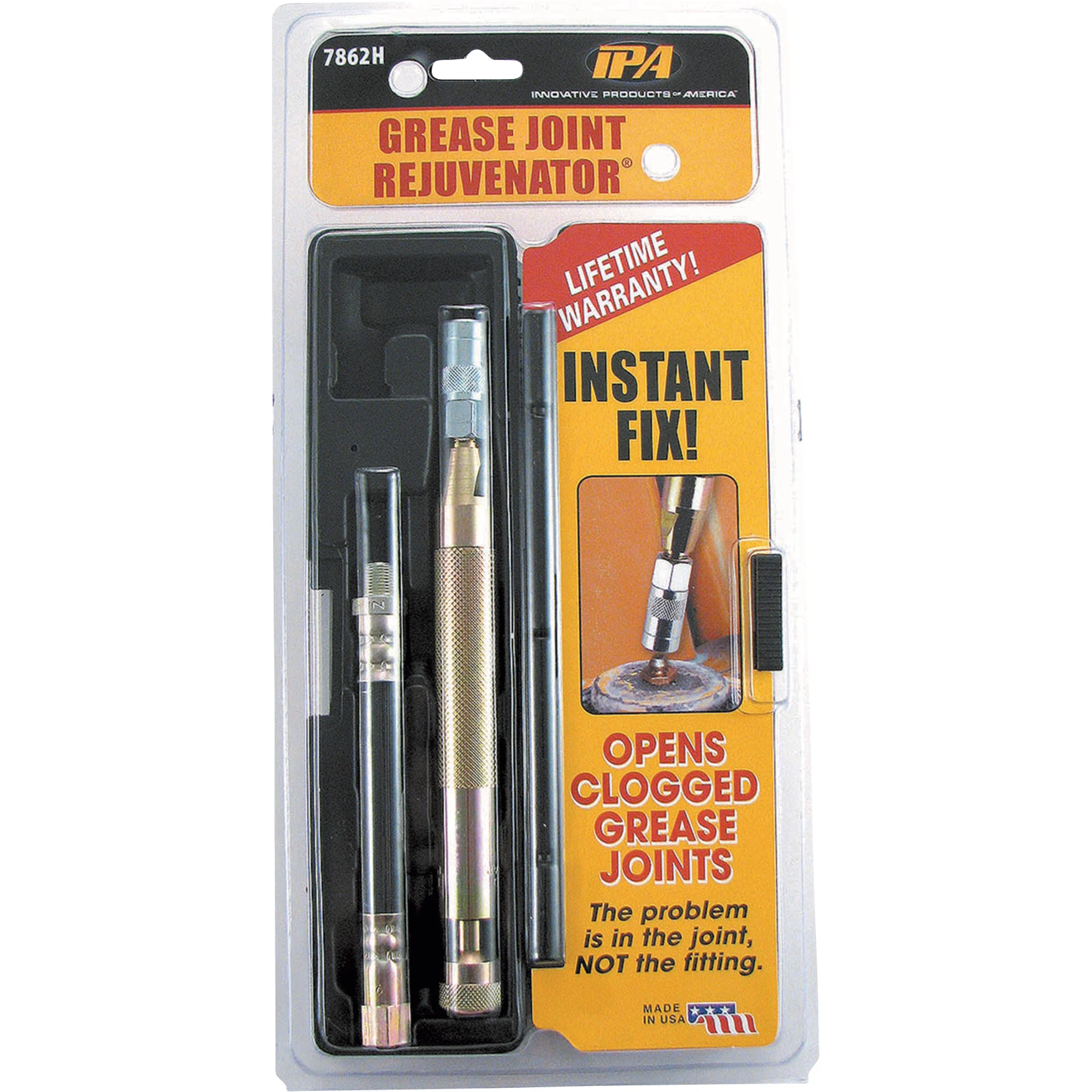

I have one fitting that won't accept grease. How does that rejuvinator thing work?
I have one!
Could not get it to work on the one fitting I tried, but fitting is in a difficult location to hit.
Working on older farm equipment, I have used it a lot. Patience and diesel fuel or any penetrant. Basically a steel syringe that you tap the plunger with a hammer and instead of a needle it has a zerk fitting. Sometimes even changing the zerk won't work cuz of the hard grease in the joint. This injects it in easier than grease and THEN it will take grease.
