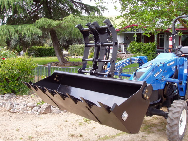

Depending on how much your tractor is pre-equipped for the addition of an FEL, (hydraulics,joystick controls, docking brackets, etc.) is where you need to start your search. Unless you are planning to hook and chain the seawall rip rap a rock or two at a time (you don't mention the size of the rocks) you should look seriously at a hydraulic grapple for a 6' loader bucket. Your JD 4700 with 45/48 hp should easily handle the work you have mentioned.
My grapple can be easily removed or just left on the standard 72" NH TC40 bucket for straight dirt work.
That Bucket mounted grapple looks very nice. Where did you find it, (brand) and if you don't mind me asking, what was the approx. Cost? Appears the bucket is specifically contructed to accept that grapple.

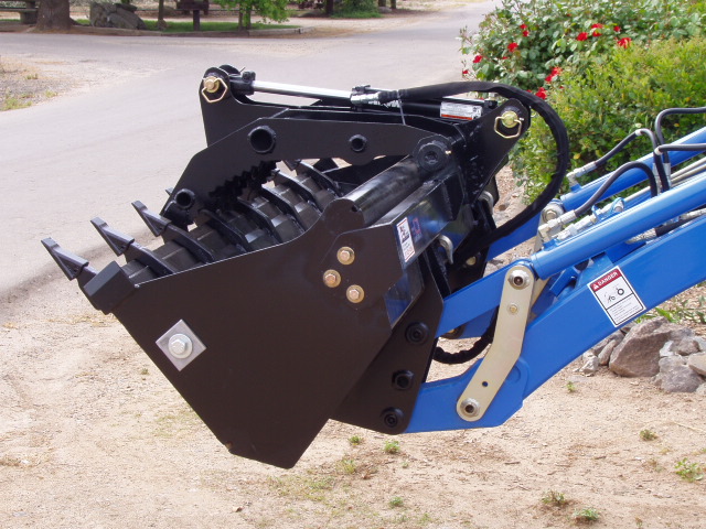

Hello swmich42,
My grapple is 24" wide and there is a 36" wide similar model also available from guess where? Right in your own back yard-MICHIGAN! Lucky me-I had to pay for a 2500 mile shipping ride out here in California.:mad::mad:
To the contrary, the grapple was autocad designed for my existing NH TC40 6' FEL bucket and after lighting it off last week for the first time, it now has a name: WILD CHILD, it's one HD unit! The builder is MIE, Michigan Iron and Equipment Co., a sponser on this site. See the prices on their website and look up "Find New Posts By Nickel Plate" or look back to around 4/22/2011 in the "Attachments" section of TBN for the start of my four part grapple installation series entitled, "FEL Grapple Bucket Installation". It's a pretty good read for guys like me that have had no hydraulic install experience before jumping off the grapple cliff..........
