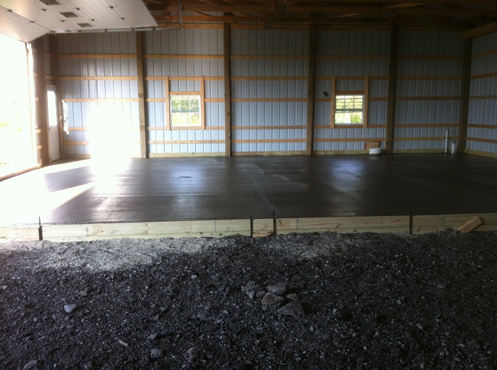

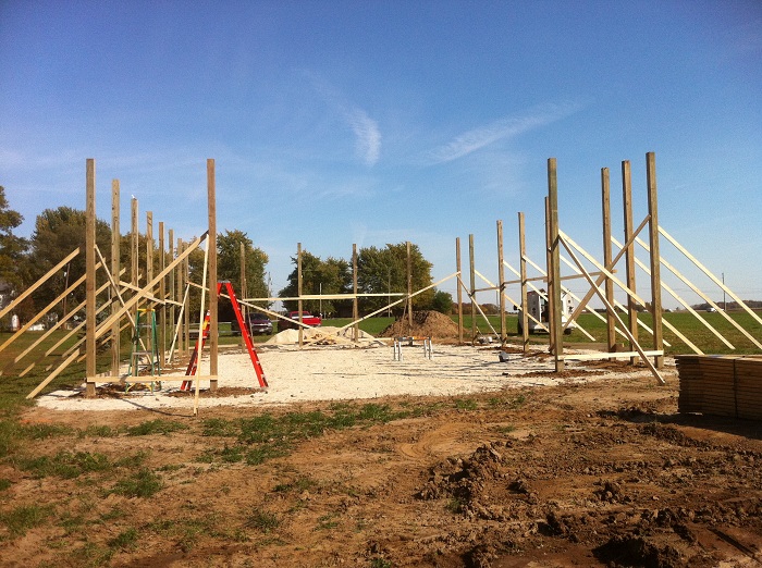

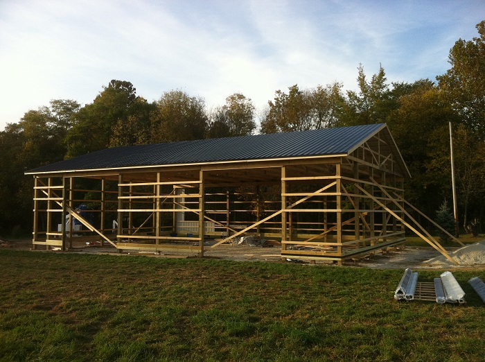

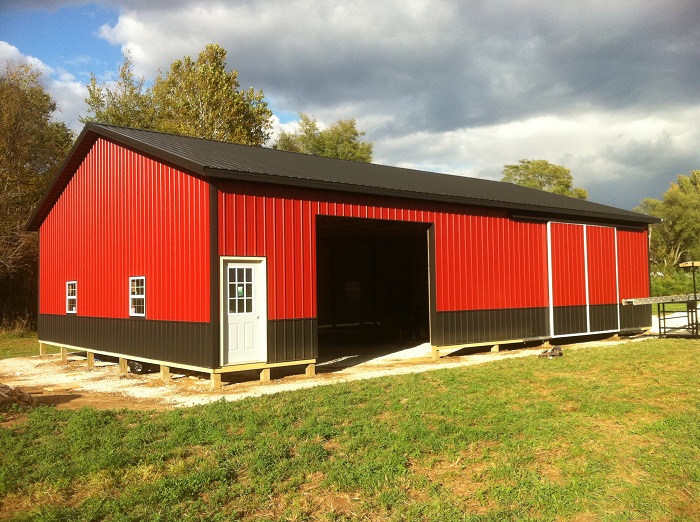

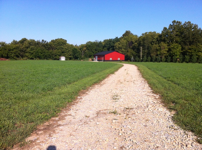

Day Seven.. We have a competed barn. Now I'll be asking lot a questions about the finish work.. First will be running electrical.

Ok now that the shell is up.. Need to move to the next phase(s).
First I need to know what would be next best move.
I will finish out the walls with 2by material between the poles.
I plan on putting either 2' or 16" on center 2"x6" between the poles.
Whats the best way to nail these in place. I know that I will be using 2"x4" girts spaced 2' or 4' apart. Is girt the correct word? Should I attemp to toe-nail to the back girt, this is the one that the siding is screwed to. Or just put nails through the front/inside girt and maybe a little construction adhesive on the back girt.
Now here is another question I have.. Should I run elctrical before putting these in or after?
Wedge
   / Finally the barn. #45
If it was mine, I personally would have it float. I'd have the concrete floor in first, then build the walls 16" OC and seal/nail bottom plate to floor and ends nailed into the poles. I wouldnt touch the batten boards for your siding. Electrical would come last as you can put the boxes/wires within the walls you put up just like a house.
   / Finally the barn. #46
Wedge
Based on my personal experience, get ALL the framing done and THEN run electrical.

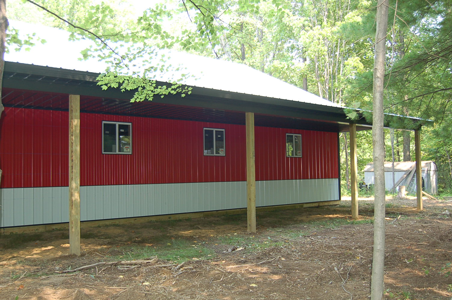

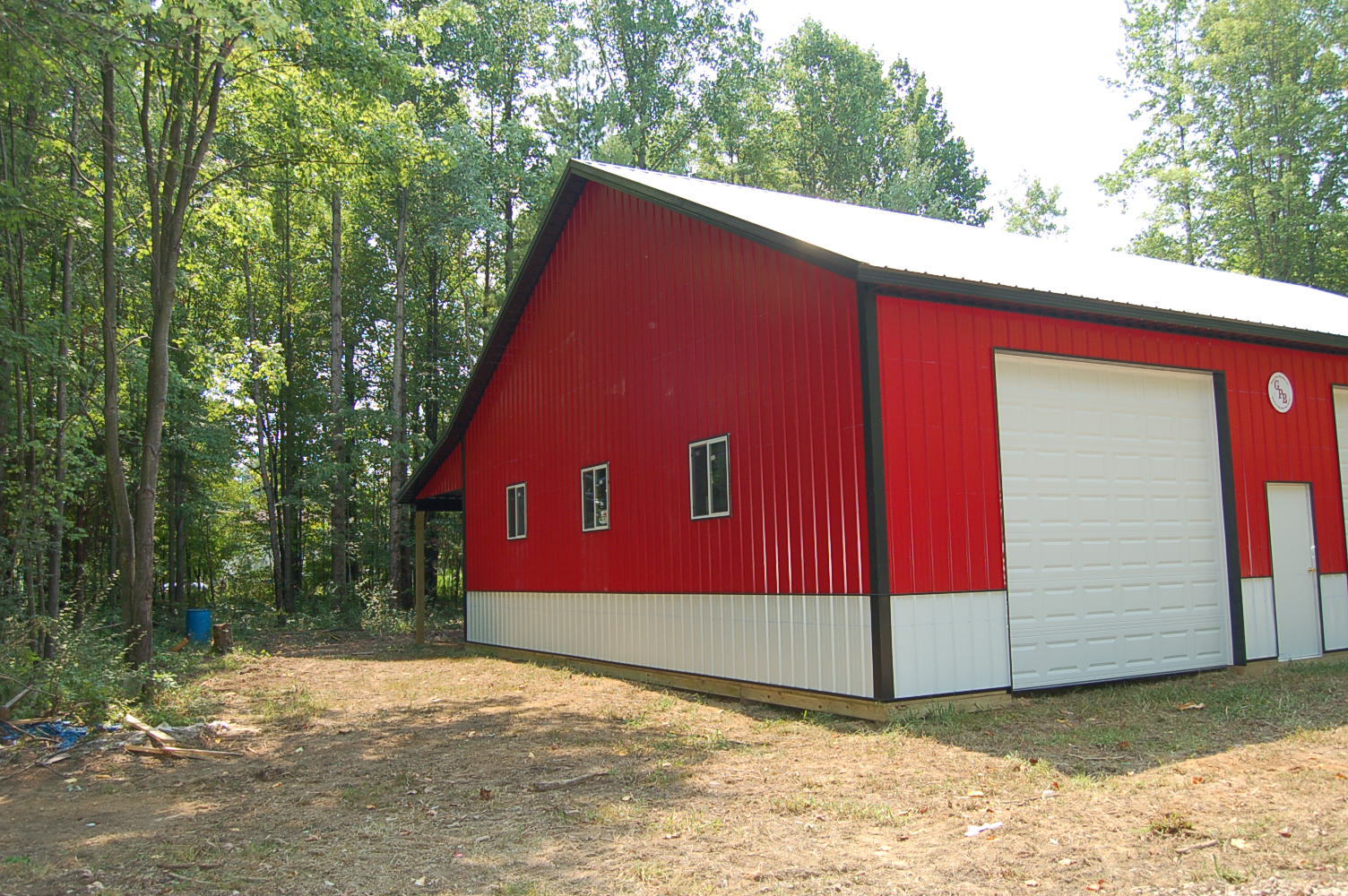

Wedge your post is what inspired my project! Here are some pic of of my build!img11.jpgimg14.jpgimg17.jpgimg18.jpgimg33.jpgimg35.jpg I'm at the point of getting electrical trenched in and starting the interior finish and seperation wall between shop side and storage side.
