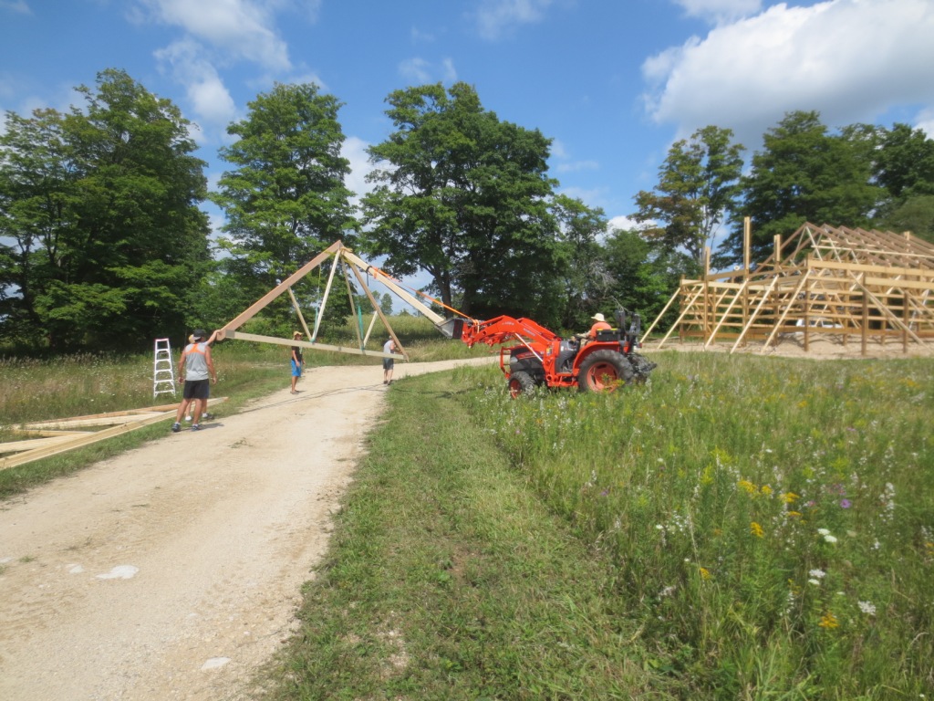

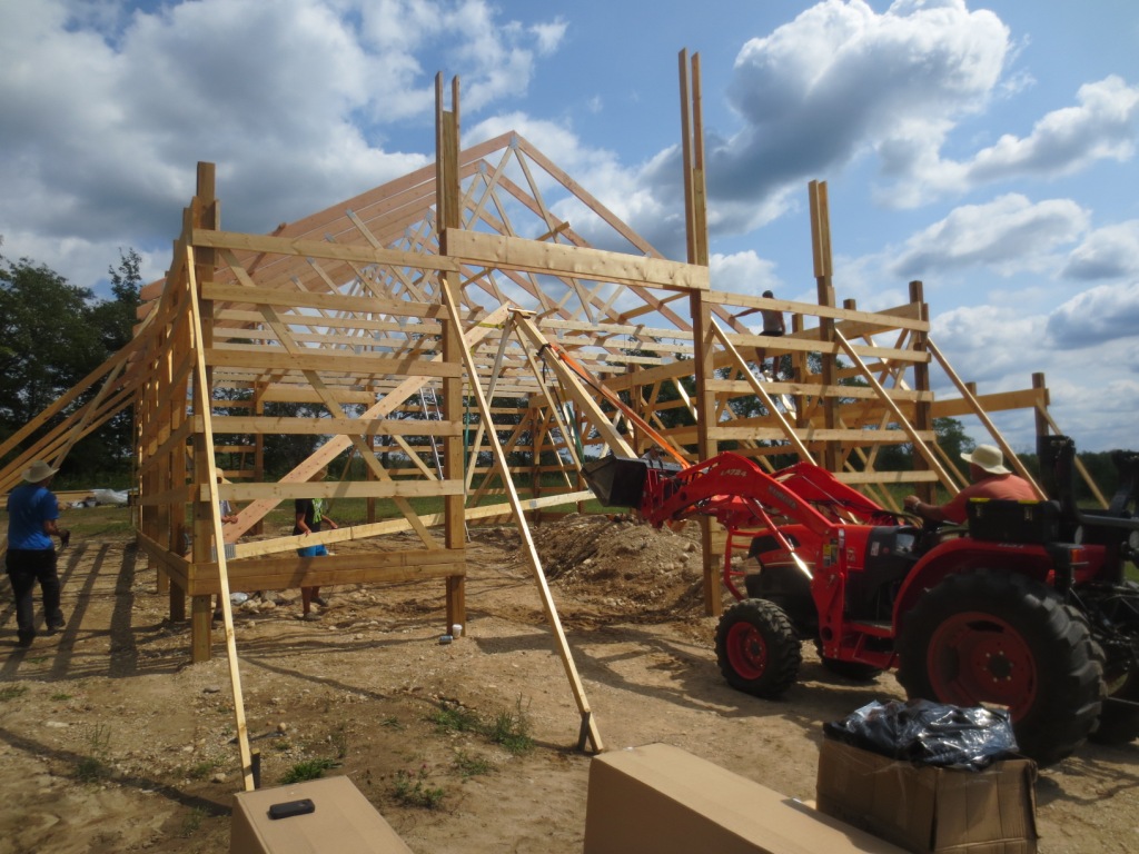

I probably deserved some Darwin nominations for my solo barn build. Its great when a plan comes together. I think the trusses/boom pole off the forks was the toughest part (I had 32' attic trusses).
How did you make that?
