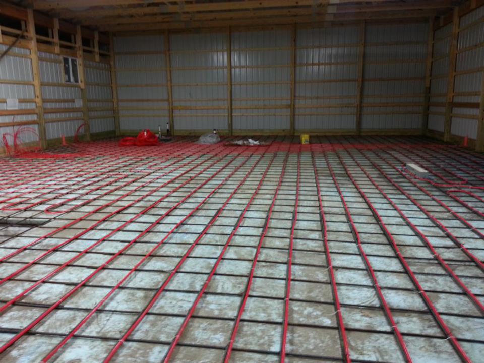

Two small photos to add. One is the final pex layout. Good thing I got loopCAD for free for a month. Not impressed with the software. Everything I've ever read is that the each circuit in a zone should be within 10% of each other. I would think loopCAD would do this automatically for you. OH NOOOOO. I had to play with my layout for almost half a day till got to this version.
Also included is my final design. On the left side are two 4'x'4 areas that the pad will be thicker. I plan on putting a two post lift there in the future.

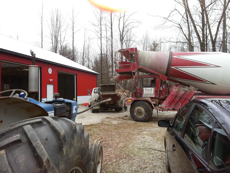

#58
Been a few months. Here is an update.
Finally poured cement last week. 4 truck loads on Wednesday and 1 more for the apron on Thursday.

   / Finally the barn. #59
Wow, nice looking building. Has to be a good feeling to have the concrete in.
Very nice! I am getting in touch with concrete guys now to pour a floor in my 40x60 in May, hope it turns out as nice as yours did.
