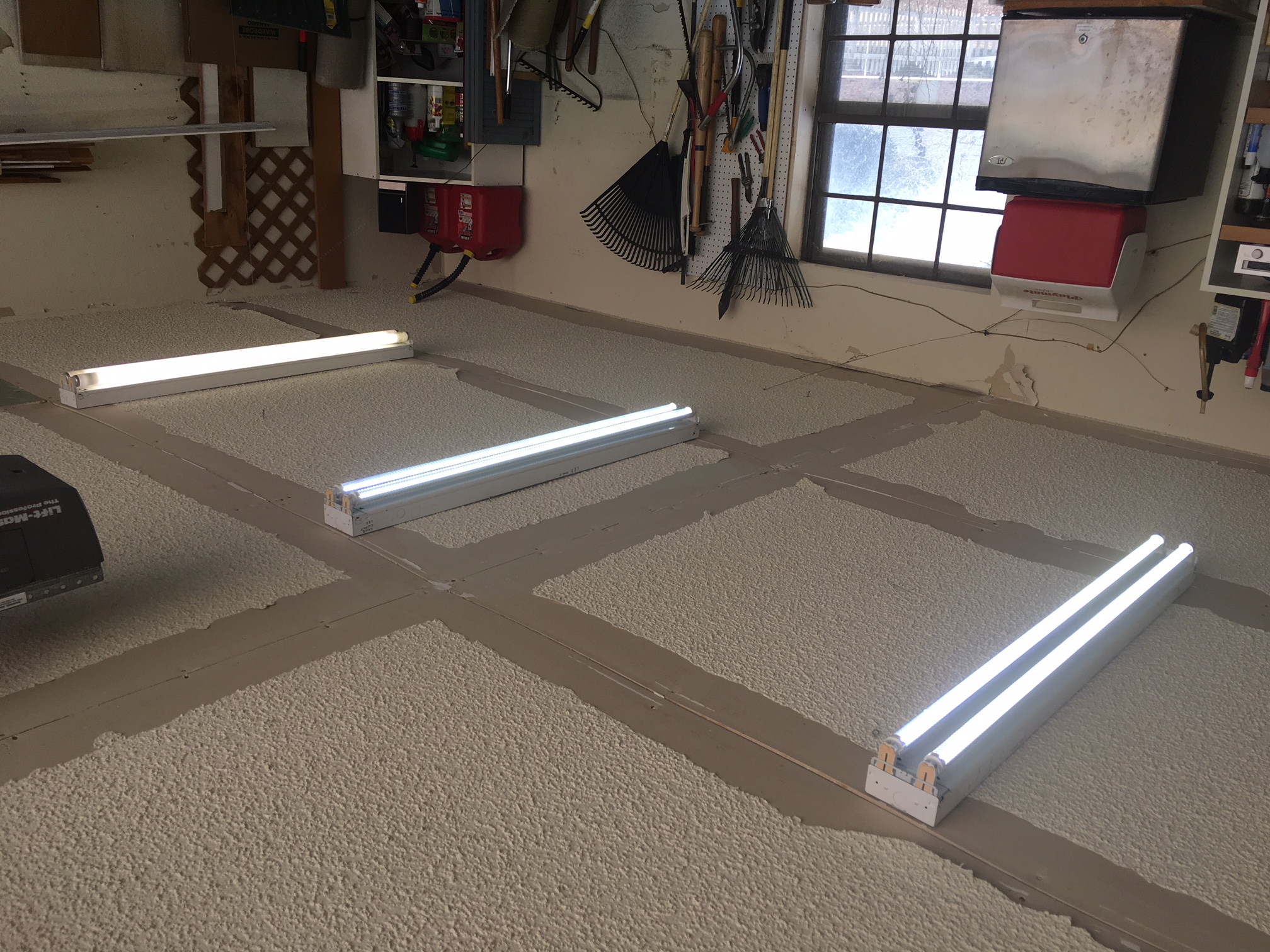

Here's 8 - 4ft - 4 bulb T8s in a 42x50.
I'll add, the more "junk" you have in a shop, the more light it takes. Everything absorbs light.
