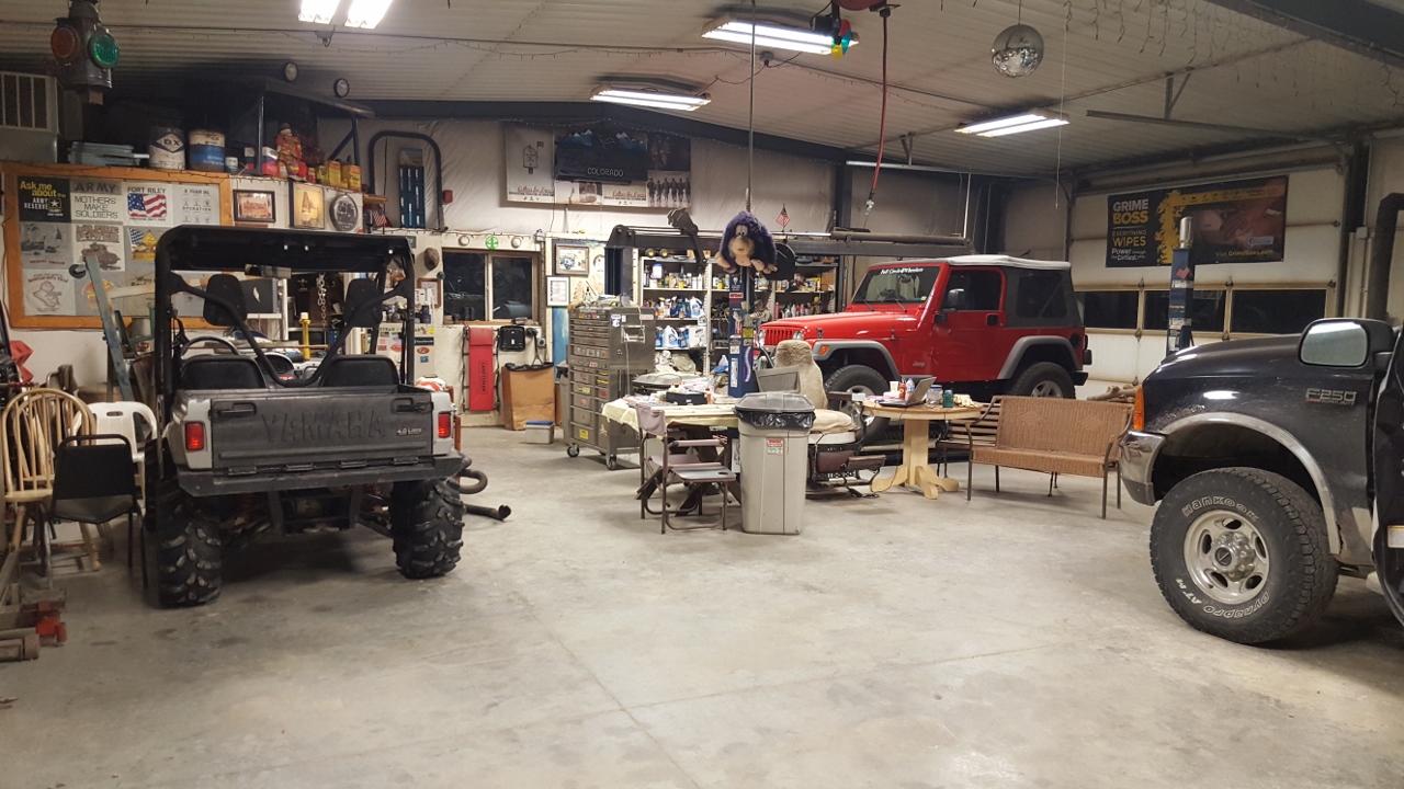

I swapped out some of my incandescent and compact florescent bulbs in my barn/shop with splitters (double sockets) and LED bulbs. My plan was to replace the old with 2 new '60 watt equivalent' LED bulbs at each fixture as the old bulbs died. I'll warn you all right now, once you have LED lights in part of your shop, you will upgrade the rest of it immediately like I did. The 'instant on' at 100% brightness puts a smile on my face every time I flip that switch.
It's actually worse than that.
LED's are at the point they are still getting better all the time. Just when I think I'm done replacing all of them I find some new light that is even better and I start thinking about upgrading lights I've already upgraded.
LED's are just better. I'm done with balky, fragile, hard-starting, noisy fluorescents and their ghastly light. I'm done with incandescents and their heat and short lives. The light from LED's is better, they last longer, they're more reliable. And they're getting cheaper every day. They're now cheaper than fluorescents.
I have two outdoor lights on my house that need a ladder to change the bulb. I just put LED's in both, with luck that's the last time I'll ever touch them.
