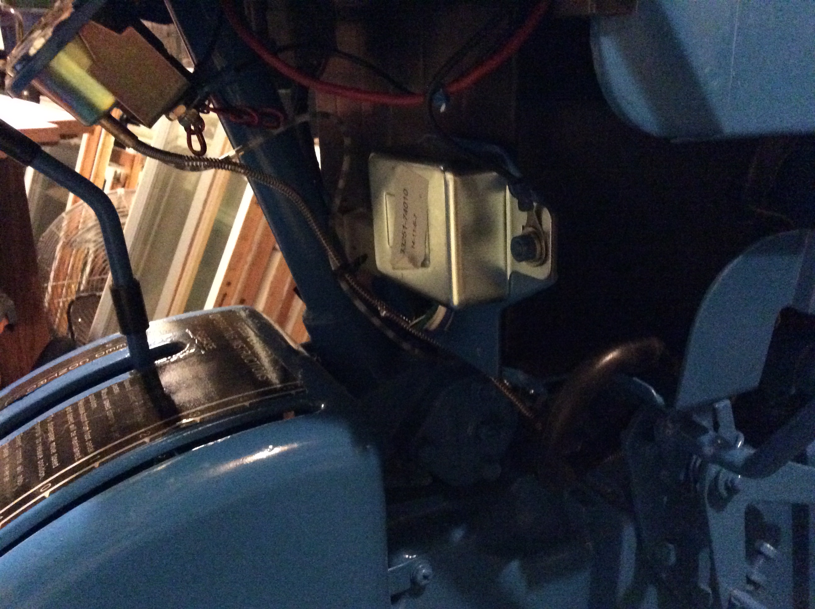

Out with the old in with the new. Finally got around to replacing the voltage regulator. No more voltage drop when I turn on the lights. The new one is a solid state unit too, no points and solenoid in this one.
Not to be a killjoy about your voltage regulator, but I will relate my experience. I installed two or three of those solid state regulators in my Ford 1700. All of them would go kaput after 5-20 hours of use. I'm no expert at herding electrons, but after I ordered an original mechanical voltage regulator from NH (for 120 bucks!!!), all was well. Just some info in case you have issues.

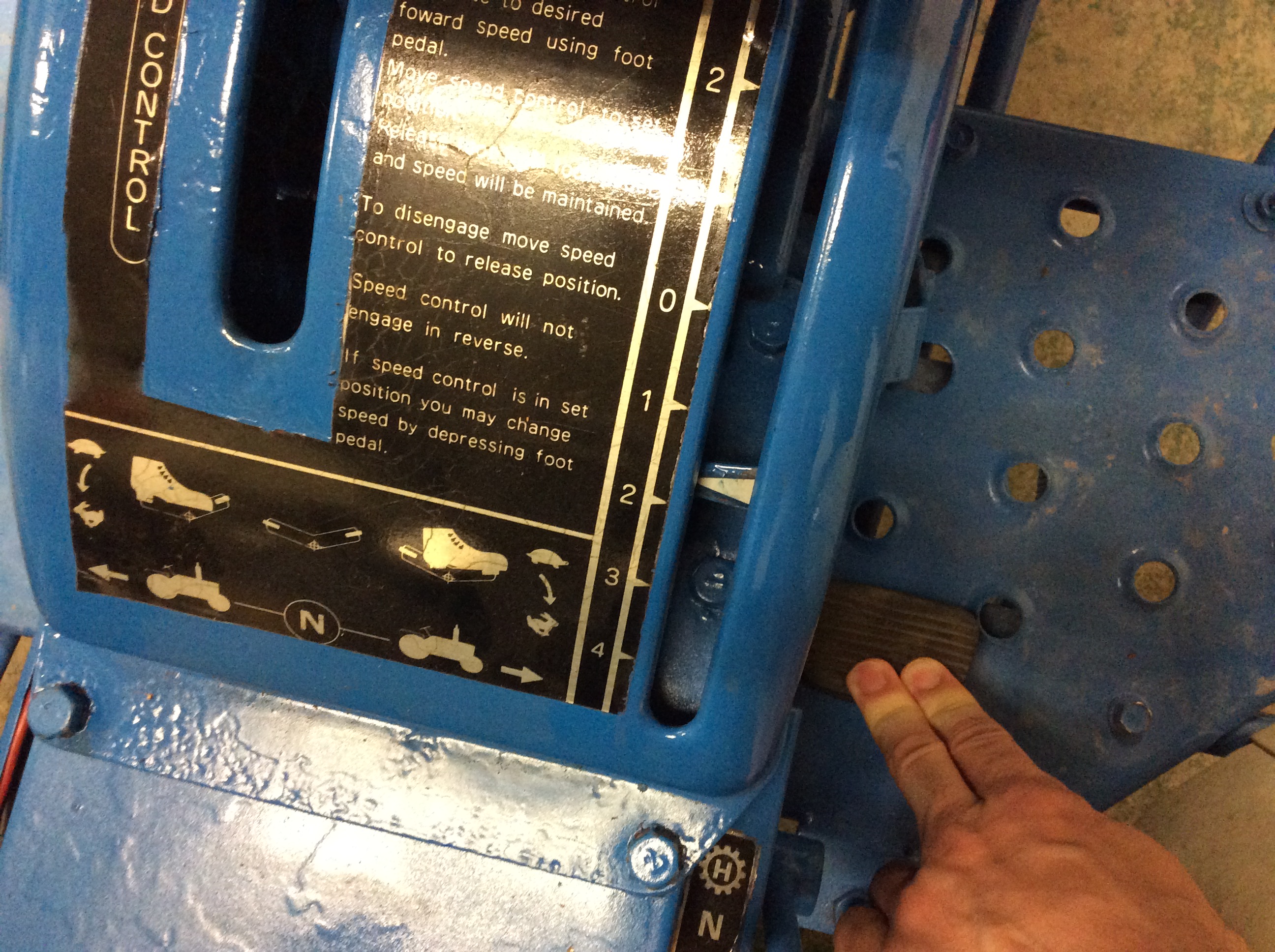

I believe I have an adjustment issue with the hydro stat linkage. The tractor only has half speed in reverse, it is painfully slow. As you can see by the speed pointer, it is only about half way on the scale. I took off the covers and inspection plate, but don't see any way to adjust it. Any help would be greatly appreciated.

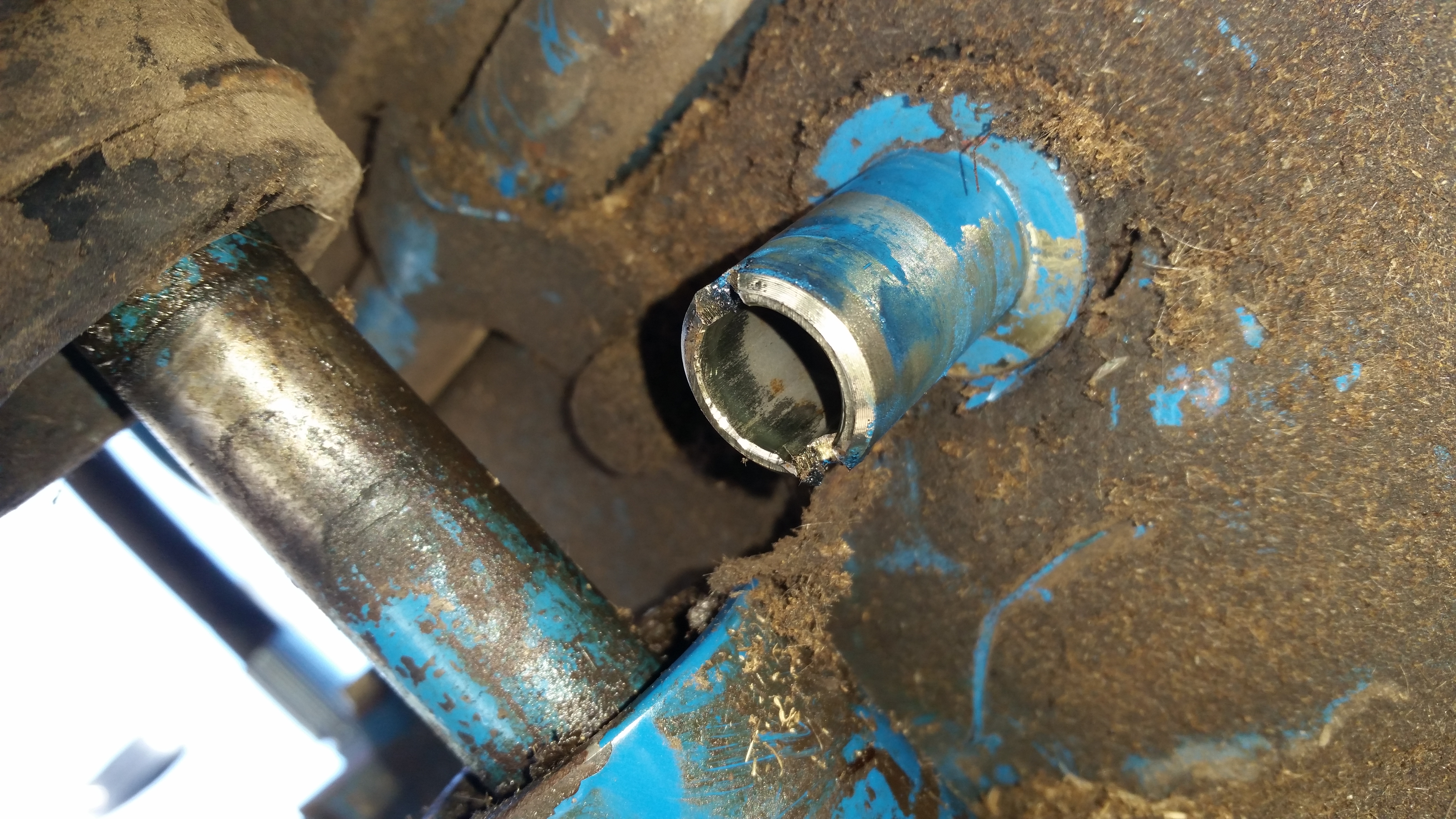

Glad I caught you before you "Split" her apart....Need to tell you about your hydrostat drive rod...

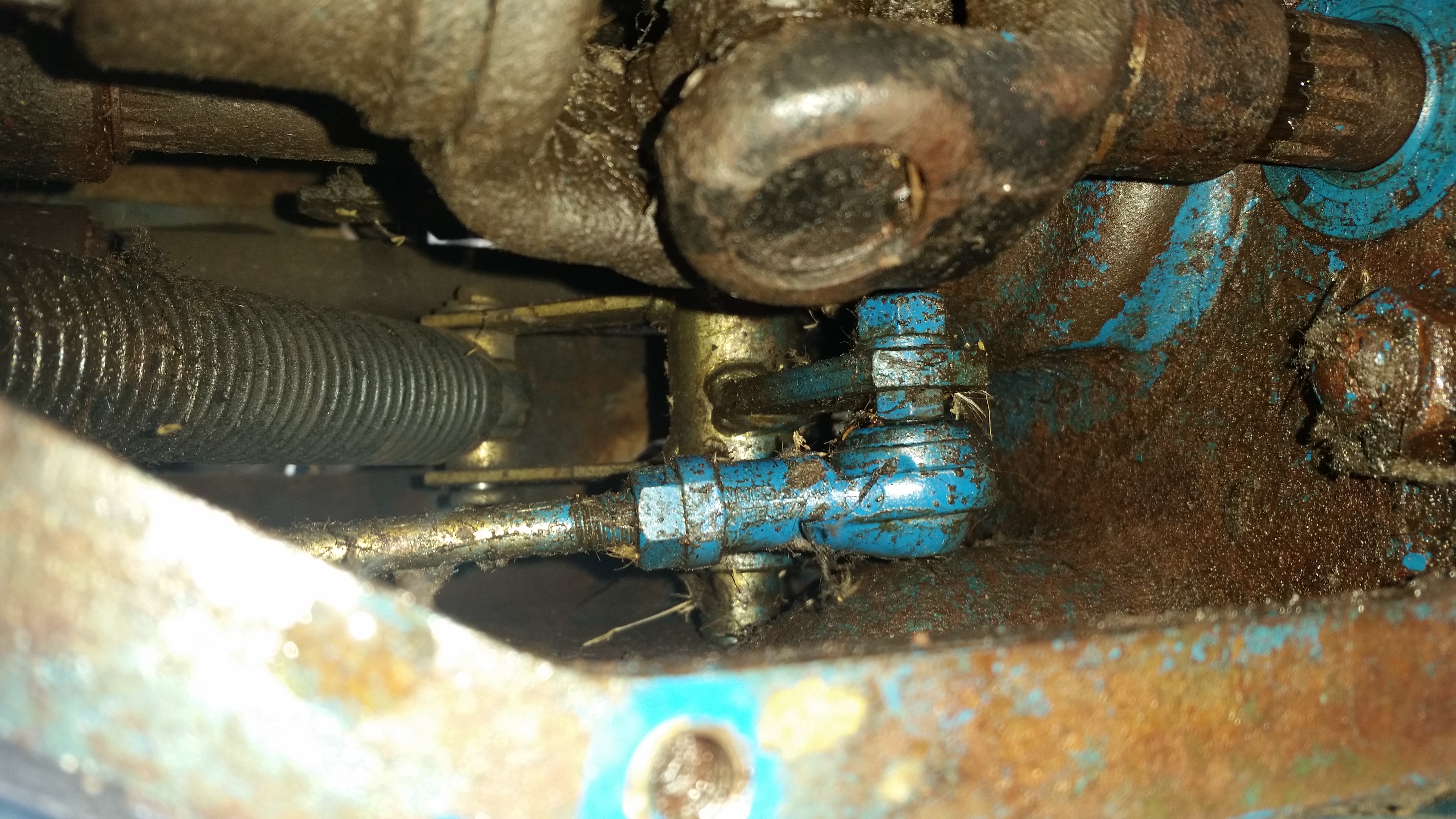

Was mowing with my 1210, hit a log with deck and it lifted the deck up. Backed up and Did it again....lol.....Any ways, when I tried to go forwards, it was slow. backed up ok, forward slow again. When I backed the 2nd time, tractor went full speed onto some steel roofing I had stacked and hung up. I have NO IDEA why it reversed full speed, but it no longer would move with the pedal. Mine is hydrostat, 4wd.

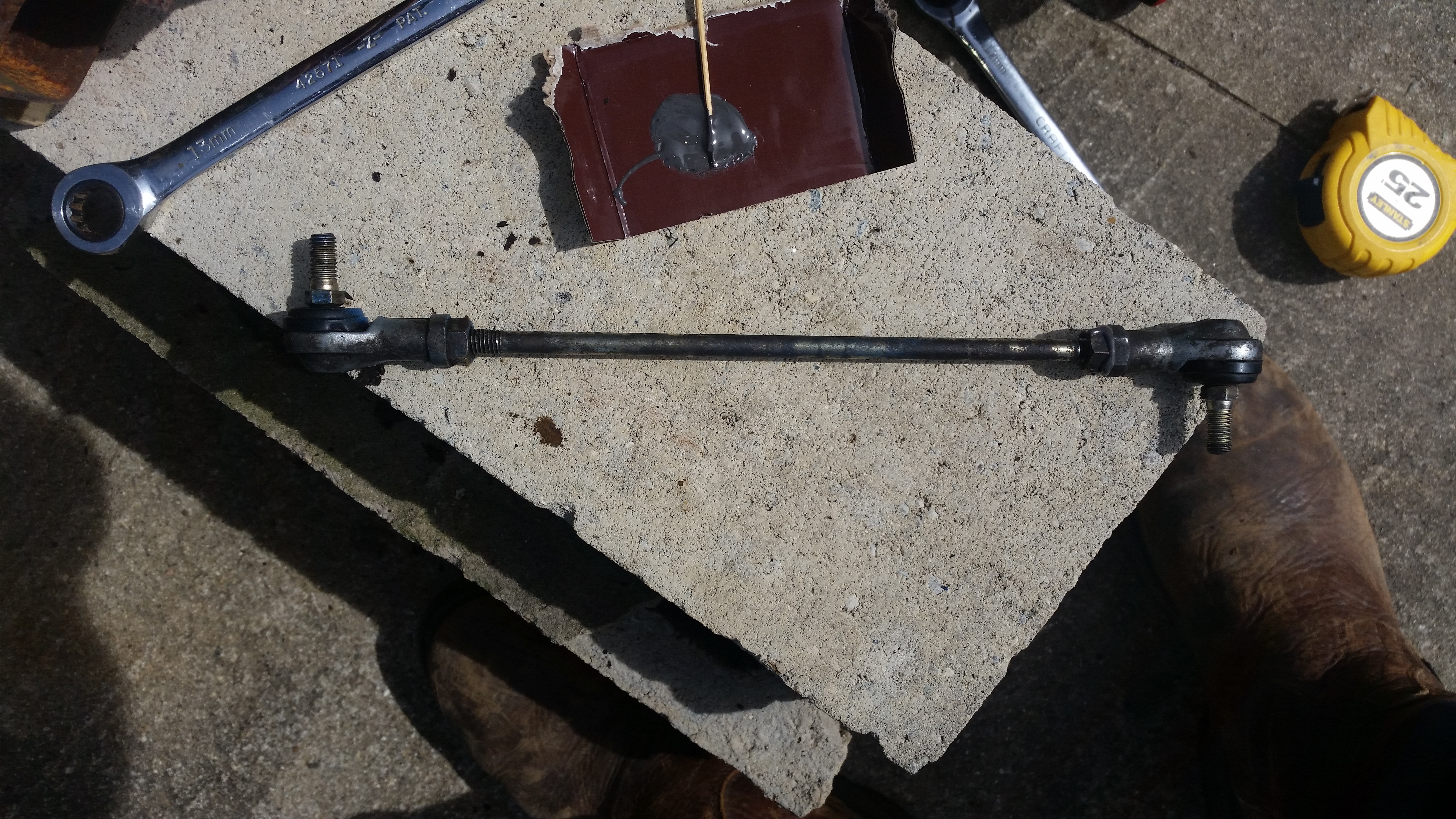

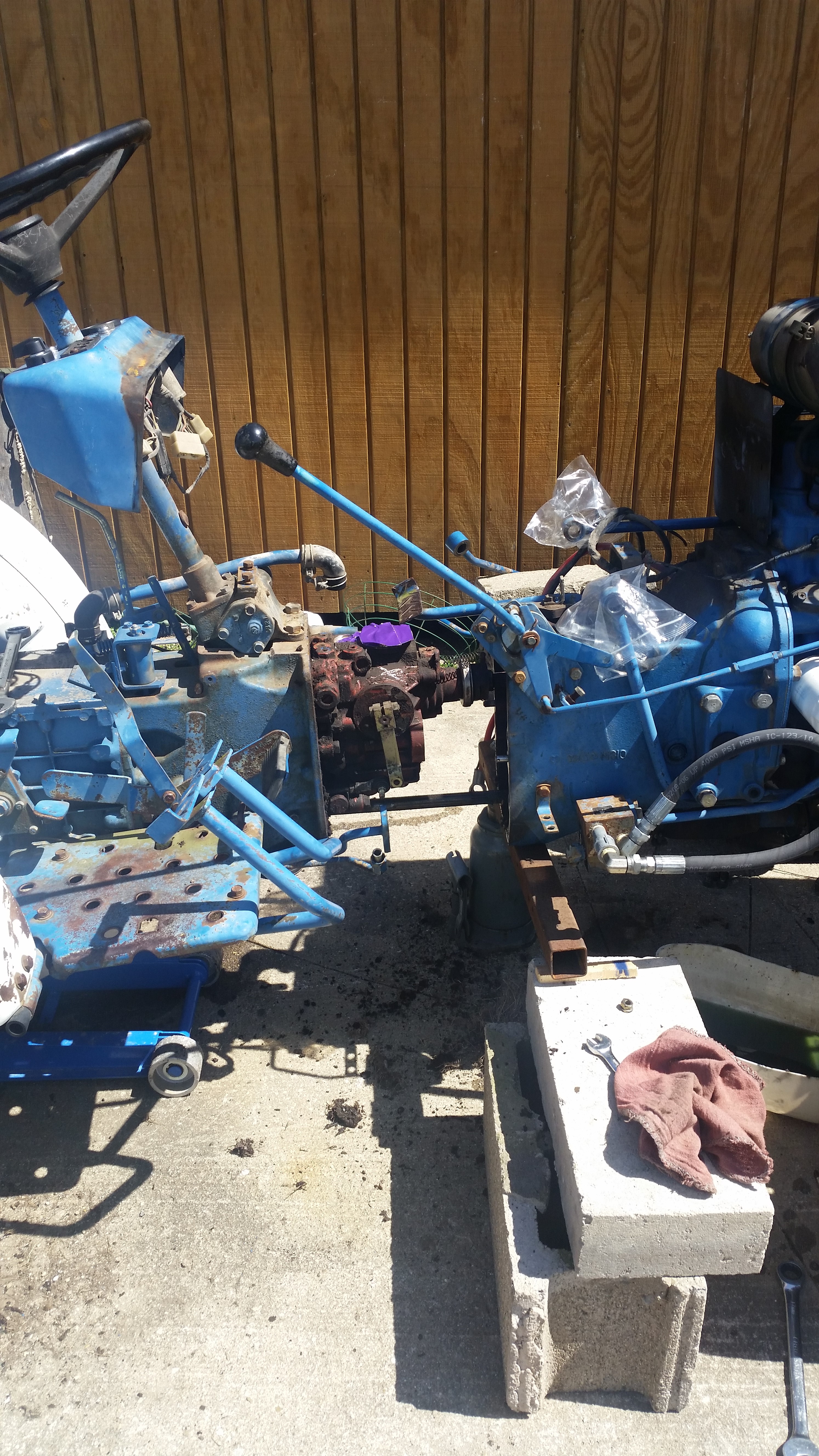

Here is what happens, when your tractor will not move, 1210 Owners listen up......the tie rod end stripped out and the drive rod is loose now. If you remove the inspection cover, that You had to buy new and look up inside you will see the rod. If you grab it and it does not move you are good, for now. When they built these tractors, they threaded the rod, all the way on, on one end, which left only a few threads to fasten the other tie rod on with. Over time the tie rod (aluminum) strips out and now your hydrostat pedal wont work. You have to split it to repair it. If you got a 1210, you WILL end up doing this, BUT, it's not that bad of a job. If I can do it, ANYBODY can do it.
ford 1210 1.jpg remove your cover under the tractor, see if that rod is loose.
ford 1210 4.jpg the rod, notice the direction of tie rods.One end goes left, other goes right. I took the good end, loosened and rotated the rod 1 1/2 turns to give more threads on bad end. Then JB Welded the BAD tie rod on, DONT JB WELD both ends.And put welded end in front, so you can Adjust rod if need be. 10.9" is what the tie rods have to be apart from each other.
ford 1210 3.jpg Here she is split, yea outside..Before the rod was fixed.
ford 1210 2.jpg This little baby hides under the tractor, stick a screwdriver in those slots and it will screw out. Tractor WILL NOT split, if its still in, so DON'T FORCE it apart.

Thank you for the tips/ideas. I will pull the inspection cover again and take a look. Hopefully it isn't the push rod stripped out like you say. That would be a real downer...
