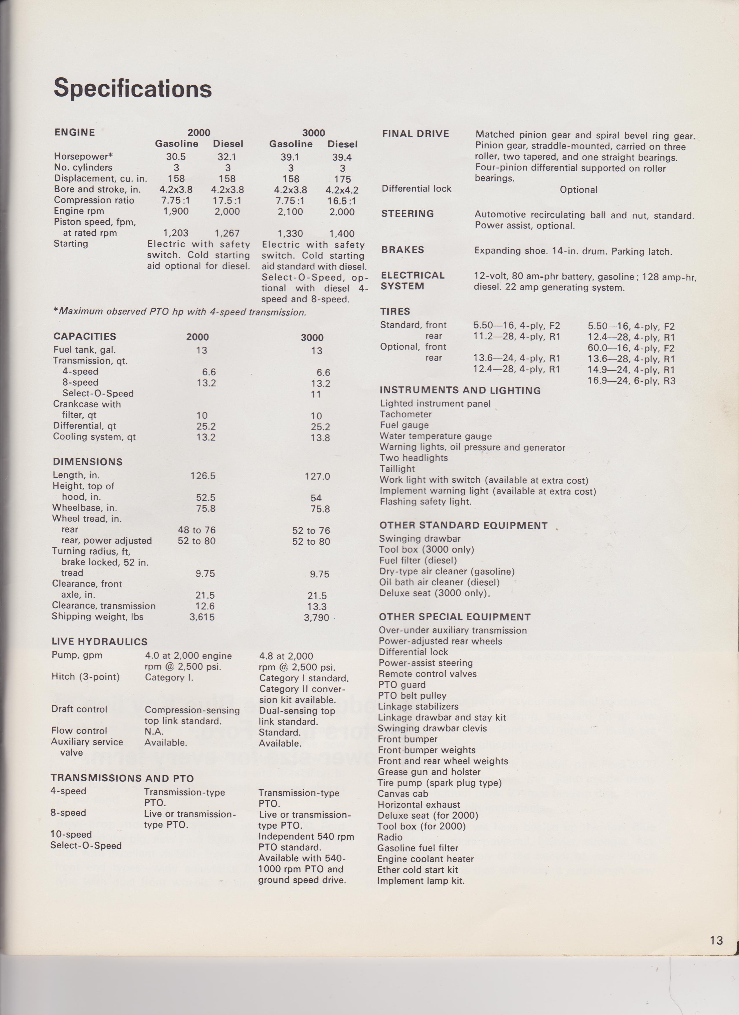

Would a 7K car hauler be adequate to move a Ford 2000 (3 cyl) with loader about 100 miles?
My friend just hauled an MF 50 over 2,000 miles on the trailer in question with no problems, but there was no loader involved.
Now he is thinking about the Ford with loader on the same rig and 100 mile trip.

Well I believe the 2000 weighs in under 4000# add the loader maybe 1500# (full framed 730) and that leaves the tires if calcium chloride loaded 800# = aprox, 6300#
Now if the tires aren't loaded- use the lower possible weight of the 2000 @3615# =4800# at a minimum I think if the payload rating of the trailer is a true 7000# should be OK...:thumbsup:

The minimum weight for that Ford is 3,770 (call it 3,800 with fluids), the loader weighs 1200-1500lbs, and then you have the weight of the trailer. 7K trailers weigh at the very least 1,500lbs (open center), with many more like 2,000lbs. At the very least, the trailer will be maxed out....it just depends. Does the tractor have a canopy, loaded tires, etc? What does the trailer actually weigh?

the data plate on that trailer would help decide whether or not it can haul that 2000 Ford. I found my original 1968 sales flyer for 2-3000 tractors shipped weight is 3615 (3300 was low) the 3000 is 3790...View attachment 314336 I believe that is with all fluids except diesel and loading of tires If they are loaded ? The #s appear to be to close without the payload rating of the trailer, and whether those tires are loaded....
