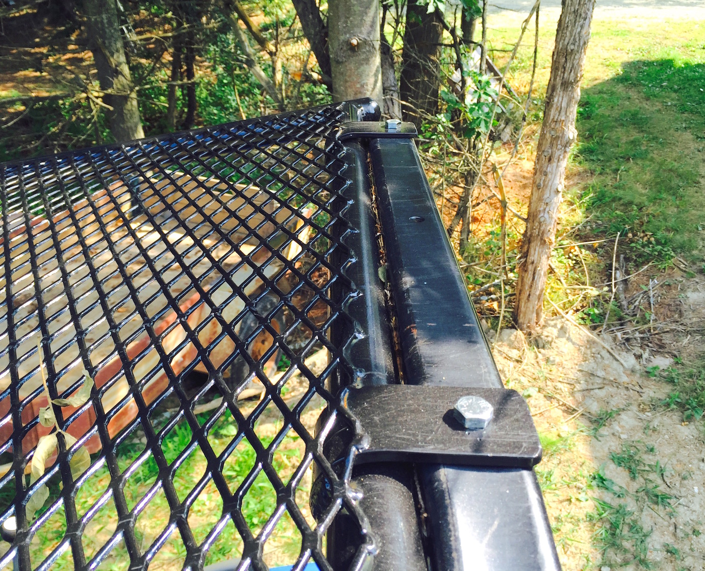

The limb risers and FOPS (falling object protection) were done by a local fab shop a few miles down the road from me. You can see the limb risers angling up from the front of the tractor. The part over my head has expanded metal to protect from falling objects. I used expanded metal so I could still get a good view of what is above me. If I were doing it over, I'd probably use solid metal - or maybe mostly solid with a short section of expanded metal along the front edge for upward visibility. I added this a few years ago when driving along one of my woods trails and a branch fell, bouncing off my roll bar and grazing my shoulder on the way to the ground. It was not a windy day, and I had not been out doing any logging activities. I did not bump the tree - it was just a random dead branch falling. If the timing had been a split second different, it would have landed square on my head, and I wouldn't be writing this today. I decided the woods had given me a "friendly warning".
There is a belly pan underneath made of 1/2" steel plate. (I'd have been inclined to go thinner, but the guy at the local fab shop has done a number forestry mods on various tractors, and he strongly recommended it.) Most of it is mounted on the subframe for my Woods Backhoe, which simplified the design & mounting a good bit. Ahead of the main pan is a smaller piece that attached to the front of the main pan with a tongue & groove. The font edge of that connects with two bolts to the tractor. It's light enough to remove easily when I need to change the filter it protects. All of this was done by the same fabrication guy who did the FOPS/Limb Risers. He is a really thoughtful fabricator for things like this.

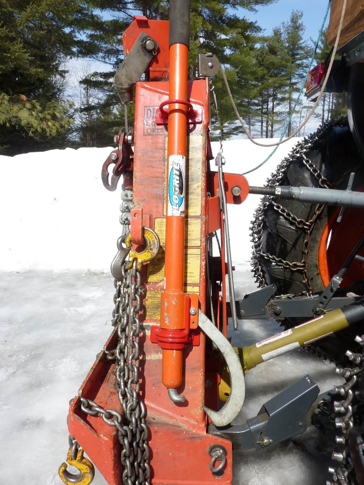

Here are a couple of little things I did to make thinks more convenient out in the woods.

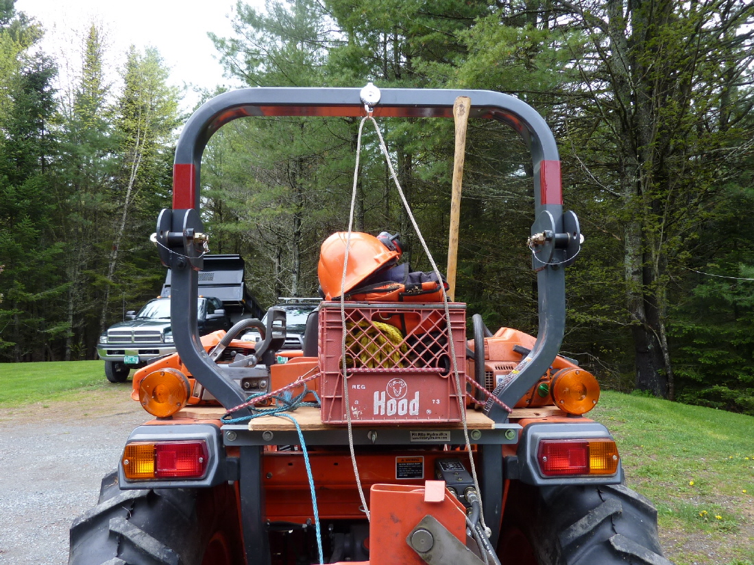

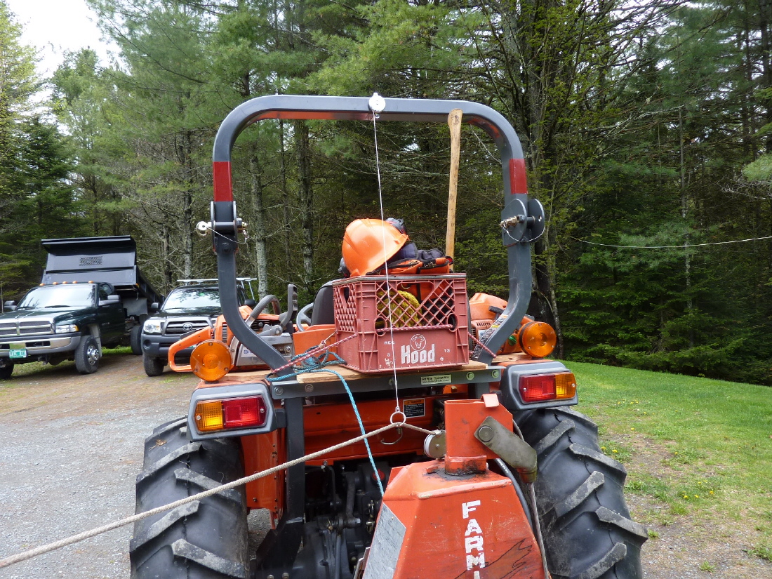

Mounted a key retractor on the ROPS to keep the winch control rope from dragging on the ground or catching under a tire when I forget to stow it properly when I readjust the tractor position.
Made some brackets to mount the cant hook on the winch where it would be easy to grab.

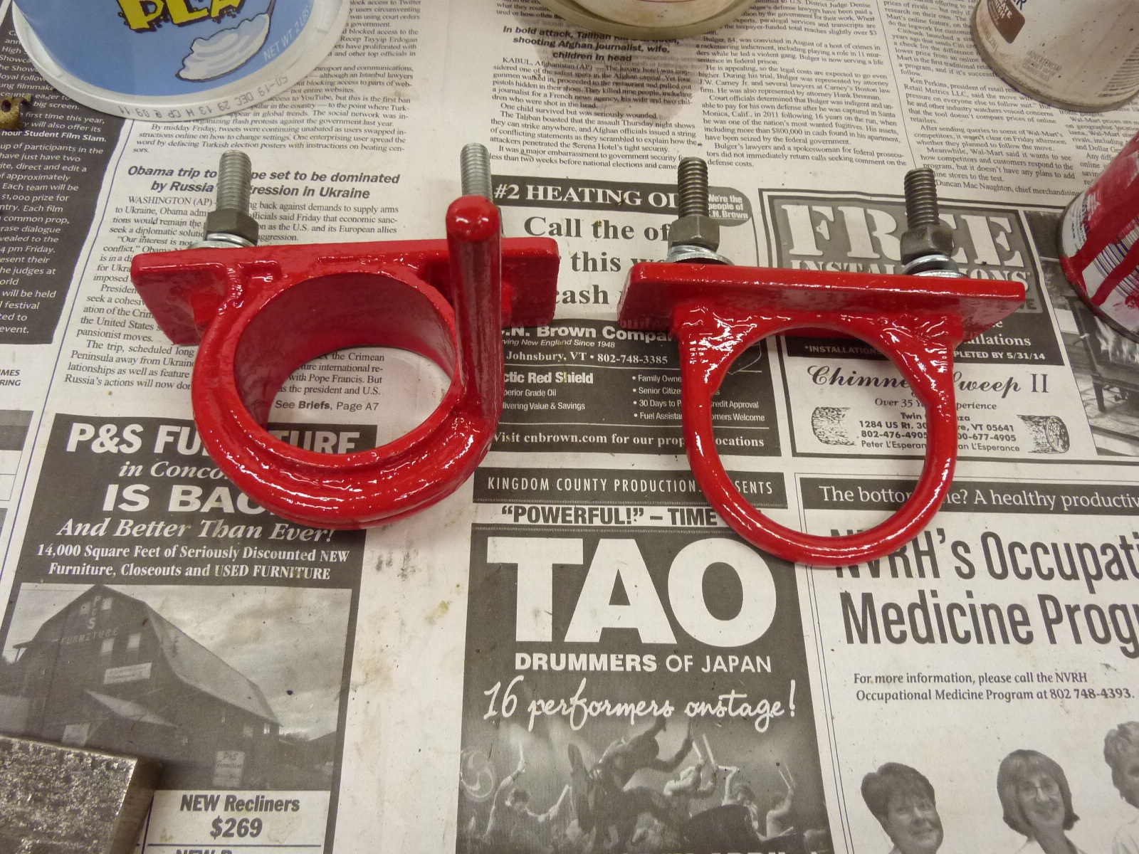

Also some bolt-on choker hanger brackets

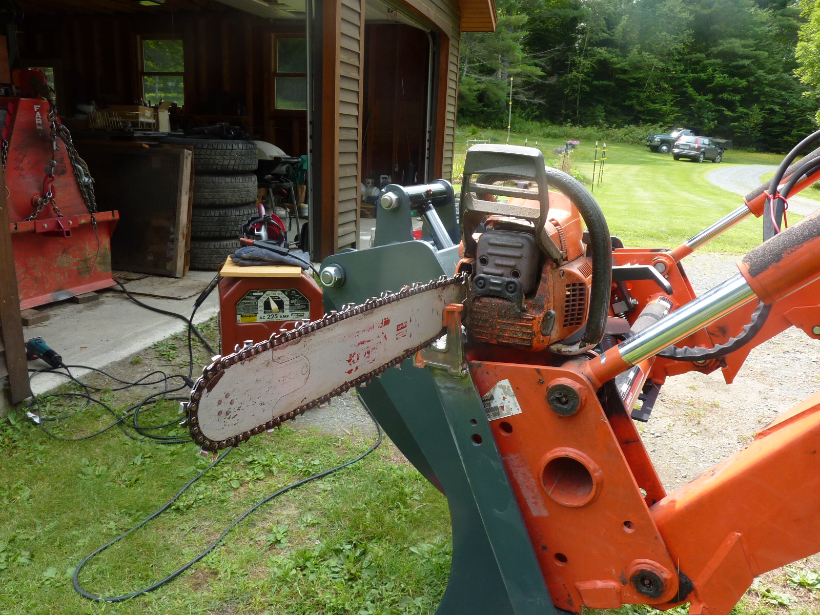

A saw vise for holding the saw while sharpening. Made from a stump vise.

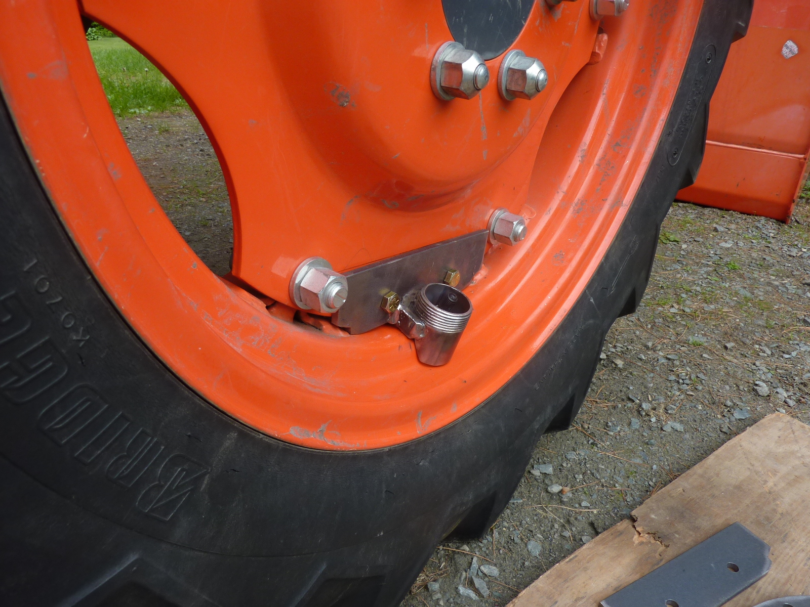

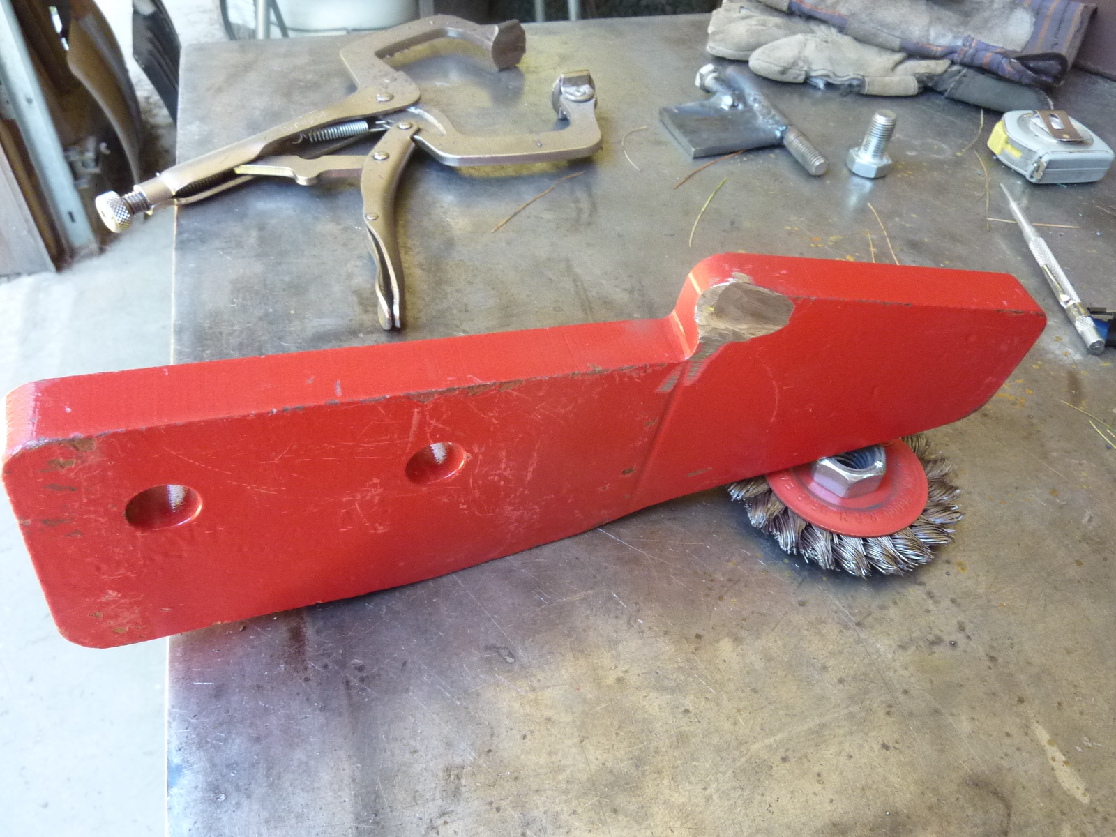

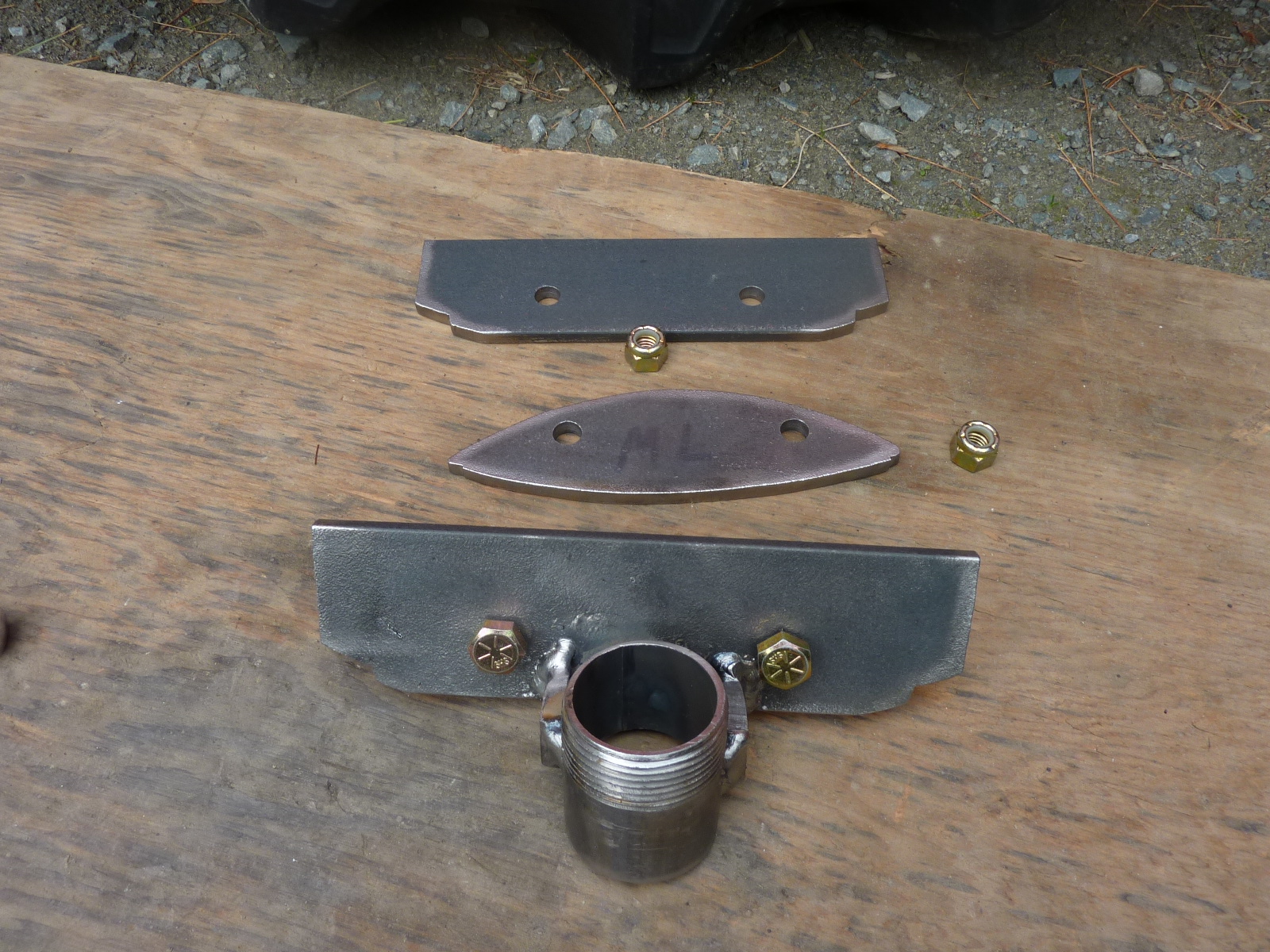

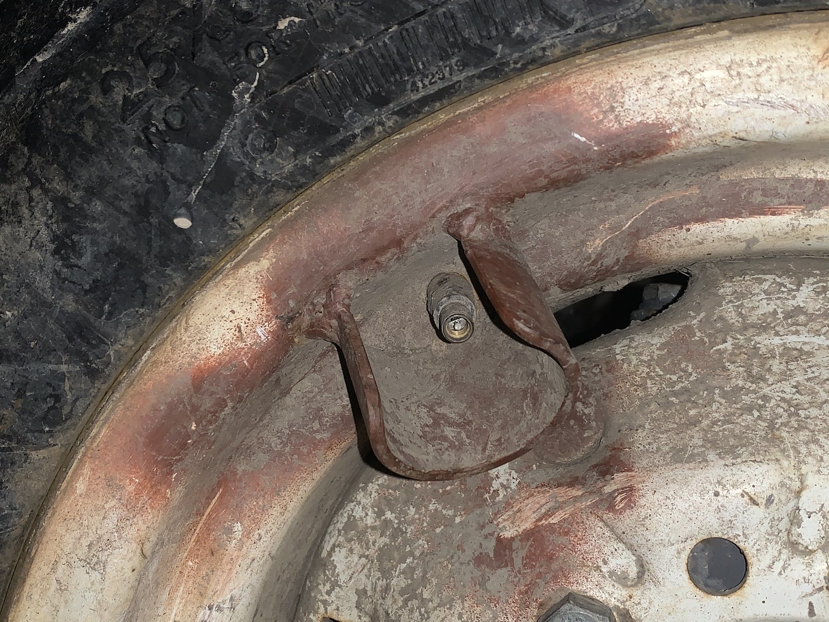

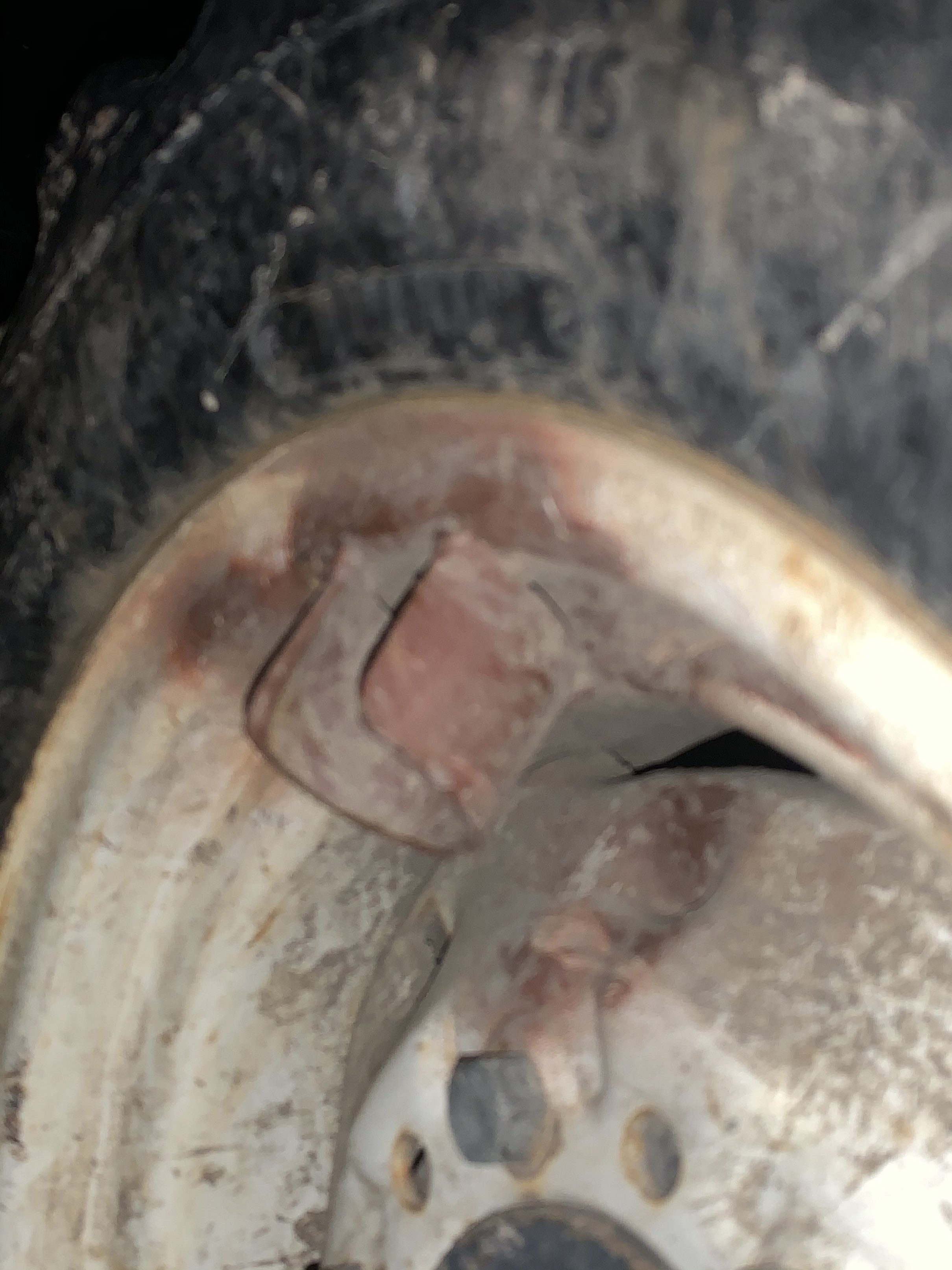

Valve stem protectors that bolt on by sandwiching the rim so I didn't have to break down the tires and weld them on.

I need to find a better place to store my chokers. Up to now, I've been putting the hooks in my safety screen, and taking up excess slack by hooking the ends on the chain grab/tow slots built in to the winch. It works well until the chain bounces out of the slots and drags on the ground - then when I back up, I tear up my guard screen when I drive over the chain end and yank on the hooks attached to the screen.
   / Forestry mods #5

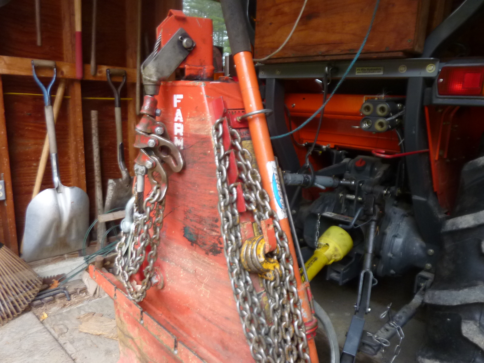

I haven't done it with this winch yet, but on my last one I cut notches into a piece of angle iron to hold the chains, then welded the angle-parallel to the ground- onto the winch frame. The ends looped over a piece of rod welded onto each side of the winch.

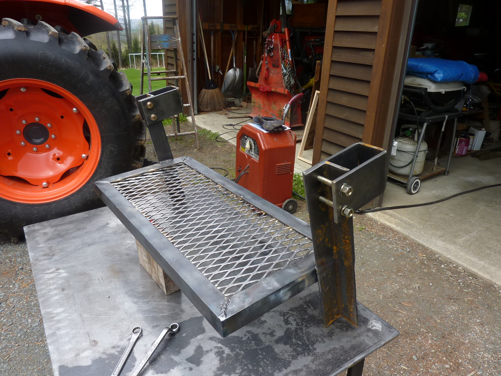

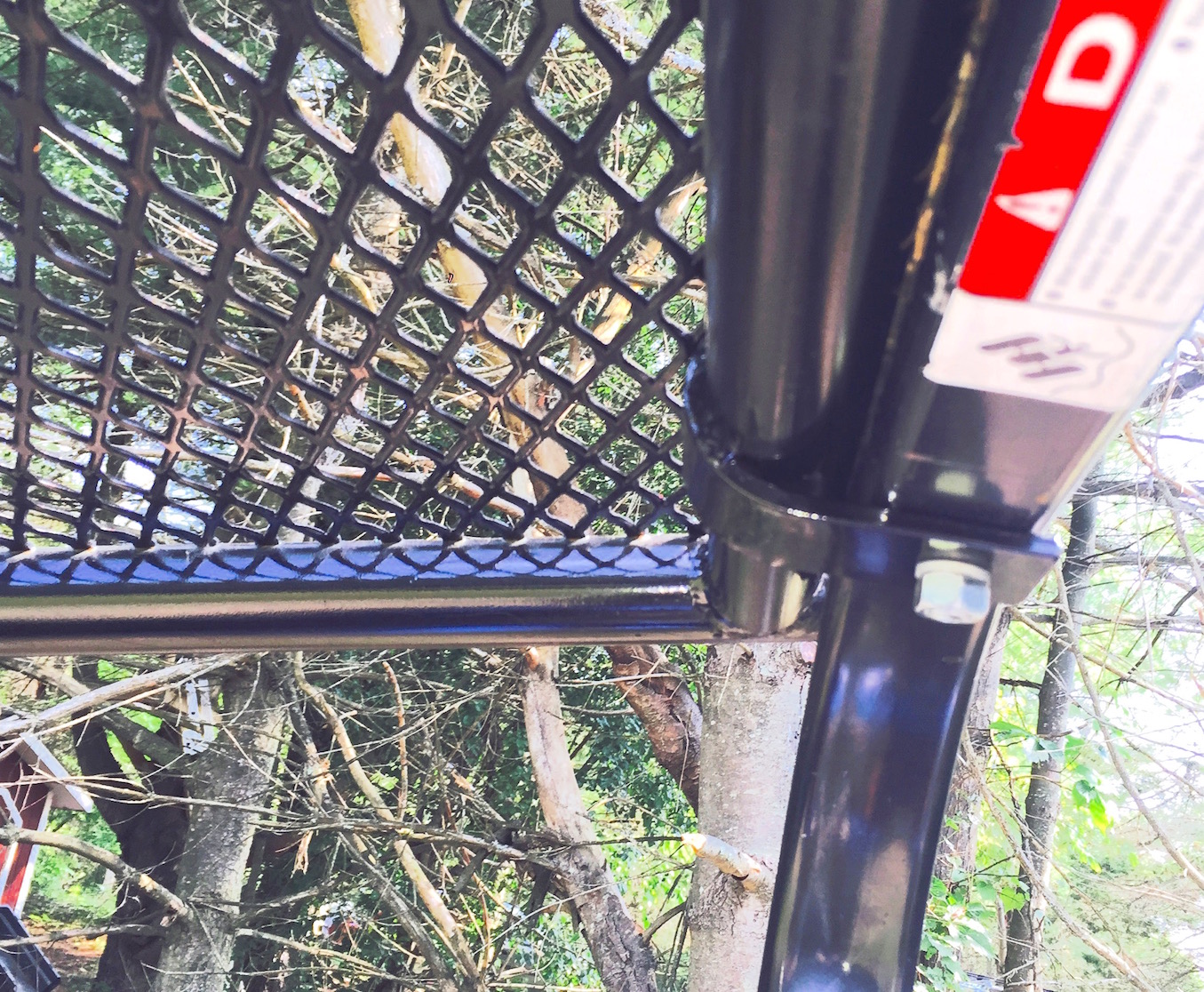

I would like to see how some of you have attached your limb risers to the existing ROPS. It's something I need to do but don't want to drill or weld on it. If you saw my welds,,, AKA "bubble gum" you would understand.
   / Forestry mods
Here are some shots of how mine is attached:
I think there were pre-drilled holes there, possibly to mount lights (I could be wrong about that. If he did drill new holes, I'm a bit bummed about that, but I'm not really worried about any adverse effect on the strength of the ROPS). However, it would not be difficult to extend the tabs further back (and maybe add a couple of bends to partially close them up behind the ROPS, then run the bolt through the overhanging part, so it clamps onto the ROPS, rather than bolting on. I thought the idea of using a round pipe for the FOPS frame (with the rounded clamp), rather than square tube was a good one: it meant not having to match up angles. He mounted the pipe to the ROPS, built up the rest, then when all was in it's final position, he welded the pipe to the bracket.

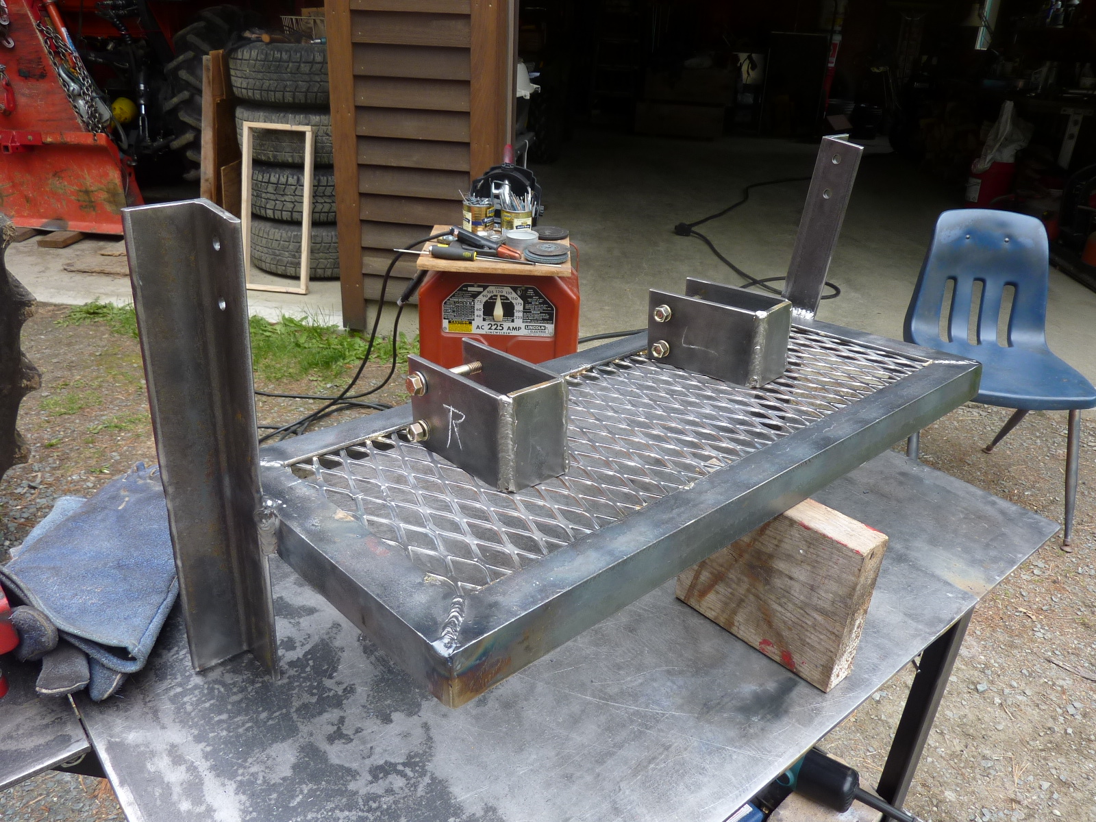

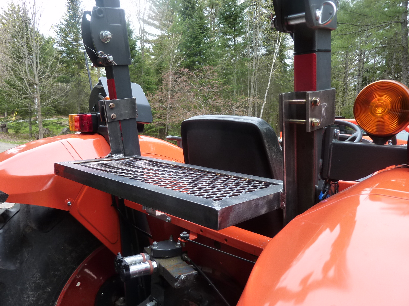

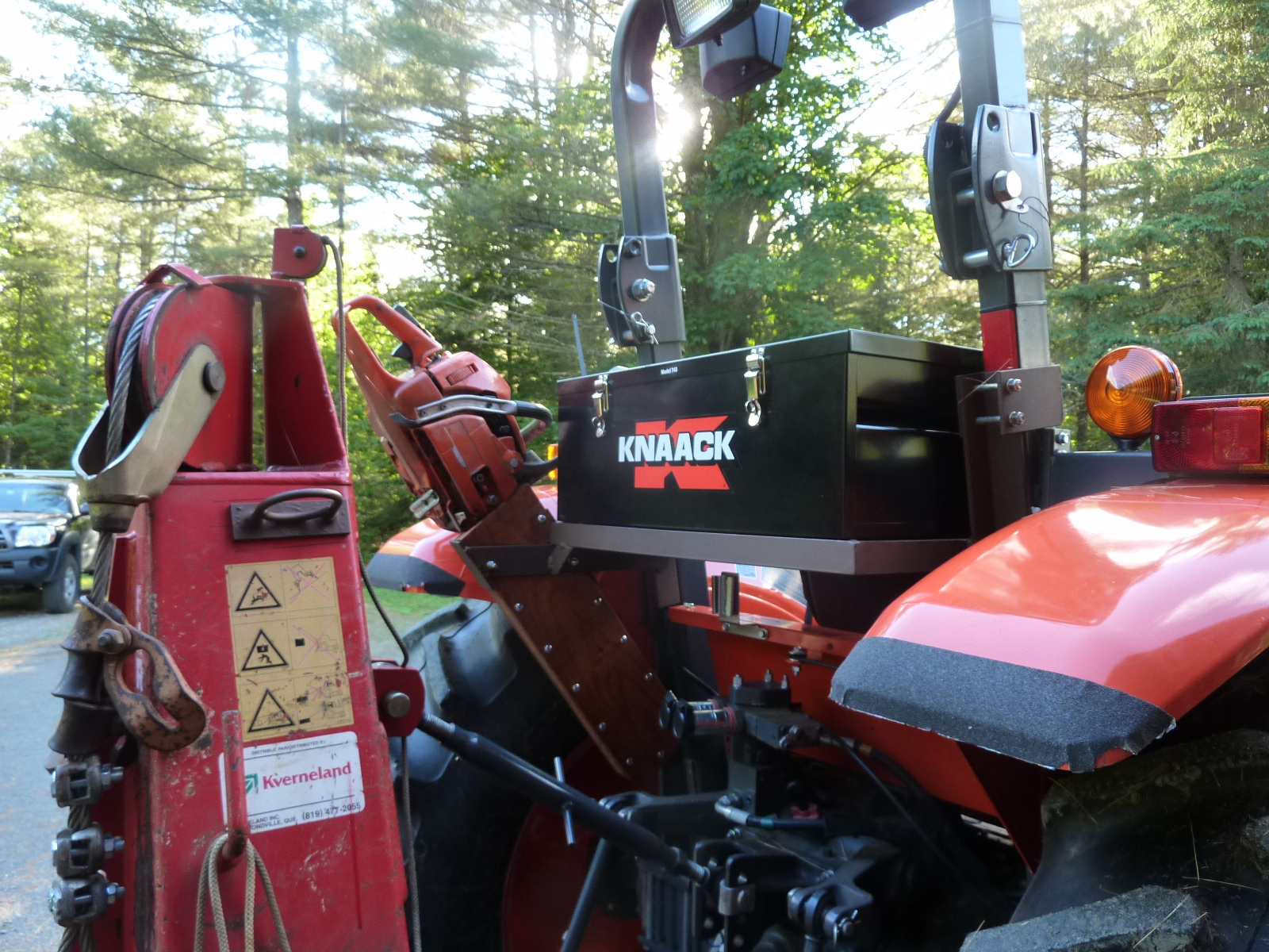

I made some ROPS clamps from 1/4" bar stock to mount a tool box rack and saw holder.

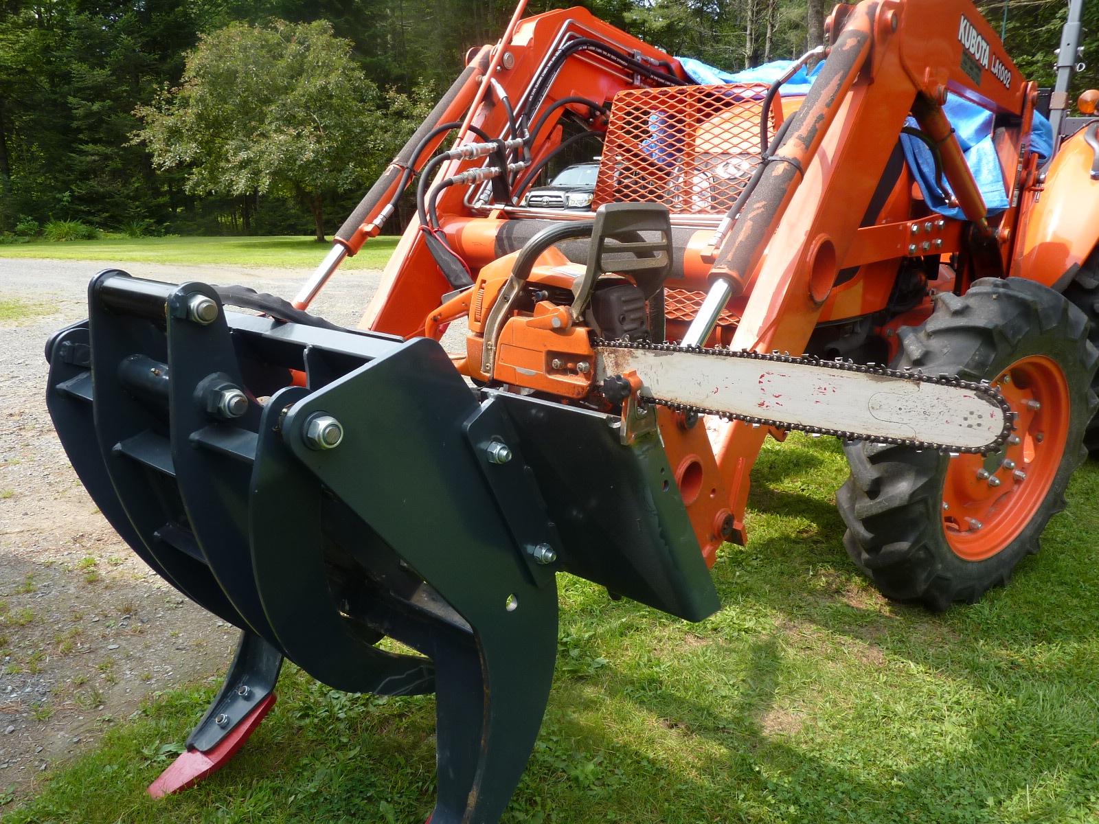

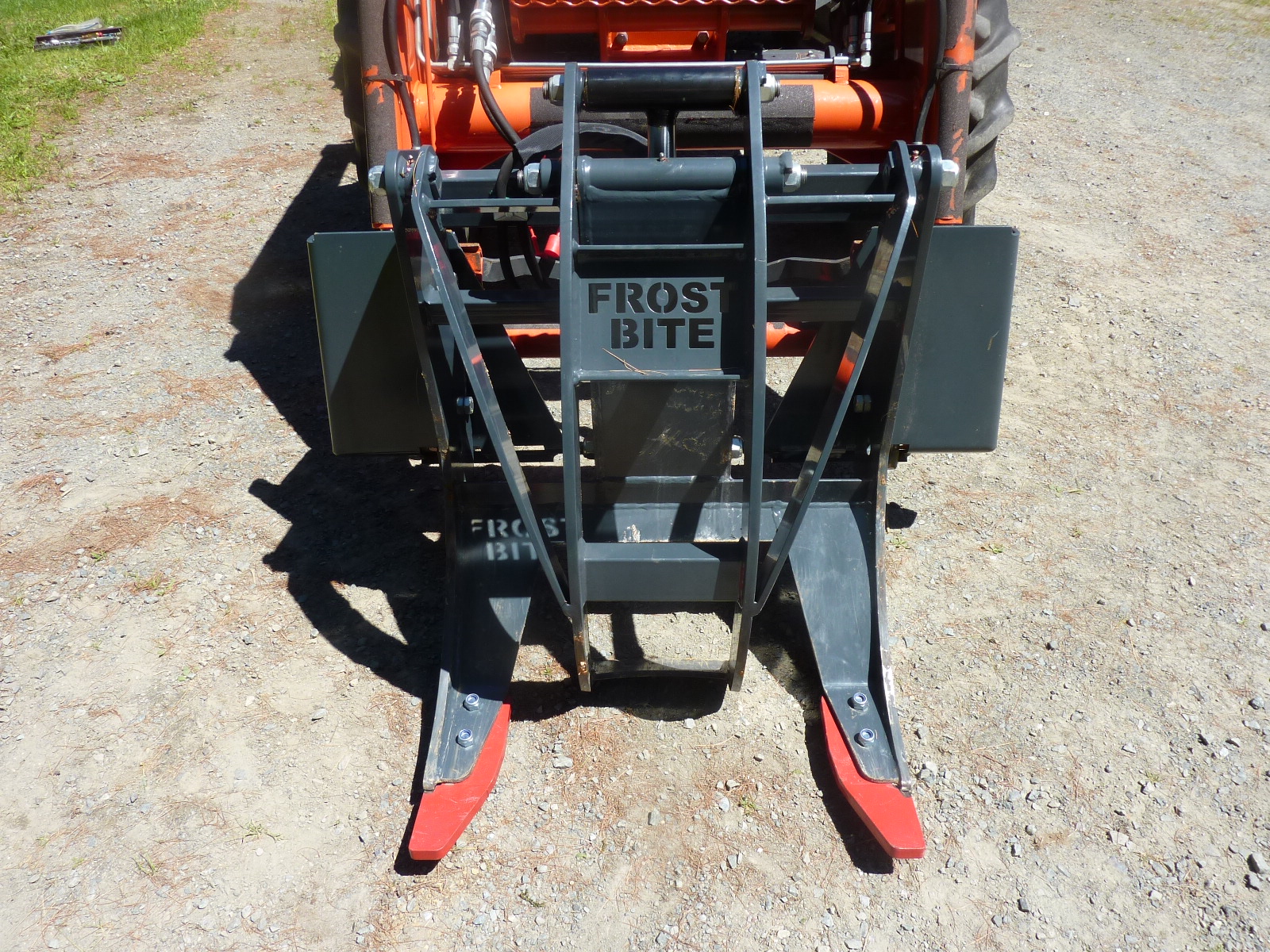

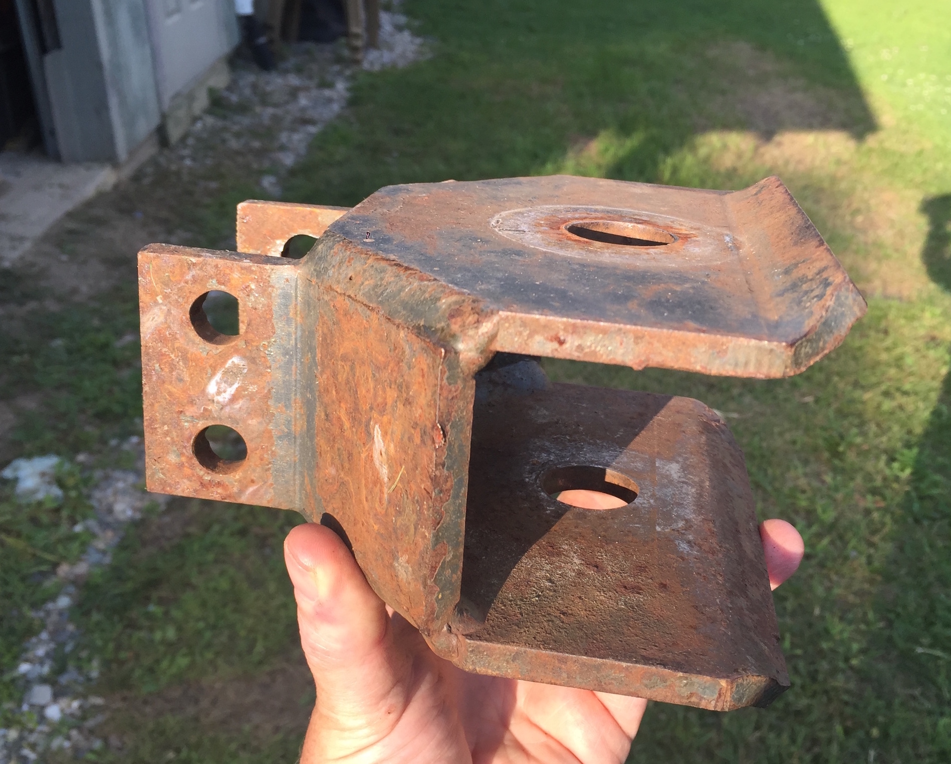

This reply is to Mr.G.G.,I have the same grapple and like those red extenders you have there. Are those custom made? Do they interfere with the bolt on rock plate?
   / Forestry mods #9
They are an option offered for the Igland GR20 grapple which is very similar to our Frost Bite. The hole spacing was perfect but I had to grind just a little as the flange on the Frost Bite is different. I don't see why the rock plate won't go on there with some longer bolts. I have not used the rock plate yet.

I can't wait to try Gordons method to protect valve stems. A couple of months ago I snapped a valve stem on a tire filled with rim guard.
Thought about trying to carefully weld something to the wheel except one tire has a tube in it.

And here's a shot of the valve stem protectors I mentioned earlier. They were made from a section of steel pipe, with one edge cut out to allow easier access by air hoses or pressure gauges. (No, that's not rust around them. One of these days, I'll get around to cleaning the mud off and painting over the primer that is on there now.)
