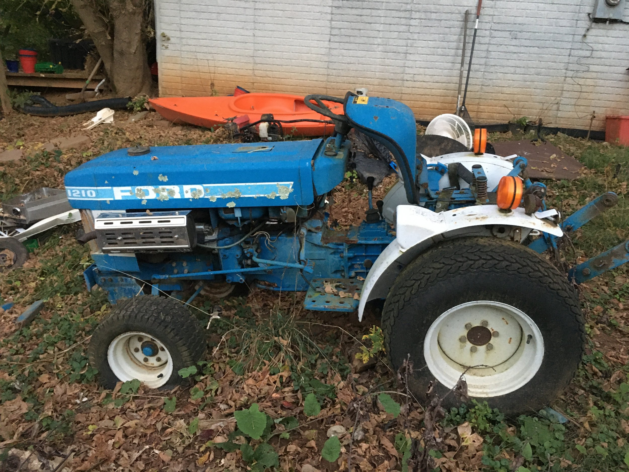

Hey guys so since it has been exactly four months I don't know if this would be better as a new thread but big update. So my neighbor turned the Ford 1210 over to me a few weeks ago and I just got it running today. I drained the engine oil and all the diesel out of it. Fresh engine oil, fresh diesel and bled the system. It took awhile but it started right up.
1.) I cannot lower the throttle all the way down without it dying. I was running out of daylight but it seemed to want to 'idle' around 1,000 rpms. This is my first time owning a tractor but it sounded a little high for idling. I did just get it running as well.
2.) I checked the battery voltage with it running and it reads 12.5 volts, so it looks like the system is not charging the battery. It looks like it could be an easy fix for this tractor.
3.) Can someone tell me if this engine is liquid or air cooled? It is sort of confusing but it definitely has what looks like a full radiator in the front with what sure looks like a traditional radiator cap. So does this thing have a water pump?
The clutch needs to be depressed to start the tractor, there are two wires connected to what looks like a safety device that must be grounded against the tractor. Both of those wires have seen better days and need some wiggling around before the starter will cooperate. Getting it running like this makes me want to keep it so badly but I cannot see myself really investing into this tractor. I see that they are pretty cool. They are definitely not a heavy piece of equipment but I see them blowing snow, tilling, mowing and lifting decent amounts with FEL's and it makes me want to invest in it so badly. I think we have been over this and the censuses is to sell it and invest in something else.

I went through what you are considering on Ford 1110 tractor. Parts are really hard to get. I replaced the hydrostat transmission, put a new clutch in it, and some other small parts. It took me several days to locate a used hydrostatic transmission. I found one in a tractor junkyard in Alabama. Cost be $1000 for the transmission. The clutch is no longer available and I had to have one custom made. That cost me $500.
It was fun but I wouldnt do it again. I sold it at a loss. It would be a cool little tractor to have if parts were readily available...but they arent.

Once again, I seem to be playing catch up on this thread. Now that it's running, I suspect that it will start to start filling the oil with fuel. That WILL ruin the engine. Thepumpguysc thinks he has a fix. I'd suggest having a conversation with him. I suspect it might fix the idle problem in the process.
When I say "talk" I mean real-time talk, not on the forum.
Meanwhile, you're figuring things out bit by bit, so have fun, learn, make some mistakes now on something that hasn't cost any great amount of money.
BTW, check the radiator and be sure there's no fuel getting in there. That will indicate another--more explensive--problem.

I would love to hear what you have to say. I have never worked on something leaking fuel internally before. I do however believe that there was fuel in the oil when I changed it. I got some of it on my hands and you could not only smell it but see it. I could literally see it filling in the smallest groves on my hands and it gave me the impression it had fuel in it. I have honestly worked on a lot of mowers and cars before but never a tractor or diesel. Just never had the opportunity before.

Yeah I have had several offers on the tractor already. Probably for many of the reasons you have pointed out. A lot of people are looking for parts and if nothing else want it as a parts tractor. Fortunately, I have only put about $250 into it so far including the $110 battery. I would like to get $1,500 out of it which I think is reasonable for a tractor that runs. I may even try to return the battery that I have had about a week now and let whoever buys it decide whether they want to put a battery on it. Having a charging system that isn't charging the battery is not going to do it any favors right now.
I do love working on things and would not mind fixing the fuel leak among other things but restoring an old tractor like this may not be worth it financially as finallydribben has pointed out. I do not think it is wise to rebuild this tractor for just myself. It has no implements with it so I would be restoring it then looking for implements. So it is more than likely that I am going to end up selling it. I would like to see it go to a good home where it could see possible use where someone is already invested in the line.

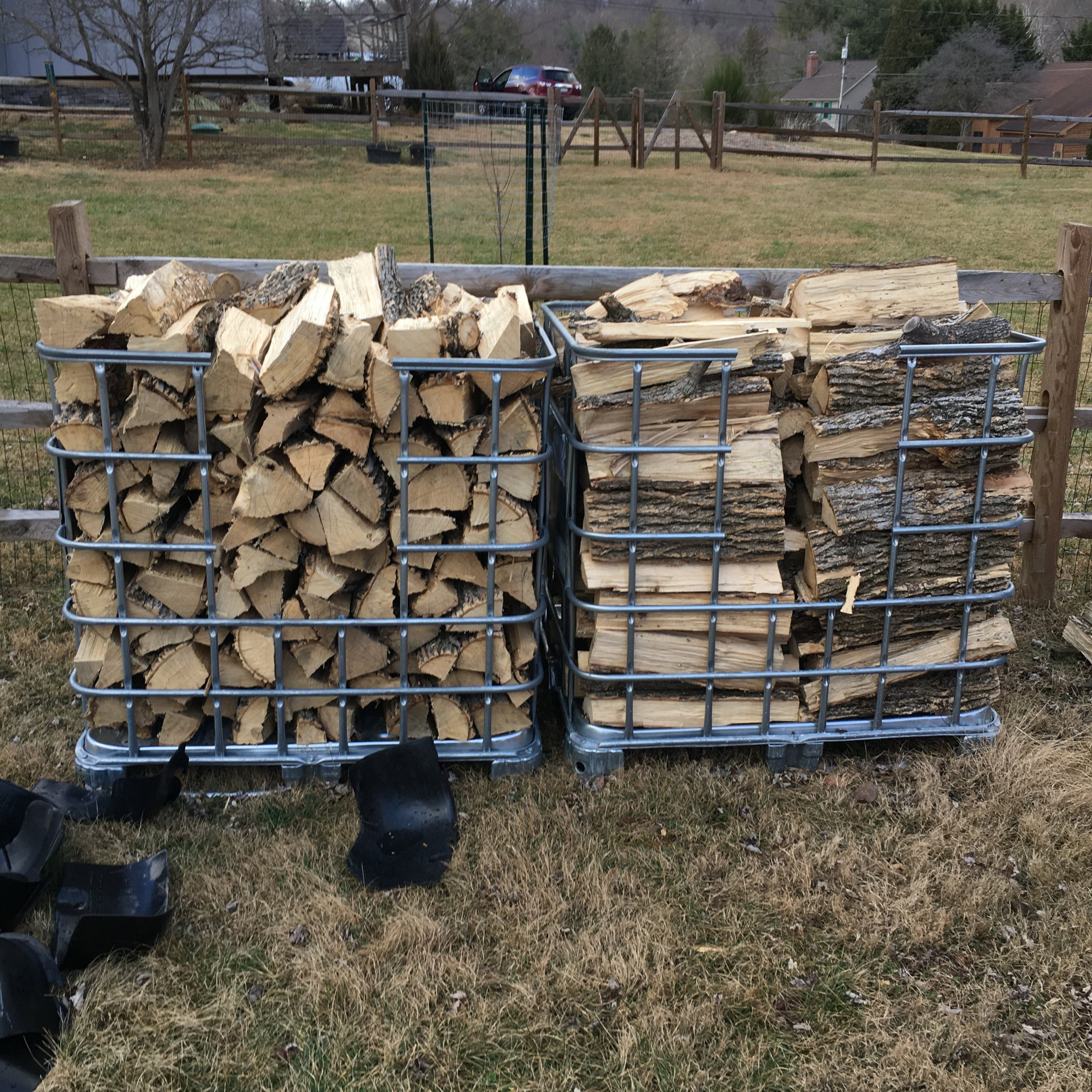

Thank you. I personally still think even the 3 point hitch is going to have trouble lifting these totes. Each one holds a 275 gallon bladder (for those not familiar) and almost exactly a face cord (1/3 cord) when neatly stacked. They can easily weigh a literal ton from my experience. Right now they have large pieces of Ash in them. However, as I said, I am not familiar with tractors whatsoever. It would be awesome if this little tractor could even get them a few inches off the ground to move about. The one in the picture is actually mine on my property and about ten feet away from the Ford 1210 ironically lol.
So a Ventrac is a special piece of equipment. They are super cool pieces of equipment that are only meant to outdo a tractor in a very niche market. For instance, they are marketed as machines that can operate on steep hills. The thing to know about them is implements are very expensive and can only be used on other Ventrac or Steiner equipment. I know what I am talking about when it comes to Ventracs lol. Bobcat is now getting into this type of market as well. The implements are front mounted but use a pulley and belt system rather than a pto or hydraulics.
Also I am looking into the fuel problem now. I was reading that the most common place for them to leak is from the injectors. So the best way to determine that is to put some die in your system and use the blacklight.

I have an old Steiner 525, (one of the largest models) out back, which was the predecessor to Ventrac. Parts for it were not cheap, which was why it got parked.A FEL on them are very, very limited, and I would not consider a Ventrac unless I was doing commercial work mowing. Never for FEL work.
A Ford 1210 is rated at 881 pounds of lift at the end of the 3 point links. Add forks extends that measurement so decreases that capacity. There are ways to adapt the totes to be able to move them, but no way is a Ford 1210 going to pick up a tote that weighs more than the tractor itself, with the stronger 3pt or the weaker FEL . Making a system to hydraulically raise the tote and just use the tractor to pull it is very doable.

I replaced my Ford 1100 with a John Deere, 2555 and built a 3 point set of forks. It would probably pick up a tote full of dry wood. I destroyed a bunch of my implements when I went from something that fit the little Ford to the 70 horsepower of the Deere.

This is exactly what I am afraid of. So my bucket list on equipment is to have something solely to mow with, like the Ferris I have now, then a Ventrac and finally a slightly larger tractor to pickup where the Ventrac falls short. This puts me in a conundrum to say the least. Because if I am buying smaller implements and decide to go with a Ventrac those implements are going to turn nearly useless for me. Especially if I get a tractor that is so much larger running smaller implements is either dangerous to the implement or not economical for the size of the tractor.
So I get called a lot for stick or brush removals. The Ventrac has an amazing scope and grapple on the front. The downside is that you cannot lift loads very high at all. Not even high enough to put onto a trailer. So I thought if I had a tractor that is a little larger with a FEL I could put those "Bucketeer" forks on it that I see advertised and easily lift piles of brush.

So I got to talk to the neighbor today and he said if he recalls correctly the tractor was leaking at the injector seals. So that may be the most likely culprit at this point. How do you go about diagnosing exactly what is wrong? From what I have seen everyone uses dye and a blacklight.

I will still consider that and have already spoken with him. I would like to diagnose what is going on with it first. He offered to rebuild the injection pump, which is expensive and I also understand. I will have to think about it more but right now I am against putting that type of money into it.
If it is something simpler I may mess around with it to get a little experience if nothing else.
