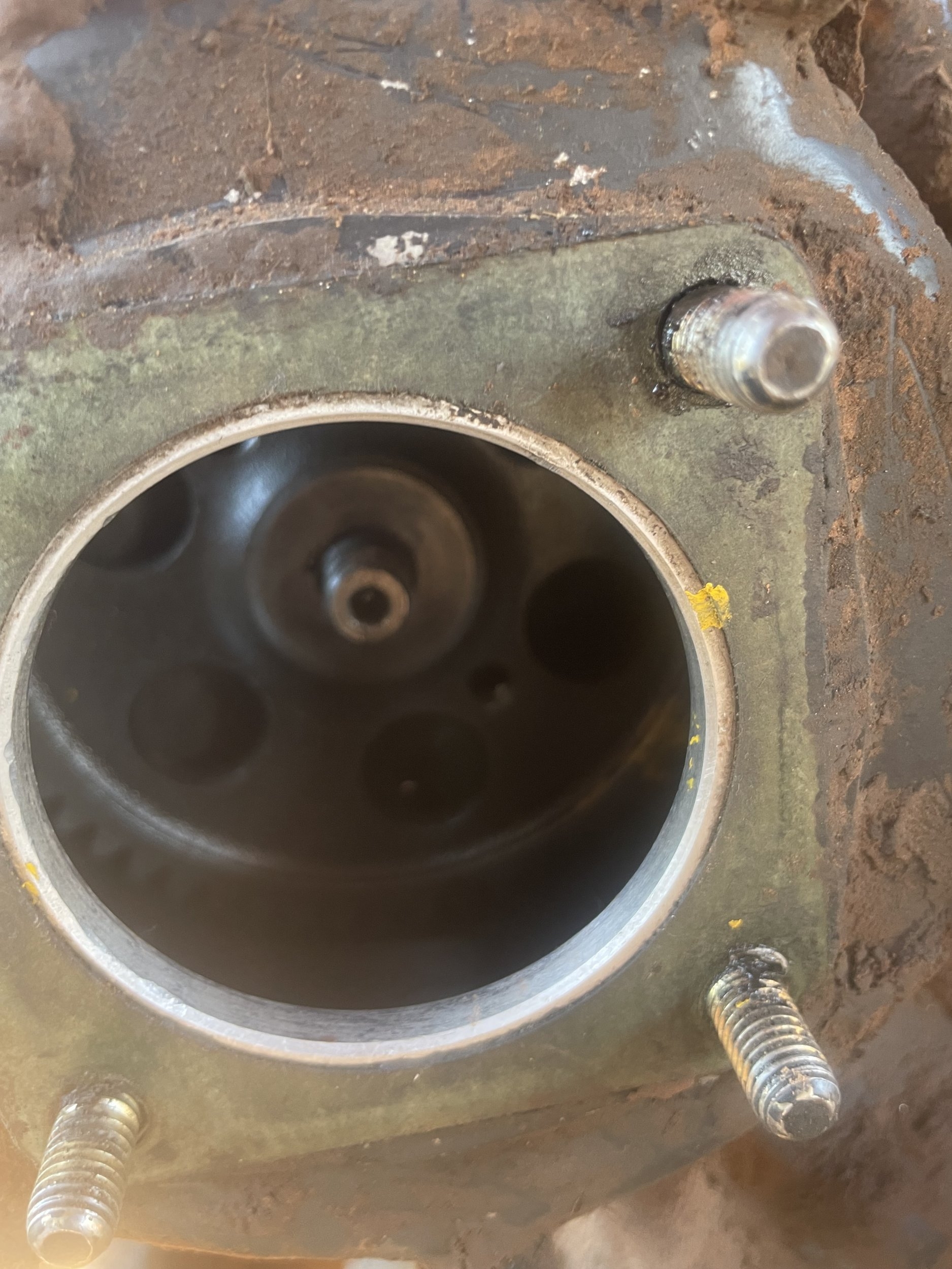

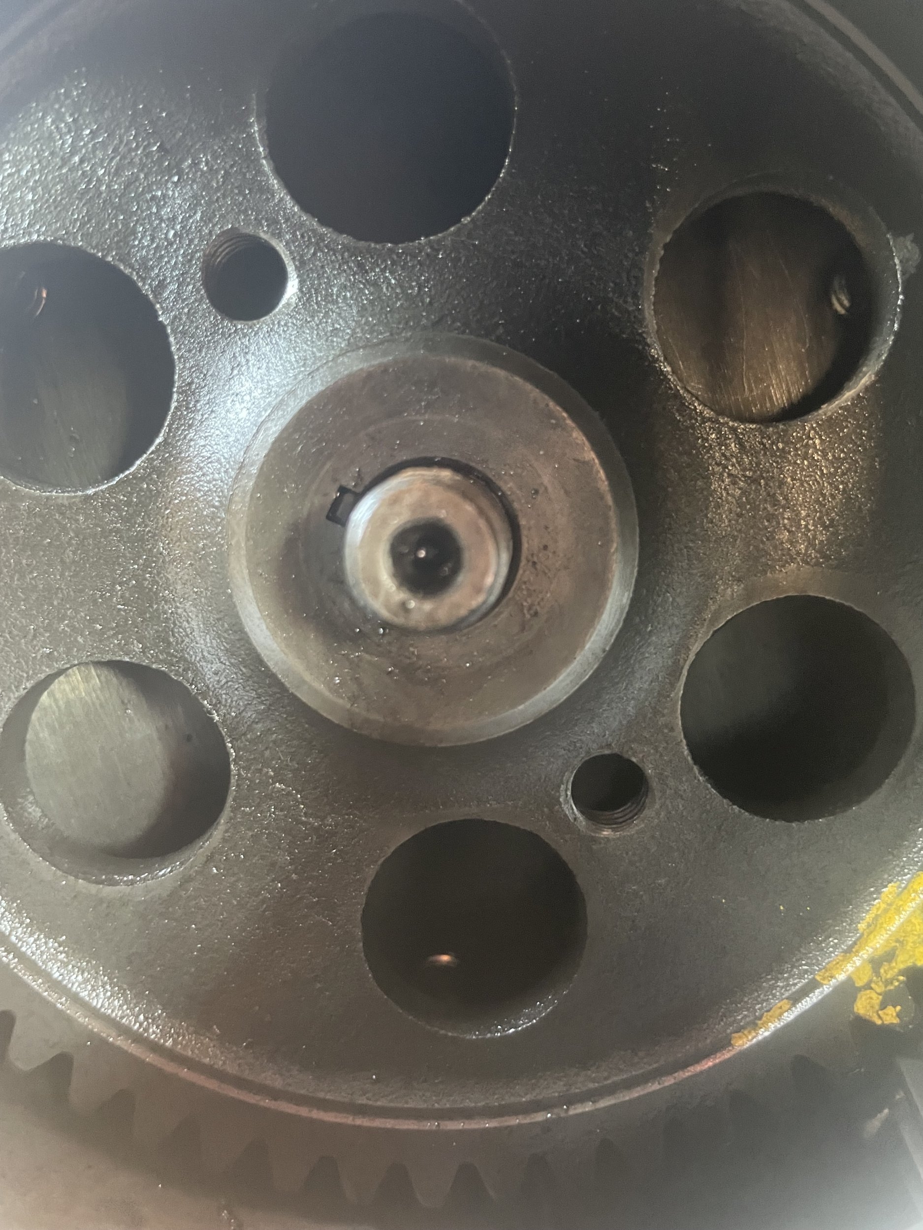

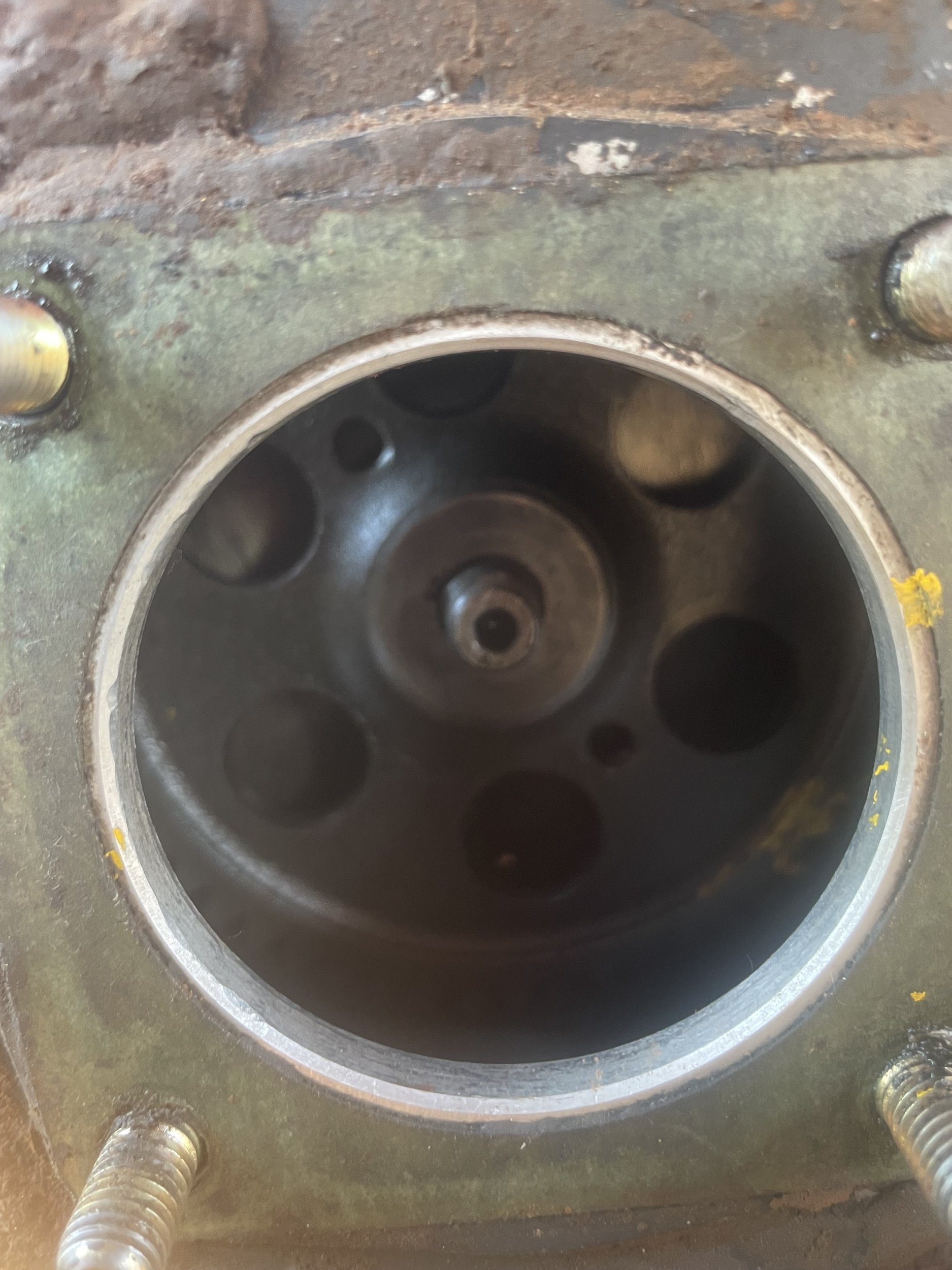

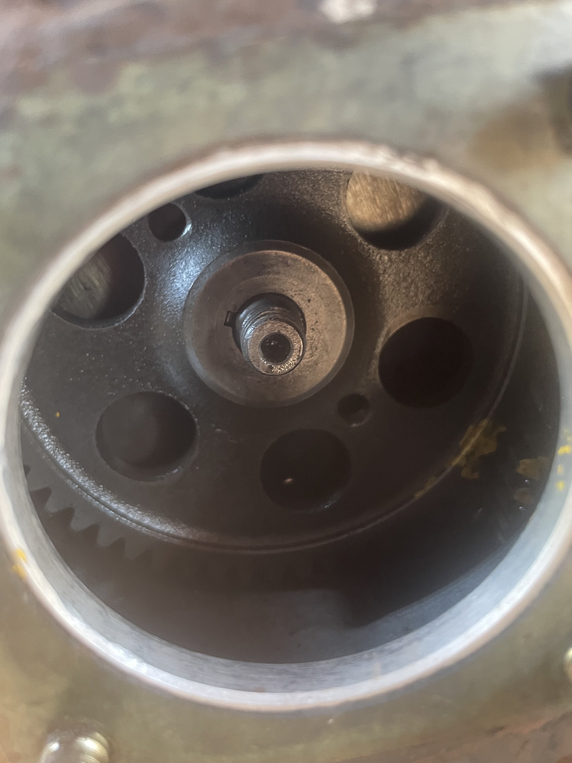

/ Fuel Pump Replacement #26
Yes the puller needed is a challenge to find , my brother has several sizes but none would work, he ordered a mini puller we try again Saturday, I am attaching pictures of the round hole puller needs to fit. If anyone knows where to purchase one please share Thank you.

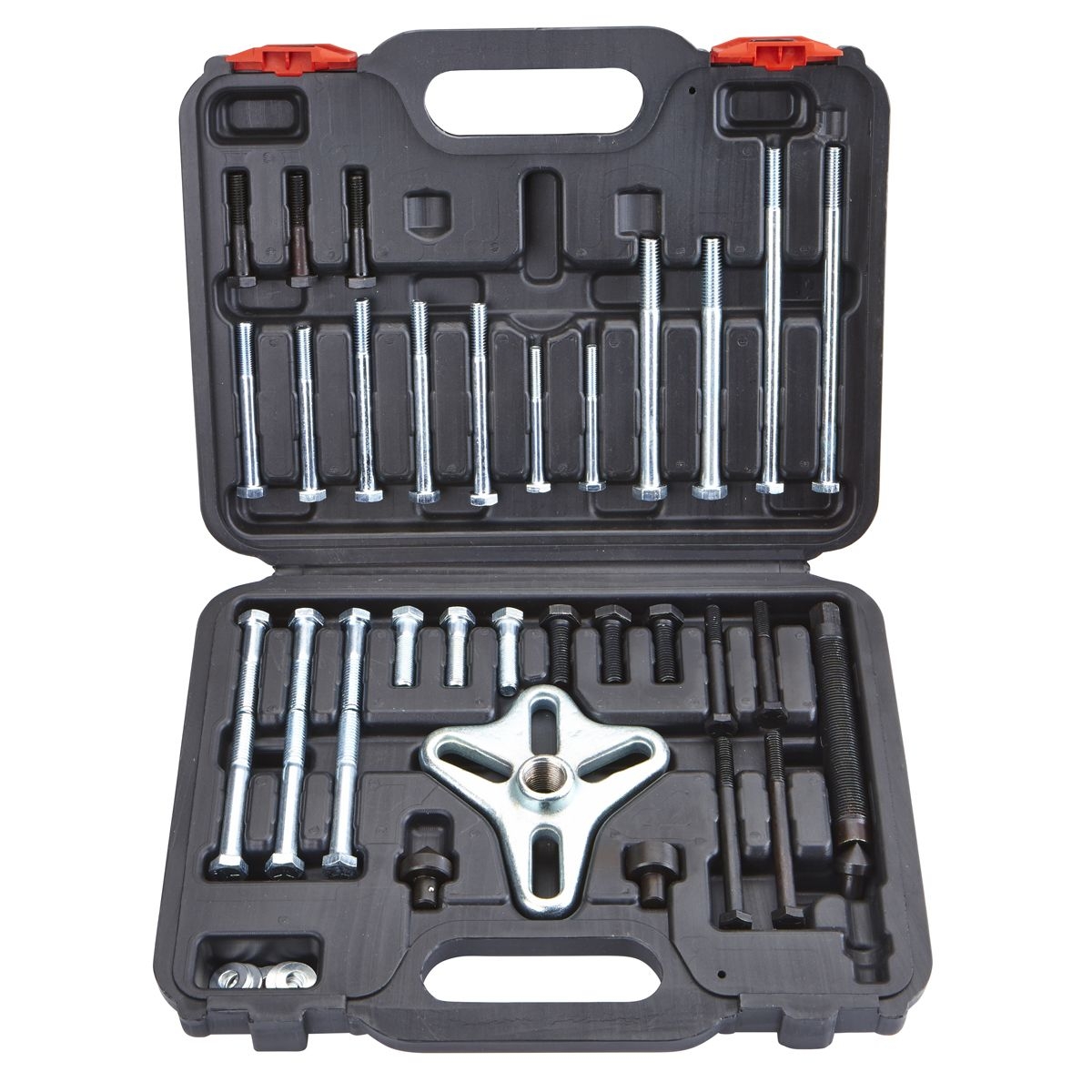

/ Fuel Pump Replacement #27
This should work. You can get it at Harbor freight or like mentioned maybe rent one from auto parts store.
/ Fuel Pump Replacement #28
The hole is 2-1/2 “ wide, bolts to fit the 2 holes on gear pump are 8mm-1.25 pitch. I ordered a puller from eBay for Bosch VE but it is for 5.9-6 Cummins engine, I have been mulling over taking my plasma cutting circle metal about 2-1/4” wide cut slots for bolts and tap and die hole for center, seems like it wouldn’t hurt to try,my brother is against me doing this, sibling chatter lol, It will take more time to ship ,repair, ship back , fuel pump and injectors, if it takes another week to find puller.
/ Fuel Pump Replacement #29
Brother has one and another set, but they are to big and bolts hit sides so they are in a bind. Puller needs to be round. Thanks
/ Fuel Pump Replacement #30
Notice in picture 1219 in attachment? Puller needs to fit in this hole and the 2 holes in the pump. The bolts when using this puller set, won’t go straight and angle in so to put puller in a bind. I went and bought 2 each 8mm-1.25 2-3" and 2-3-1/2 they weren't long enough. will keep you upated, again very thankful for all the help and suggestions.
