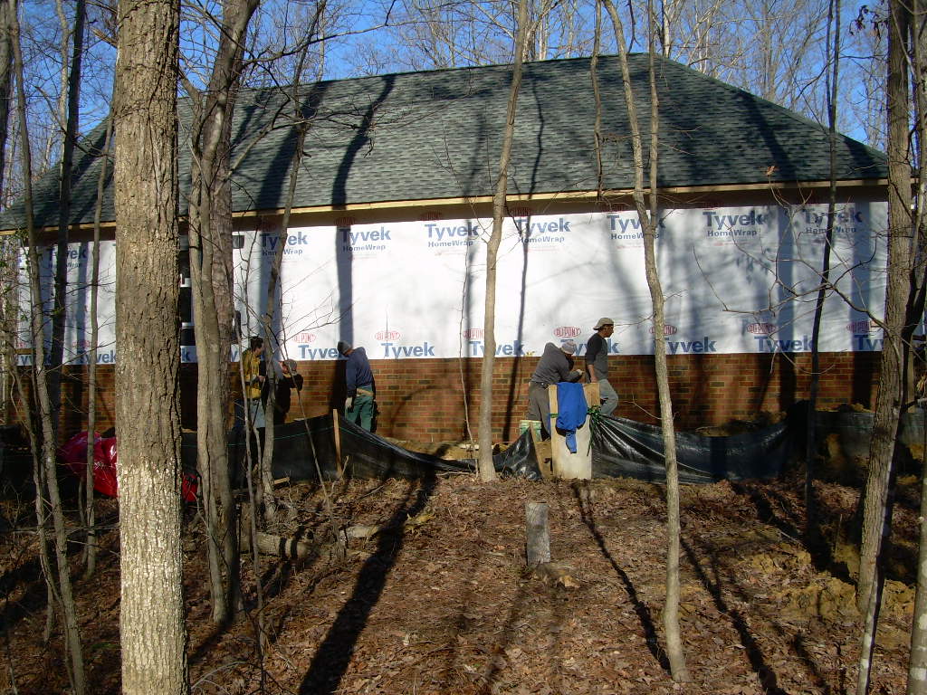

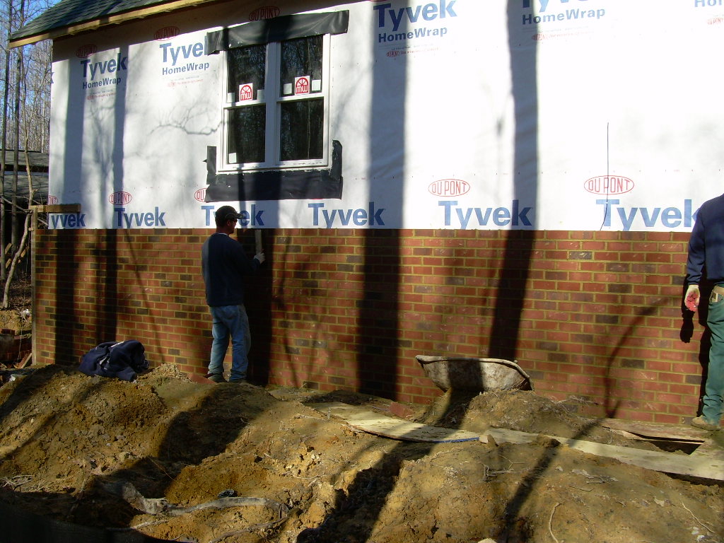

Today the brick mason's showed up. It was a small crew of 5, but they got up about 40% of the tallest and longest wall. A good start. They will probably be back Friday and some of Saturday. I expect that it will take about 5 days to do this work.
The insulation crew put R38 cellulose in the ceiling, so now I can heat. I turned on the 80,000 BTU propane heater for an hour or so and the temperature went up to 50, so hopefully the mud will dry.

   / Garage for Power Trac and Shop #128
Dear Bob,
This looks beautiful! I have to admit I was imagining functional metal siding.
How are the masons setting the courses? From your photos it looked free hand, which is pretty impressive.
Make sure your cellulose stays dry. If it gets wet, you need to replace it, since the fire retardant leaches out. Our old wood heated farm house had pulverized corn cob insulation. Cellulose, without the fire retardant!

The cellulose is in and covered, so I don't see how it could get wet.
I have not used the PT much lately. The garage is taking a lot of my energy, if not so much time lately. My old garage is so cluttered with materials that I cannot really work in it. The mason's are back today and they have brick almost all around the building to the level where they need to use scaffold. Hopefully they will do some work tomorrow and I think the weather may be good enough on Monday.
The sheet rock guys came back and said the mud was not dry enough to put on the second coat. They will be back on Monday.
