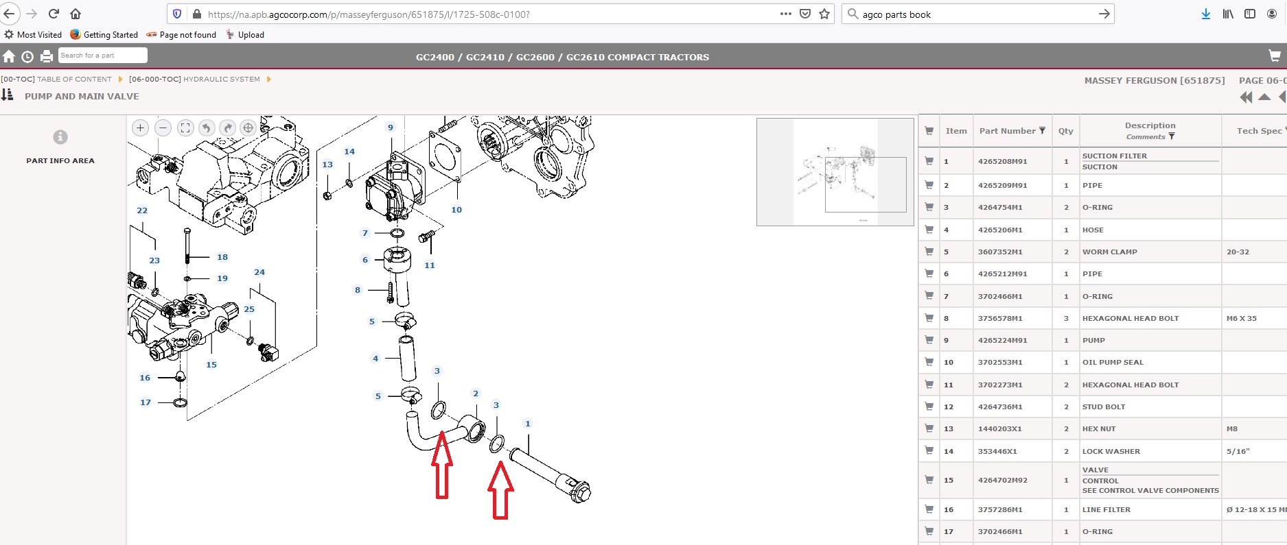

Yes there is a screen filter behind the (if sitting on tractor) left rear wheel. Some have been able to remove it without taking the tire off but its alot easier to remove the tire. Theire are step by step instructions on the Massey forum.

Take the time to take the tire off. It will make things faster and easier. When you remove the suction screen filter, note the O-rings' positions. It is very easy to forget about the inner one, or crimp it on reassembly. If you have a leak after refilling, it will be here.

Also keep in mind that the strainer assembly is plastic (at least it is on my 2310)-- be careful not to over-tighten when re-assembling; let the o-rings do their job.
