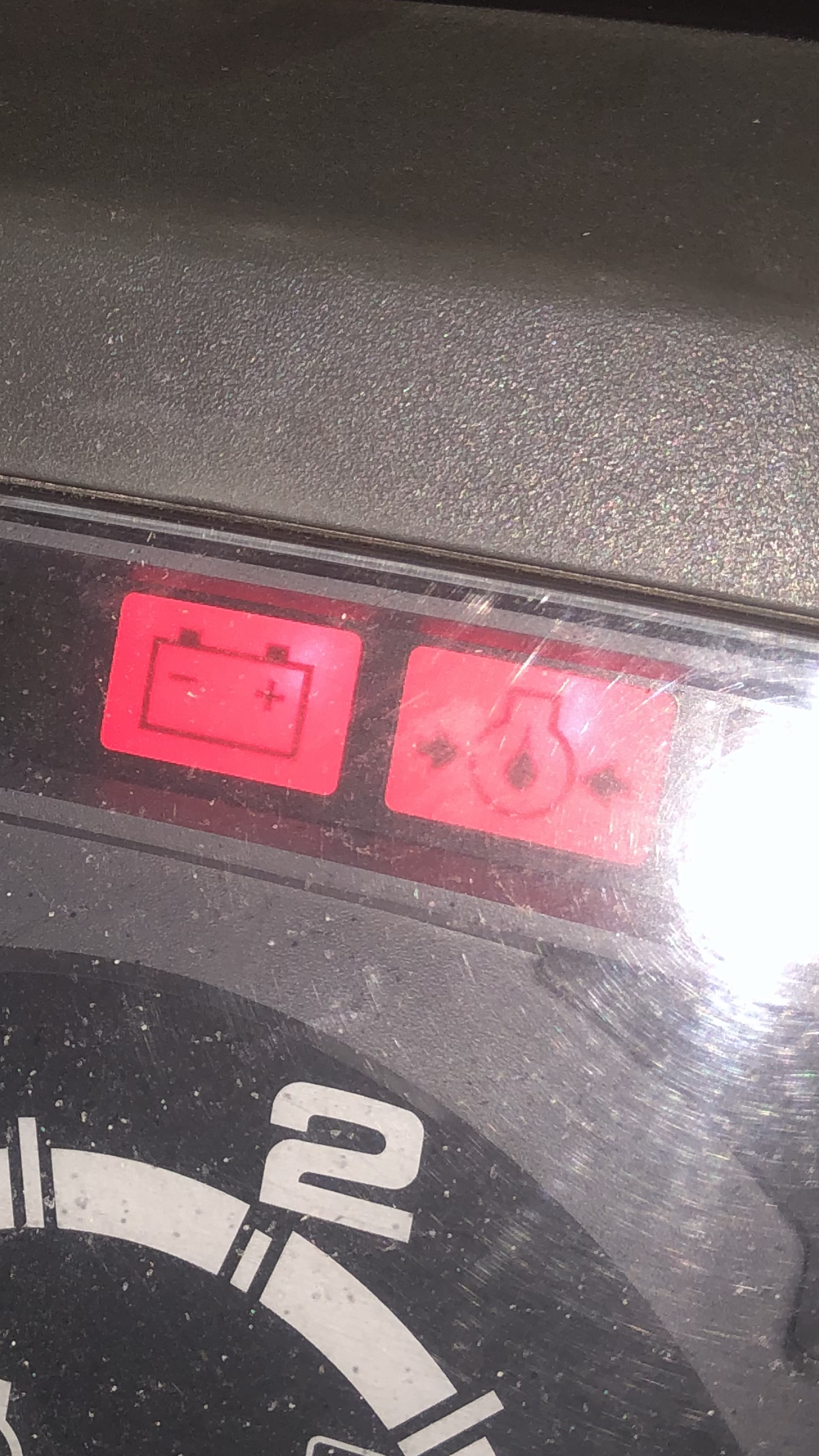

My glow plugs are activated when you turn the key between on and start, I was wondering if there was supposed to be a light.

Hey Dan,
If you desire a glow plug indicator light, like most of us, it's a real easy and cheap addition to our GC tractors.
The link to a real good thread started by ray66v, "GC Owners Upgrades And Modifications" and in ray's post #1 is this tip and how to.

I recently had a light come on that had no explanation provided in the owner's manual and the dealer had to call the factory to determine what it was. This light was located to the right hand side of the oil and battery lights and consisted of an icon of the crankcase with an arrow pointing to the right. It did not illuminate when the key was turned on before starting. I was told it was a plugged air filter warning and it did go out after I serviced the filter. This is on a 2010 GC2610TLB at about 1000 hours and I had been working it in very dusty conditions.
