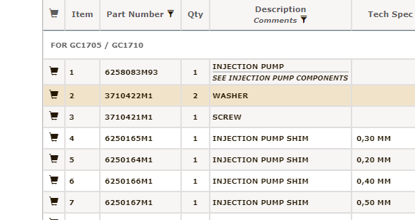

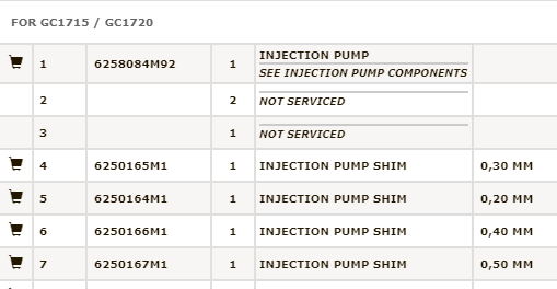

fuel shims? I see no reference to any shimming in the injector pump, delivery valves and Springs, or governor ,etc are all showing the same throughout there's no deciphering between models whatsoever. If you have anything you could post to show I would be interested and making notes of it. From what I'm seeing there's nothing that deciphers the 1723 hp from the 1725 but RPMs so I'm just going to go with that 👍
Of course there are fuel shims...go look it up in the parts book like I did and you will see different fuel shims. I have no idea where your getting your info...
In fact the 1715/1720 use a different injection pump as noted by the different part numbers

Part numbers don't always tell the story I've seen it a hundred times before . From my service manual my dealer gave me when I bought my new tractor shim's may only be need did to adjust pressure if there's a problem now I see that's for a 1710 and 1720 is that going to be different from the 23 and5 series
   / GC Series - 23 or 25 HP from the same size engine: How do they do that? #25
Fuel shims do not adjust fuel pressure...
Fuel shims adjust injector to cam timing. Which does affect power settings.

The service manual is vage, probably on purpose, for the injection pump. It's not something homeowner joe should really be messing with. Very few people understand injection pumps, to the point they should be changing fuel shims and governor screw settings.
The 25hp versions at the end of the day get more fuel (injection pump), more RPM's and different internal gearing to feed the power to the pumps and PTO. The diesel motor needs three things; air, fuel and compression. If air and compression is constant between the two versions, the only other variable to change is fuel. Pretty basic stuff.

I did notice when it comes to the 23 and the 25 vs what was posted above with the 1705 and 1720 injection pump and injectors are basically exactly the same part number with the exception to the injector pump p/n, one of the middle numbers only one digit is different and that could be nothing significant, the fuel pump shim part numbers are exactly the same also.
So maybe the difference is how the injector pump base is shimmed, and that's what I'm going to ask next time I'm there.
