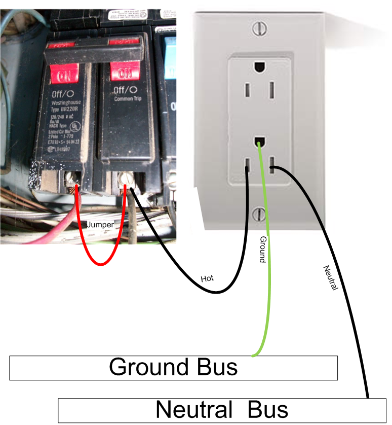

During a very close call with a Hurricane a couple of month ago, I had to fire up my Honda 6.5Kw genny.
I have 400 amp service by way of 2x200 Amp panels. I usually run extension cords to my fridge and freezer and then to a couple of power strips for some small lighting and chargers for the phones and laptops.
This works fine if only without power for a day. But I am also on well water and that means no water without power to my well pump which is 220V.
My genny has only one 240V/30Amp outlet and all the rest are 120V/20Amp.
It looked like it was going to be a while without power ( it actually ended up being 6 days) and I didn't want to pack up and go elsewhere so.... I did the back feed.
I actually took a double pole 30Amp breaker and wired my 30Amp outlet plug to the breaker where my well pump was located. I did a suicide plug using a 20amp 120V outlet to my other panel and was able to power up 1/2 of that panel.
I have natural gas to the house, so I had a gas fireplace if needed, but as a bonus, I have a Natural gas water heater. So I ended up with HOT running water.
I had some lights and my fridges and freezer were also covered too. Being a Honda, it ran fine and handled the load.
BUT.. I would LOVE to be able to energize both bus bars on the one panel that I ran the 120V/20 Amp power to.
I am extremly stingy with the circuits I would power and would like to be able to use my ceiling fans if it is hot. I know I don't have anywhere near enough power to run my A/C.
I am getting a quote from an Electrician to swap out my two existing panesl with some made by Reliance and they have a built-in generator breaker lock-outs on them.
But what is the better method if I wanted to energize both bus bars on the one panel using only the 120v line ?
Should I use two suicide plugs run into two receptacles on opposing legs, or use a jumper on a Mini breaker? I lean more towards the jumper on a Mini breaker as I do not like that suicide plug at all. Although I guess I could eleminate the suicide plug altogether and wire the 120V/20Amp into a doubel mini breaker and use a jumper for now.
I was going to originally use a jumper to engergize both legs, but I was concerned about the problem with the neutral as well. My house is only 12 years old and I do not beleive I have any shared neutrals or Multi-wire circuits. But I was concerened about the neutral imbalance problem.
From what I've read here, it seems it should not be a problem.
Anyone care to comment further about how using a jumper on a mini breaker and powering both legs of the panel using one 120v/20amp line would work... or not work... or what danger/problems I may face using that method?
Thanks for the input.
How far apart are these two panels? Are they electrically connected?
Being as you have a 240v 30 amp breaker (equal to 2 30 amp 120v breakers), if the panels are close and the neutrals are connected (ie: both panels feed off of one meter), I would get a pair of the interlock kits (such as those sold by: Generator InterLock Kit - Kit Selection), run a line from your generator location to the 30 amp interlocked breaker on each panel and shut down the unneeded breakers in each panel.
~$300-500 for parts and you are good to go.
If you have 240v available from your generator DO NOT MESS WITH CONNECTING THE PHASES. It isn't worth it.

I'm the OP of this thread and here it what I did.
Originally I just moved a few circuit breakers to the 1 live side of the panel. I got pretty much the essentials on the one 120v circuit.
Recently...I found a great deal on a new 240v / 6500w (running) generator. I now back feed through a 60 foot 10 AWG cord to the clothes dryer plug with a suicide cord.
I tried it out the other day and it works great! Transfer switches are the legal way but economically I can't do that. $800 for a moron switch...can't do it. My procedures are written out... tags are used and nobody but me touches it.

With your two panels and the availability of a 240v 30 amp plug on your generator, I'd buy a Gentran box and add it next to the service panels. Less than $300, easy to install, legal and foolproof. It gives you ten circuits including 220 v for a well, etc.

Aaron,
They are side by side and fed thru only one meter.
The "InterLockkit" lockout are not code approved in my jurisdiction since they are not UL approved. Read their fine print and they say "Tested to UL standards" but they are not UL approved. That's why I plan to have those new panels with the interlocks built in installed.
Gentran Corporation: Generator Transfer switches for home & business
That's what I want to avoid.. I don't want a sub-panel... I want the ability to pick and choose which circuits I want.

The "InterLockkit" lockout are not code approved i my jurisdiction since they are not UL approved. Read their fine print and they say "Tested to UL standard" but they are not UL approved. That's why I plan to have those new panels with the interlocks built in installed.
Gotta love lawyers.
That makes sense for your situation.

I see. Sounds like you need a transfer switch located between the meter and the two panels. It is certainly doable, but more expensive.
   / Generators - Backfeeding - 120V #75
Hi Travelover.
I was planning on something easier and just as cheap. I have talked to an electrician about install new panels. They are the Reliance 200 Amp panels with a "Built-In" generator lockout.
Here is a link:
TTV2005C Panel/Link | Product Details | Reliance Controls Corporation
The electrician said this would not be any more expensive than putting in sub-panels, transfer switches, total breakers etc.
He would wire up an inlet plug for each panel and all I need to do is plug in the generator and pick and chose which circuits "I" want.
