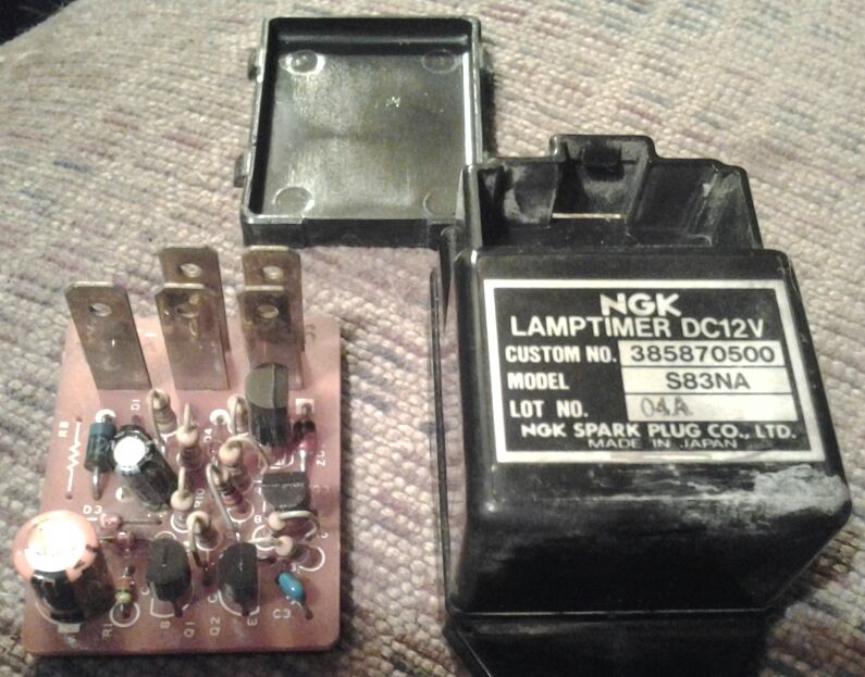

The glow plug indicator lamp on my New Holland TC35 Boomer would occasionally come on, and now it just stays on.
According to the helpful threads in this forum, the cause is a faulty glow plug timer unit:
http://www.tractorbynet.com/forums/new-holland-owning-operating/110076-glow-plug-problem.html
Pulled the unit, bench tested it per this procedure, and sure 'nuff, it's bad.

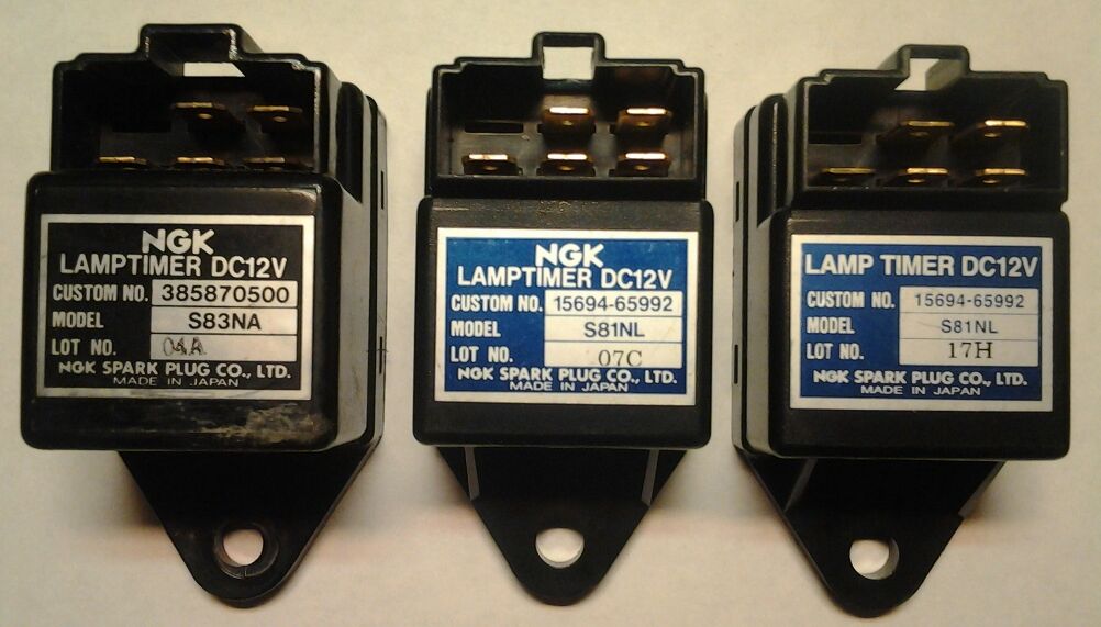

The replacement timer was going to run me close to $120 from the local dealer.
So, I opted to get a couple of the Kubota timers off eBay, for $35.
Now I've got 3 timers.
/ Glow Plug Timer control units
Let's see what's going on in here.
The boxes are easy to open, just pry off the back.
This is where the surprises appear. The printed circuit boards inside the boxes are all different.
The board inside my original timer box doesn't even match the model number labeled on the box.
This is what I found:
New Holland P/N SBA385870500 Model# S83NA, Lot#04A - contains S81NF-1
Kubota P/N 15694-65992 Model # S81NL, Lot#07C - contains S81NL-1
Kubota P/N 15694-65992 Model # S81NL, Lot#17H - contains S81NL-2
The Kubota timers are supposedly interchangeable with New Holland's SBA385870301, the faster timer.
Why my box has a different board, I haven't a clue.

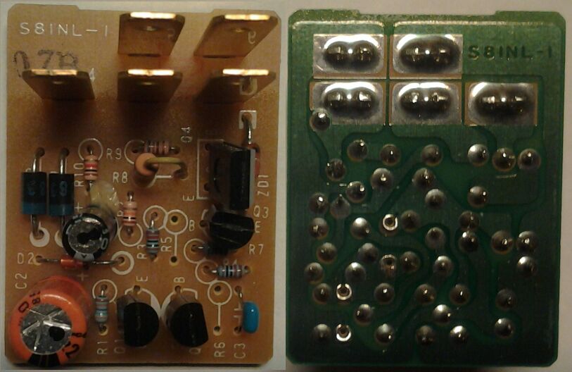

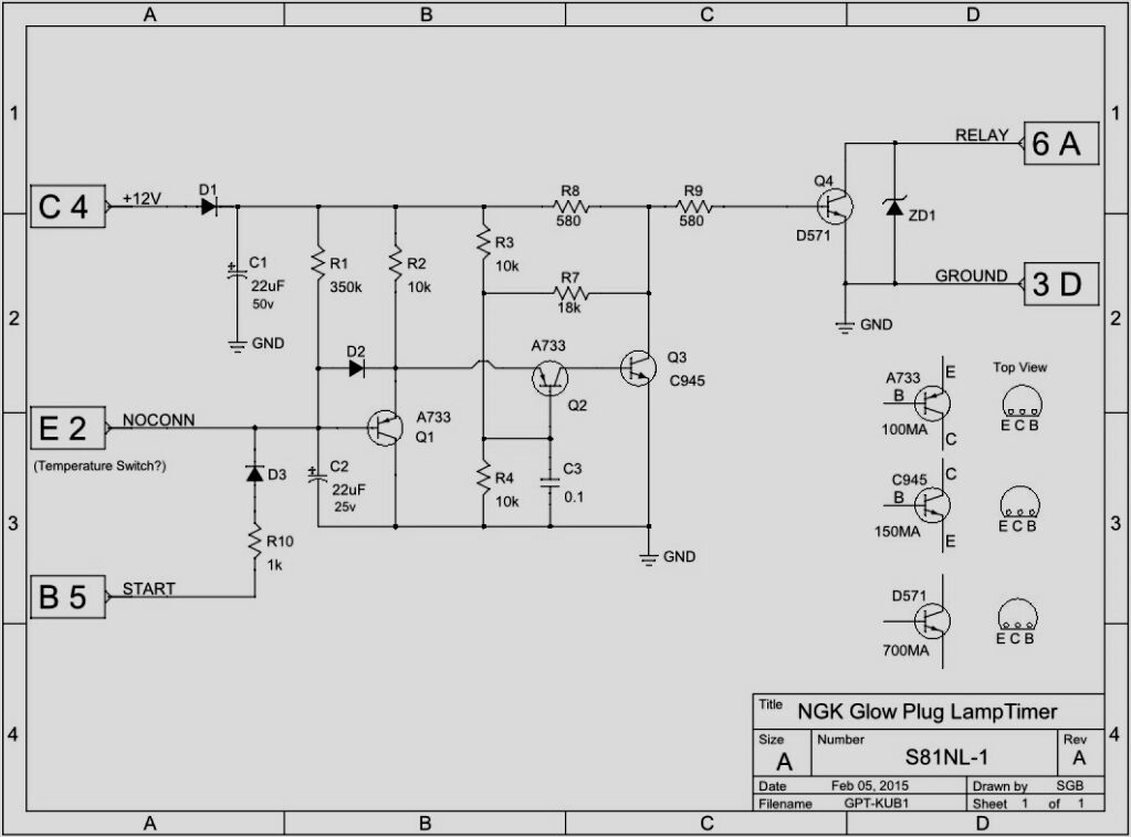

This is what the NGK S81NL-1 LampTimer PCB looks like:
(For the Kubota)
This is the NGK S81NL-1 LampTimer circuit schematic:
General description:
The NGK S81NL-1 LampTimer is quite similar to the previous NGK S81NF-1, with a few differences:
1. The timers R1/C2 are different, a faster timebase. C2 is now rated for 25v.
2. Some of the designators for the resistors have changed, not important here.
3. The R8/R9 current control resistors are much smaller, Q3 will need to sink about 20mA now.
4. Driver transistor Q4 is now a regular NPN, with half the current rating. Still enuff though.
5. Big difference is the 'start' circuit. This one doesn't turn on the glow plugs during start.
Bench test:
Ran the lamp test on the unit, found that it stays on for 6 seconds.
Then the lamp flickers rapidly for another 1-2 seconds before staying off???
This could wreak havoc on the glow plug power relay, needs further investigation...

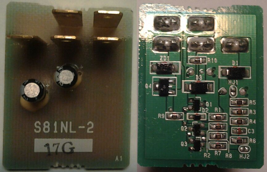

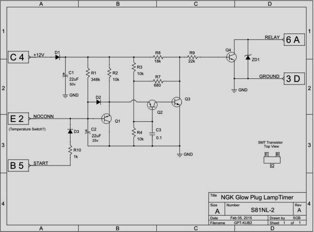

This is what the NGK S81NL-2 LampTimer PCB looks like:
(For the Kubota)
This is the NGK S81NL-2 LampTimer circuit schematic:
This NGK S81NL-2 LampTimer is functionally similar to the previous NGK S81NL-1, with some big differences:
1. The Printed Circuit Board now uses Surface Mount technology. Harder to fix.
2. As such, only the resistor values can be read. No discernable markings for the diodes and transistors.
3. The designators for the components are the same. Handy, but not important here.
4. The R8/R9 current control resistors are now much larger, Q3 won't need to sink as much current now.
5. The latch drain resistor R7 is much smaller now. Q2's base will be aggressively pulled low.
Bench test:
Ran the lamp test on the unit, found that it stays on for 5 seconds.
The lamp goes out quickly without any flickering.

Hey guys, thanx so much for your interest and comments. Wasn't sure how this would be received, but I knew there were plenty of fix-it-yerself folks on here. DFB, yeah, kinda figured that there were other/different configuratons of glow plug timers out there. Hope this thread helps others diagnosing all those other types.
The saga continues:
Examining and probing my original NGK S81NF-1 LampTimer showed that the suspect capacitor C2 is okay.
The problem turned out to be the latch section transistors Q2 & Q3 failed. Will try fixing later.
So, I decided to use the new NGK S81NL-1 for my tractor.
But, I wanted to extend the 'on' time a little, and get rid of that flickering problem.
Replacing the timer resistor R1, from a 390k to a 560k, extended the 'on' time to 9 seconds.
Replacing latch resistor R7, from an 18k to a 10k, got rid of that unstable flickering.
During probing, I noticed that the voltage of the single connection between latch transistors Q2's collector and Q3's base would drop to around -3v to -4v during the initial delayed 'on' time. I don't like this. Having the base of an NPN transistor going to a lower voltage than its emitter isn't good. So, I decided to protect Q3 by adding a 1N914 diode between that line and ground. It still goes negative, by a small fraction of a volt, but stays well within NPN transistor safety margins.
I'm familiar with emitter-follower and darlington configurations, but this is the first time I've seen this collector-base setup.
Maybe this is why these things fail so much.
This is what the MODIFIED NGK S81NL-1 LampTimer PCB looks like:
(old/replaced resistors at bottom of picture)
This is the MODIFIED NGK S81NL-1 LampTimer circuit schematic:
(Annotations in red)
