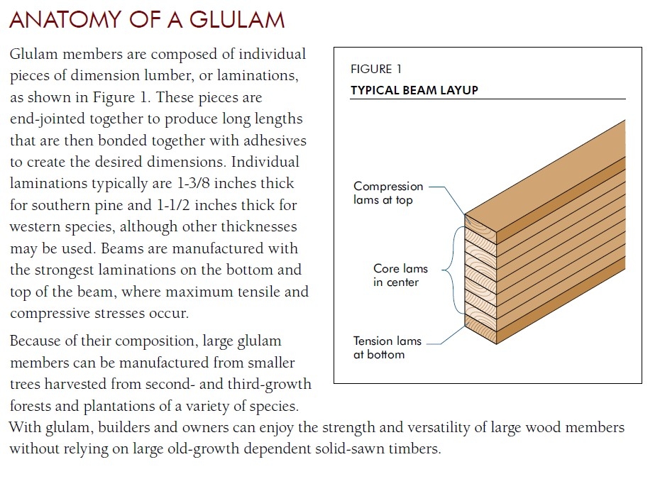

Besides, I don't like that anatomy figure. They act like a gluelam has seperate areas of function. It's one big beam that is all glued under pressure. It acts like one piece of wood. There are no slipper plates to divide the beam into different areas of forces.
I get over-simplication for comprehension, but that is bad.

Its a simple beam. Bottom in tension, top in compression. No if's ands or but's about it.

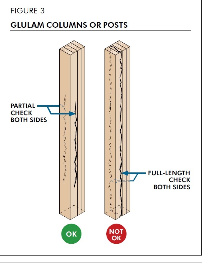

It looks to me like you have the situation in picture labeled OK, but I would be worried that it was heading towards the NOT Ok.

The design engineer said that the beams were "oversized" by about 70%. The glulams sit inside concrete beam pockets on the concrete wall.
The glulam engineer said the repair might include 10" + timber bolts run through the bottom of the beam, possibly an epoxy being injected. More info coming this week. They also said the checking typically is not a structural issue unless it goes ½ to full way through the width of the beam. The rest appears to be standard checking. Seasonal checking in the wood fiber is a release of internal stresses caused by the drying process.
Supposedly deeper beams check more than shallow beams due to the higher grade material which is more dense and could hold onto moisture longer than the less dense material at the center. As the higher grade dries, especially if it is rapid, the tighter wood grain will pull away from the cores wider wood grains. There is more wood and more prone for checking in deeper beams.
