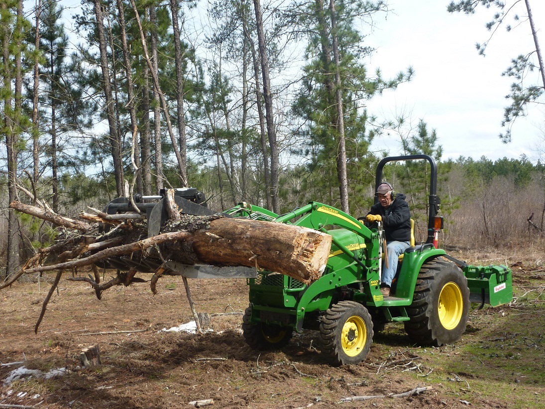

The important thing on all these small tractors and loaders is to keep the grapple weight down.....so you have some capacity left with your loader. The markham/gator/wildcat 48" grapples have worked well for so many of us. I have a markham/gator and have extra tines added between the teeth. Works good.
I operate my grapple of the 3rd function remotes and the SCV on the tractor. I have the JD hardlines kit that takes the couplers to the front....but hoses could work well too. I like it fine...and have no issues with operating via the SCV.
There are lots of threads on grapples. Use the search function for hours of reading. :thumbsup:
