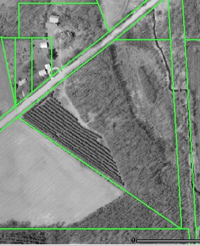

Didn't you get a map of a survey when you purchased? Every piece of property that I have dealt with had a survey that came with a map that was registered with the county. If the GPS is accurate to +- 3 meters, you could be off your mark by +10 feet at any given time. Not too good when digging for utilities. /forums/images/graemlins/shocked.gif
I've taken my survey maps and scanned them in to my PC. Then I can print them out whenever I want a copy, manipulate them in picture formats, save them as backgrounds to CAD programs, etc... From that point on, when I want to record the location of something, like the septic tank lids, I just measure from two unmovable points, like two corners of the house or garage, record the distances and copy them onto the maps.
Do like the Doc said and get a map from the county. Your place will be on it. /forums/images/graemlins/wink.gif
Our county even has them on-line. You can display a map of the county, select the option to show all parcels, zoom in on your parcel and see an aerial photo like the one I have attached. Then you can select another option and click on a parcel and it will tell you the legal description, measurements of all sides, who owns it, when it was last assessed for taxes, etc...

My land was nothing but timber when I bought it. I have three surveys on it so far and will probably end up with a few more by the time everything is said and done. The last survey in August cost me $9K and it just lined up some boundry changes and consolidated all my parcels into the right legal description for my project.
I have arial and topo maps. They are nice and have helped tremendously.
I'm cutting roads into my land, clearing pastures, pads and ponds. The place is changing on a monthly basis.
To keep up with everything, I'd like to be able to create a PLAT with all the information on it. Underground utilities will be labeled.
Exact positions arent as important on the map as it is to have a reference that says the cable is 3 feet down and 6 feet south of a certain fence post or street light. I can then color code each utilitie and know where it is.
Notes and sketches get confusing to me and in a few years I'll really wish I'd done this when I had the chance.
It seems the GPS will give me some reference points. The software is extra, and from what I understand, it's gonna be the real concern for what I want to do.
