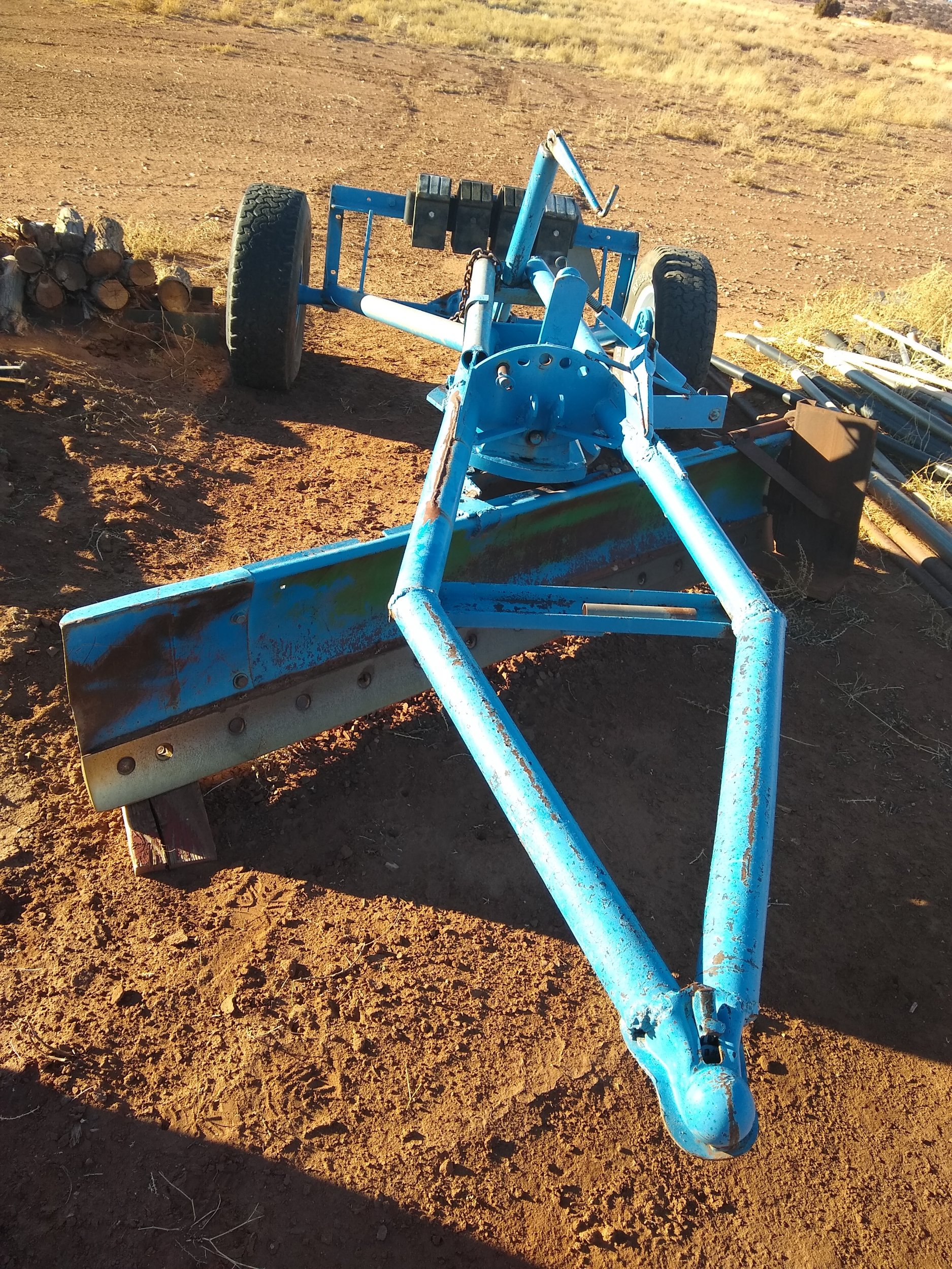

   / Grading--what am I doing to cause this? #110
Have a 12 foot long grader blade 8 foot wide home made tilts in every direction used a mobile home axle and 400 # of weight it solved my washboard problem. Good luck 😃
