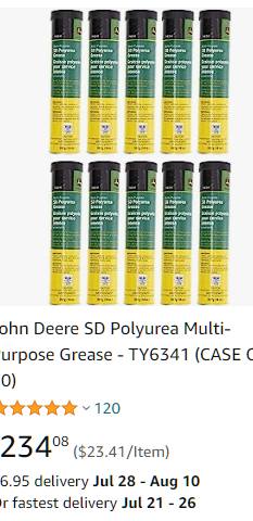

I looked on Amazon.ca, you don't want to buy it from Canada, not at this price for 10 tubes

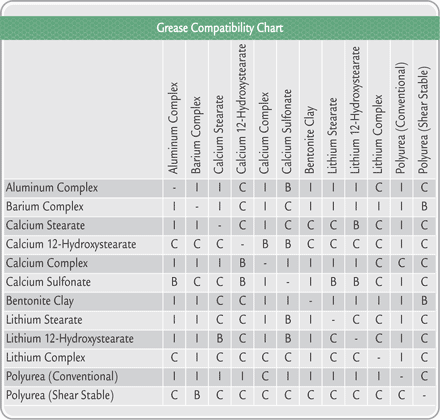

everyone should copy that chart
