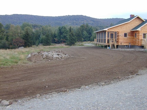

WOW! thanks for the pictures. I've been considering a Harley Rake for some time but you just convinced me!

When I was looking at the Harley I had phone conversations often with Glenmac corp. The HP listed are for tractor hp not pto hp. As Rat mentioned this is more of a gauge of tractor size than hp. There has been 2 times where I lost power during raking. It was wet material, material was compacted with grasses, the roller was 6" to 8" below ground, with endplates installed there was a huge amount of material being pulled. This only happen twice the first time by accident, the second time for fun /forums/images/graemlins/smile.gif. I have never seen a pro series other than in pictures but I would think the T series would require just a touch more hp than the pro series due to the carbide roller. In my posted pictures in this thread I never ran out of power, my rpms dropped a few hunderd rpms once or twice. As for residential work I would go with the T-6. You can get into much tighter spaces. The only reason I went with a T-8 is I needed to cover my tire tracks. As far as quality between the T-8 and T-6 exactly the same.

Thanks for the pics - they were perfect! Convinced my wife we should rent one of these in the spring. The going rate for rental here is $100 / day $300/ week. I'm thinking of getting it for a week and trying to set up some jobs to make some money back.
