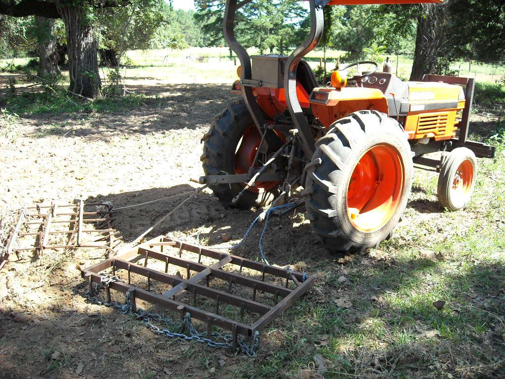

   / harrow drag #14
I made an offset spike/bolt/headbolt set. Got v1.0 on the left(using t-post frame) and v2.0 on the right(using 1x2" tubing). I had a bigger area so I tied them together. I usually pull v2.0 with the atv.
