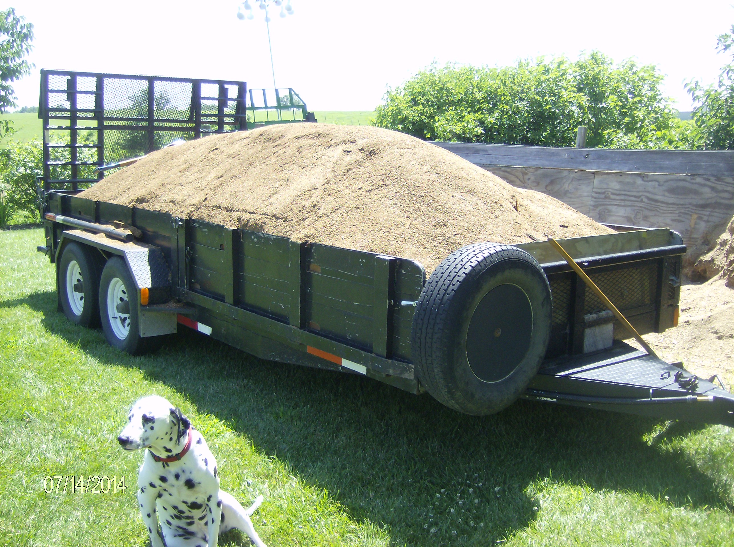

4570man - Are we both looking at the same trailer load of wood. Post #48 - single layer of wood in that trailer - - its going to weigh 7000 pounds?? This is a pic of my poor 'ol wood trailer - - 6'wide by 12'long with 5' high sides. If we stacked the green split pine tight and high - two cords.

Whew - OK - post #40 - that's more like it. Lordy - I was looking at that single layer and wondering 7K ??? My God - you would need a gantry crane just to pick each chunk out of the trailer. I just checked and a green chord of pine is going to weigh right around 4400 pounds - and we were able to get two chord in my old wood trailer. No wonder is pulled so hard. My poor little Ford 1710 had to work like a whipped mule to pull a loaded trailer half a mile. And we would get four loads every fall - we burned wood for twelve years here.

That should be nearly 3 cords. A cord is 4x4x8-128 cubic feet. The trailer is 360 cubic feet.
