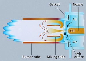

A few details - this boiler was mandated in Germany/Europe in the 90's to meet lower emissions, and it has a number of differences to the normal oil boiler. We have a GB125 BE - 87K BTU, three pass boiler with outdoor temp offset control same that is on many newer oil furnaces.
- High Pressure Fuel Pump - 265 PSI
- Heater in fuel line preheats oil before nozzle
- .45 GPH Nozzle atomizes fuel very fine particles
- Air recirculation in burner and outside air intake
The result is a blue flame, virtually no soot buildup, and I clean it spring and fall with a wire brush and vacuum it out. We have 10,500 hours on the boiler now almost 12 years old.
