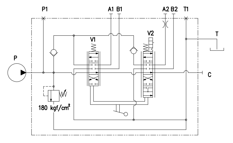

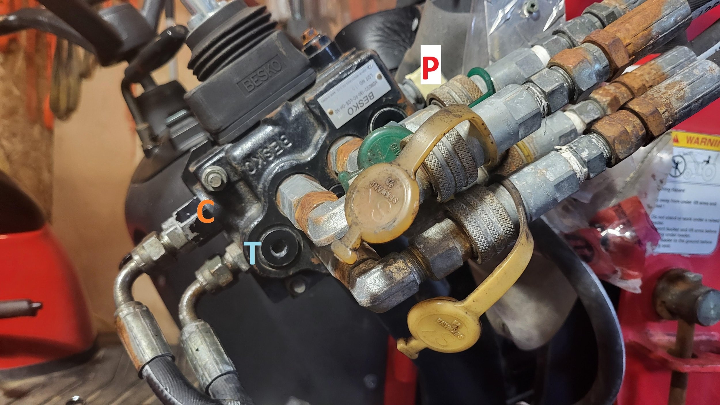

I believe this is the loader valve diagram. Flow from pump passes through to C port when the loader valve is in the neutral position or in float position. Flow to C is blocked in all other positions. T port is the return to tank port.
I cracked the hose fitting for port C and confirmed in neutral and float positions oil flows from port C. When operating the loader controls oil flows from port T. Working as it should.

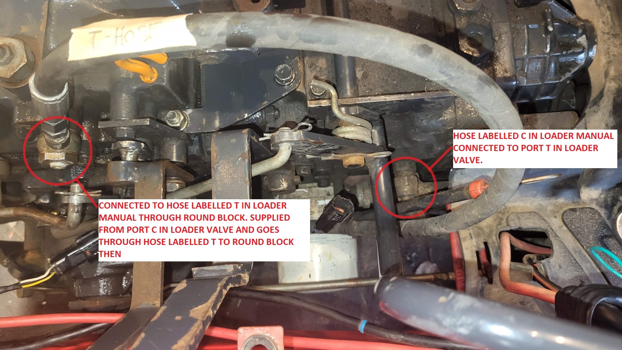

Connected as it is now my loader functions at idle and my 3ph begins to move at around 1600RPM. At idle it does not move. If I reverse my C and T lines the 3ph only raises when I lower my loader arms which makes sense as the T port is the return to tank port but it does this at idle speeds. I think I have a flow problem through my loader valve through the C port circuit.

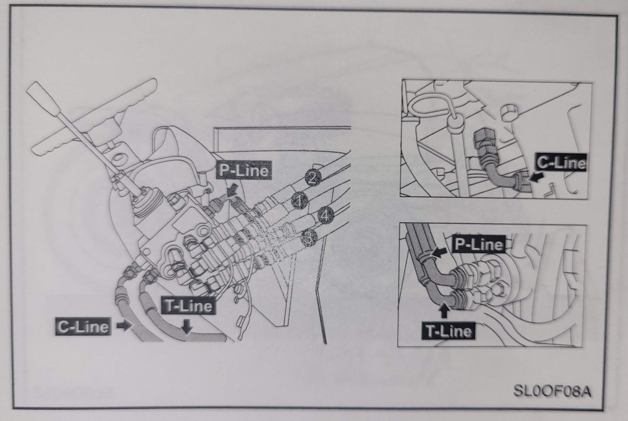

For some reason my manual says to connect the C-Line to tank drain and the T-Line to the 3PH position valve.
   / Hello from a new Branson 2400h owner. #34
The manual is wrong.
C is power beyond or pressure carry over and should connect back to that round block. T must go directly back to tank or you risk damage to the loader valve since on most loader valves T port is only rated for low pressure like 400 PSI or less. C is good for full system pressure.

I wonder if my loader valve has a faulty C circuit. The hydraulic pump has enough flow at idle to move the loader well. When I had the C and T lines reversed the flow coming from the loader cylinder when dropping was enough to raise the 3ph at idle.
