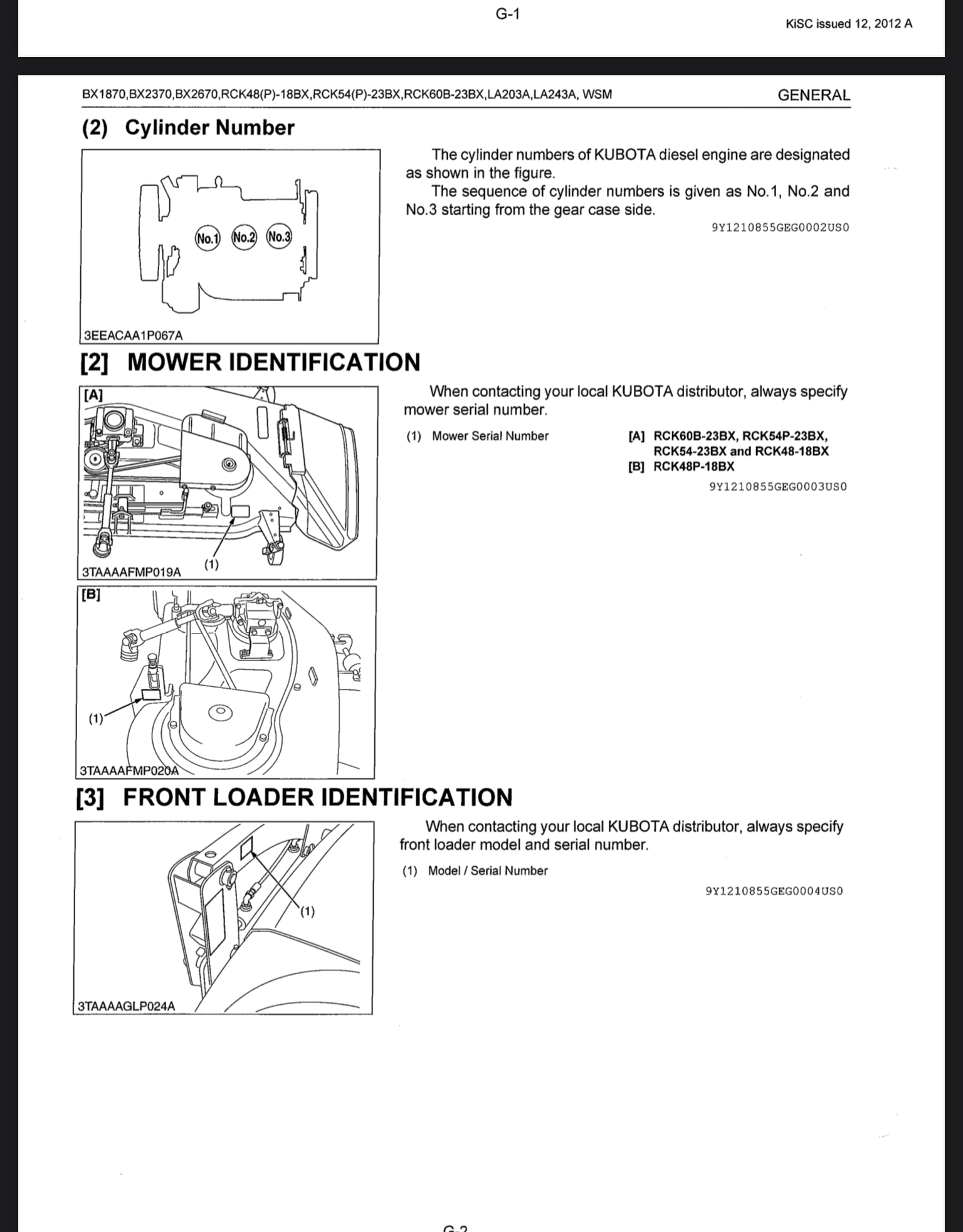

I'm wanting to do the valve clearance check and need confirmation on which is the #1 cylinder.
I have the WSM (page attached) that states the #1 cylinder is nearest the gear case. Are they referring to the fan/water pump end of the engine as being the gear case? The BX has the engine installed with the fan end facing rearwards and the flywheel facing forward towards the front bumper.
Thank you!!
  • BX2350 Valve Clearance.pdf
   / Help identifying #1 cylinder on BX2350 #2
@fish6942
Check the General Section, first few pages, for a picture of the cylinder number ID.
A different BX series (1870,2370,2670) seems to say the same as your manual, but the picture looks like #1 is closest to the fan.
   / Help identifying #1 cylinder on BX2350 #3
Yes, the engine is mounted backwards. The #1 is where the fan is.

Thanks guys! I don’t believe my WSM has that nice cylinder layout diagram, that would have been helpful.
