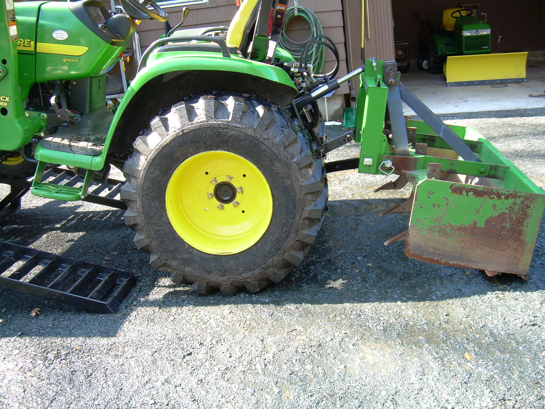

Get the 18-26 for sure that's as close as you can get to the range you have now, with the smaller one you would barely get it to go back as far as just vertical.
I wish mine went further out but it does go past vertical a couple of inches and from what I've heard most work is done angling implement forward.
It sure make using QH even faster, picking up rear implements, lineing all 3 points up with ease and tipping them forward to be able to reach the release handles even easier without stretching.
Also found an added benefit that's almost a necessary, when climbing the ramps on my new equipment trailer, even with 3 pt all the way up the cutting edge of my box blade dug in, no problem now, just tilt it forward to provide plenty of clearance.
That was just a short BB, imagine a long rake or mower, you'd be all day cranking that top link in to gain the needed clearance.
JB.
