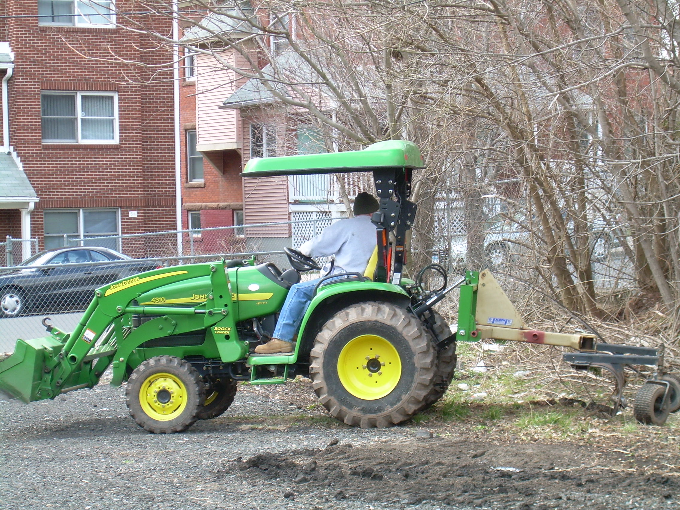

Well got a chance to put the HTL to the test, using box-blade to dig out a site for a stone patio.
Works great with the box, being able to dig aggressively then level off quickly makes the box some much better/easier/more efficient/etc.
Now I'm thinking HSL,
Anyway the HTL is so handy as just a compliment to the quick hitches, makes it so easy to tilt forward and unlatch the locks from the seat without stretching or getting up. Makes swapping implements that much easier :)
Couple of pics with the rake also.
