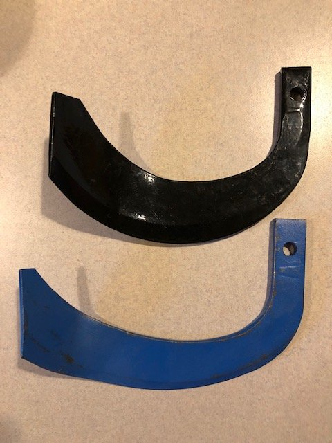

From the picture I think I have the same tiller with a different name and it's red. Mine came as a package deal in 07 with my Jinma crate tractor from John's Tractor which is now closed. I would appreciate letting us know if you find them as I need a set also. Thanks.
Ended up ordering a set of tines from these guys. https://www.agproductsllc.com/
They are a little bit longer and taller but fit and seem like they are going to work just fine.
   / Help with 3pt tiller tines
#23
This was the email from them,
"If you have a 10 mm bolt that holds the blade into the blade bracket.
The picture I attached shows the two blades that should work. The black
HWG has a tighter curve and is 3/4 inch shorter when rotating which
misses certain Yanmar models of tiller on the frame. They are $9.00
each. If you need the bolt assembly they are $1.00 each. Shipping will
be $23.00 Please call Kathleen at 1-660-874-4455 and let her know which
blade you want and if you need bolts. She does all the paperwork."
