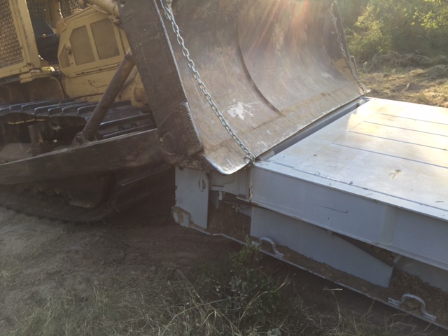

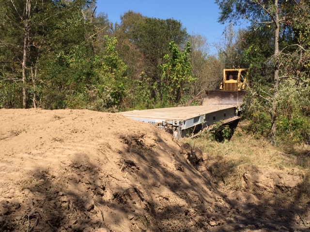

Well I know this is an old post but..........I did it! Got the bridge across the creek. Ha. The water was low which helped. After all the figure and worrying, I decided to put the blade of my dozer on top of one end and push down. I chained the end of the bridge to the blade so that when the dozer moved, it pushed the bridge out over the water. Worked like a champ until the end, when the weight of the bridge pushed me and the dozer up in the air. A little pucker factor! I kept pushing it and it walked up the other side of the creek a little bit. Unchained it. Built a dirt ramp then drove the dozer across to the other side. Very nerved racking, it's about 15 ft fall into the water. Got the other side and chained up the end and used dozer to lift that end up onto the bank. Build another dirt ramp and drove dozer back across. Very entertaining......
